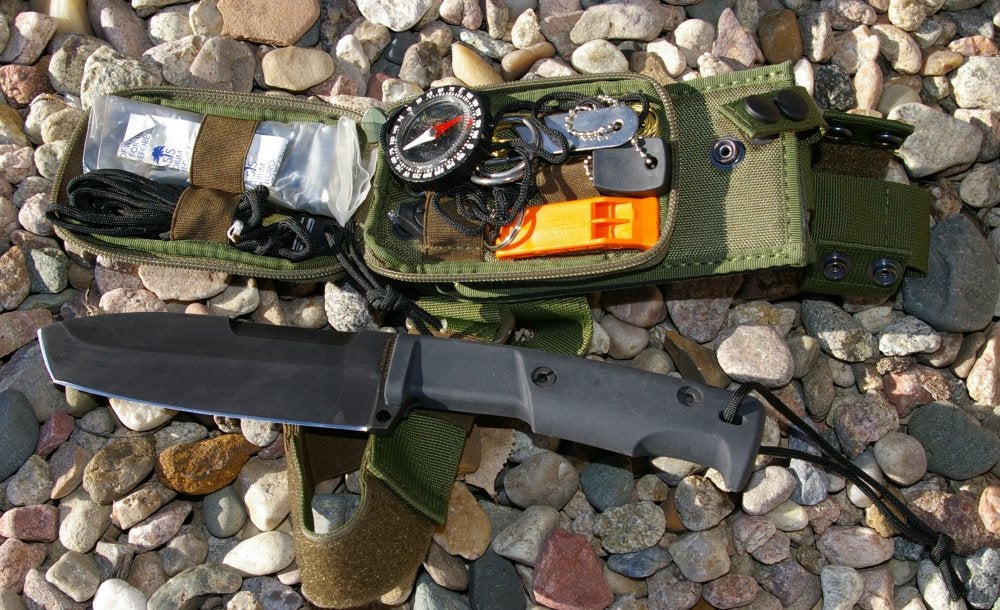

I'm really looking to get the ER Selvans with the kit. I've seen one very good, in depth, & positive review on alloutdoor.com, by one Major Pandemic.
Does anyone have more info on this version, which is targeted as wilderness survival, as opposed to the Ontos, which is built for urban survival?
Here's a great picture of the knife and the kit it comes with from the afore-mentioned review:
I don't know what "urban survival" means, unless it has to do with prying open doors, but the Selvan looks to me as a much better designed knife, with an emphasis on chopping and a thinner edge geometry, with a much higher secondary grind line. However, that grind should be hollow for deeper bites into wood... I've pitted a 9.5"/17 ounces San mai III Trailmaster against a 7.4"/12 ounces Randall Model 18, and the Model 18 almost matches it in chopping performance, just because of its hollow grind and thinner edge... A similar medium size Al Mar "Special Warfare" fuly matches the Trailmaster, despite being much smaller... Any serious survival knife should be hollow ground for better slicing AND chopping performance with less effort... That being said, any thin edged profile can perform well, as long as it is not convexed, or the efficiency will be what you see below of a brand-new Trailmaster at 18-20 strikes...:
Gaston
Ah, thanks for the info Gaston. I'm just getting interested in bushcraft/outdoor/survival stuff. I want to find out more about the value of this knife before unloading $400+ for it, haha. And yeah, urban survival was a bad wording, I should have said urban SERE tool
