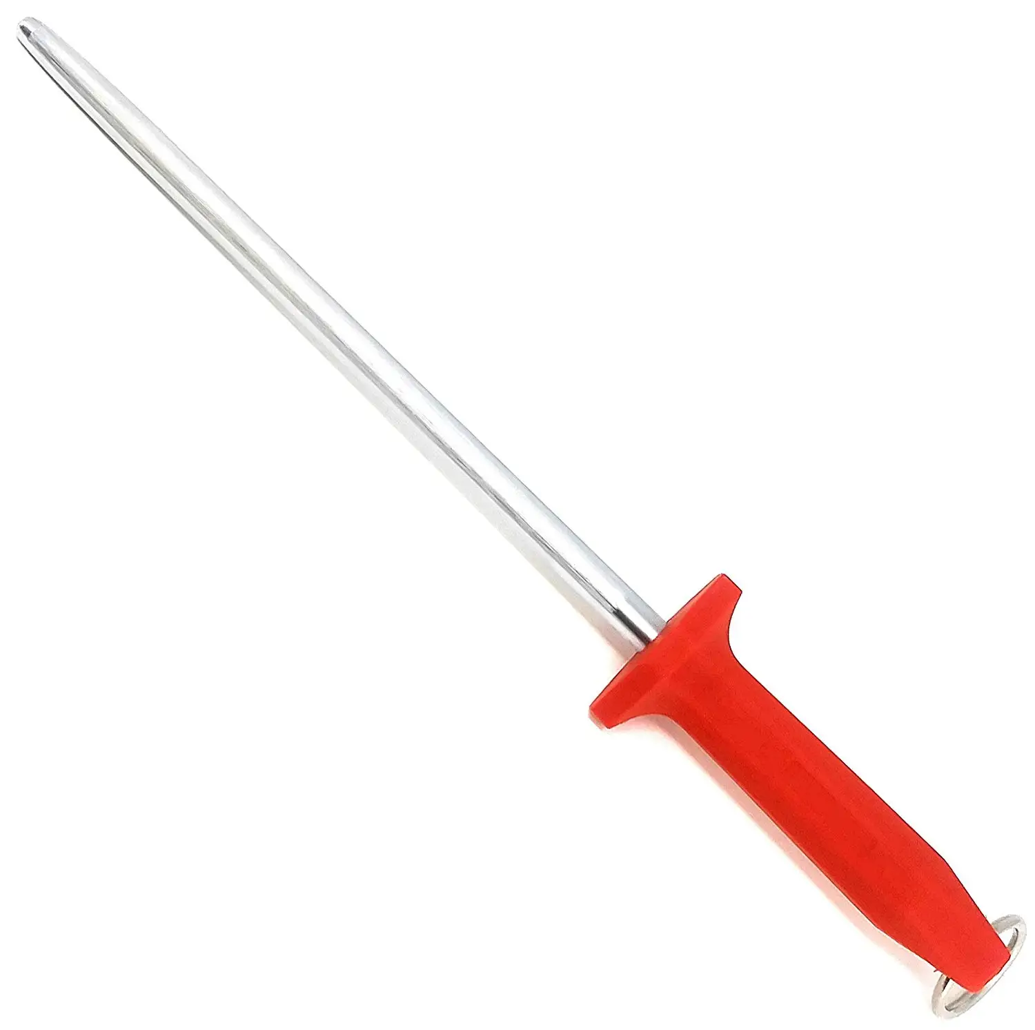

Probably the best by far modern made F. Dick steel is this one... Orange handled 10" polished and unchromed. A lot of people use these because they are NOT plated. These will last forever if cared for, after use, cleaned and wiped with WD40 or INOX but the disadvantage of them is you need to cut lines in them almost every second day as they're not as hard as the older ones. I have a few of these in the kitchen utensils drawer, one in the fishing tackle box and a few in the shed. The only modern F.Dick worth buying in my honest opinion.
Will pick these up anywhere from around $30 - $60.
"The F Dick Non-Chromium polishing steel is also called a butchers steel. It is stainless and perfect for softer steel butchering knife lines like Victorinox and Dexter. The reason that it is not chromed is in meat packing plants, many cutters like to scuff this smooth steel with sandpaper to suit their individual preferences."
Being non plated it won't fail and become completely useless after 3 months however if dropped or accidentally banged against a table or wash bay, it'll need to have new lines put in it almost immediately but a very popular little steel and one worth having if newer steels are your thing. Bullet roof bit of gear. The standard high vis orangle handles can be removed too and fitted with custom ones.
