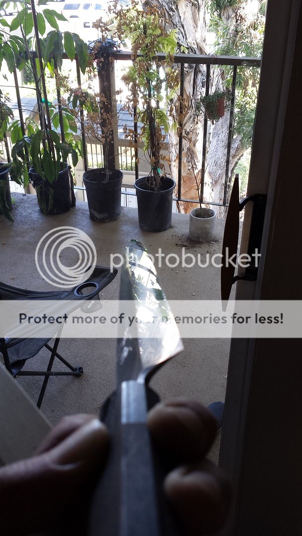

Here's my Timberline Emerson-Neely Specwar. I love the way it looks and feels I just can't decide on how I feel about the grind.
