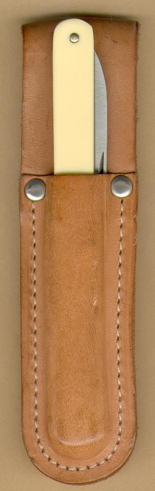

Here is a Schrade melon tester with a sheath, that fits very nicely. I've never seen this sheath before, and wonder if it came from Schrade this way, or if the sheath is after-market.
The tang stamp is SCHRADE+ (over) U.S.A. 105.
Anyone know?

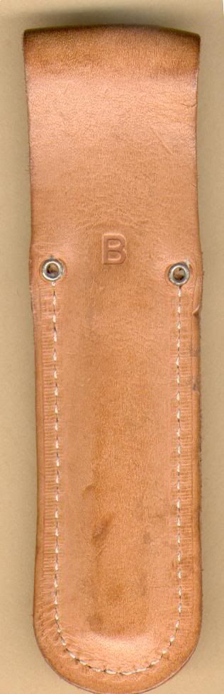

Here they are. Does anyone know if this is factory issue?? Or after-market??
My opinon only. The sheath was commercially manufactured. The reverse side of the sheath tells more than the front. The rivet style (semi splash) and stitching (thread size and spacing) are both indicitive of production line type construction, Also there was no effort to finish the edges, nor is there any finish applied to the entire sheath. All these factors point to least expensive and fastest production possible. The pattern is simple two piece with the loop folded back to the front and secured by the side stitching, much like the Schrade 152 sheath construction.
My specualtion: It probably did come with or was made available at extra cost at the time the knife was purchased. The fact that the ebay post showing the identical sheath construction on the German knife leads me to this conclusion.
The "B" marking on the back of the sheath is probably the sheath manufacturer's stock number designation. Size B or Model B etc.

Thanks Paul,
Your opinion makes a lot of sense. It looks commercially made to me too.
Dale
Thanks sheathmaker! Pointing out the details brings clarity to the unschooled!
Schrade sheaths are a story I am yet to untangle. Actually, the term "aftermarket sheath" itself can be misleading. Schrade over the years made very few of their own sheaths. Yes, it was shown during the auction that they did have their own sheath department, and I have been told that they did do some of their short run fancier sheaths inhouse, particularly in the last...fifteen years or so? An educated guess is that some regular "production sheaths" were most often customized there with decorative logos, stamps, and maybe dyes, and perhaps some sample designs were put together there. For the most part, the department did not have the capacity, nor was it equipped and staffed to do production work, such as 60,000 sheaths for the 152OT/UH/SC/DU/DS. Outside vendors provided most of the sheaths over the years, sometimes more than one vendor per pattern at a time, and some of them added their own minor detail differences according to their own manufacturing methods, material availabilities, and capabilities. In this sense, almost all of Schrade's sheaths were produced by outside sources and were OEM and, at the same time aftermarket. Naturally these same vendors sold similar or even same sheaths to other buyers. And quite a few of Schrade's customers provided their own sheaths from whatever source. Knives were shipped to them in bulk for them to sheath and put in their own packaging.
There are, so far, few solid leads in tracking down many of the sheath suppliers Schrade used. That will prove to be an epic adventure in and of itself. I have a sneaky suspicion that one rabbit trail will lead to Mexico and even possibly South America. And Kansas. Any leads anyone runs across would be deeply appreciated.
I think Paul is spot-on with his observations too. It was a manufactured sheath, not a hand made custom one. His particular expertise and eye for details is a most valuable addition here. Thank you Paul.
