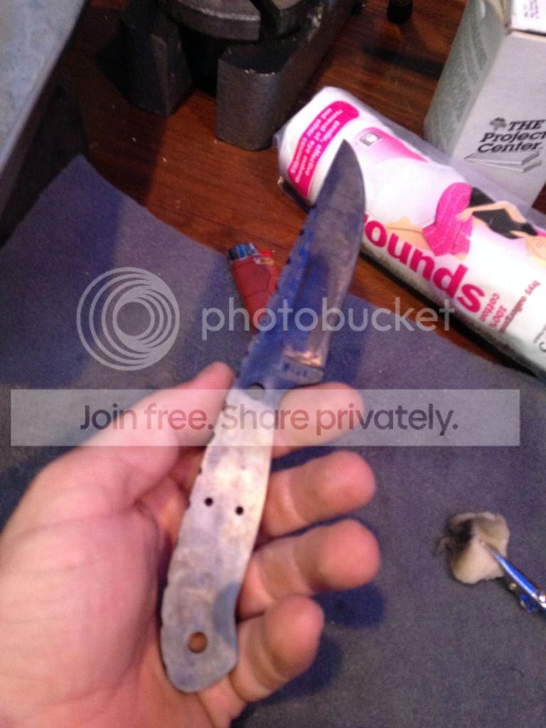

So I gave it a shot this weekend and had TERRIBLE results on a 1084 blade. I followed this this thread for directions. Any ideas why it might have failed? I used Heinz apple cider vinegar which was said to give a better darker color as you can see I didn't get that. The image was after 2 hours of vinegar application. It wouldn't even seem to color the handle area at all where it's not hardened.
did you shake the vinegar and then heat it before soaking the blade? Did you make sure the blade was totally oil free before soaking?
Yes, yes and yes. Cleaned with acetone and heated to boil and left warmer heat on at just below boil. Thermo said 200* + -..

Your dark areas are where the heat treat and quench transformed the steel. The tang is lighter because that part of the steel didn't transform.
One reason may be you said you cleaned with acetone then treated. try scubbing with dawn dish washing liquid and hot water after that. Towel dry the blade while its still hot and you won't have water spots. Then don't touch the blade with your fingers untill you're done. also a finer finish will give better results.

Could possibly be decarb as well, if you haven't cleaned up all the decarb it'll look like that.
The difference between the spine and the rest of the blade makes me question how you ground the bevel . Did you use an old worn out belt ? If so you might have smeared the steel in the bevel but not the spine .The smeared steel will certainly react differently to the etch. I learned that a long time ago - smearing a fully hardened high carbon, high tungsten tool steel !!
It still looks rough ground to me. Try hand sanding to 400 and then try the forced patina. I have better luck with Apple Cider Vinegar heated up on the grill if you're not going to use FC.
transformed the steel meaning it didn't harden properly in the lighter area?
It's not hardened like the edge and blade are. He probably used a 2 brick forge and got the blade and edge up to proper heat but not the tang where it was probably held with tongs or pliers.
Kind of like edge quenching a blade, there's a distinct line between the hardened steel and the softer spine.
