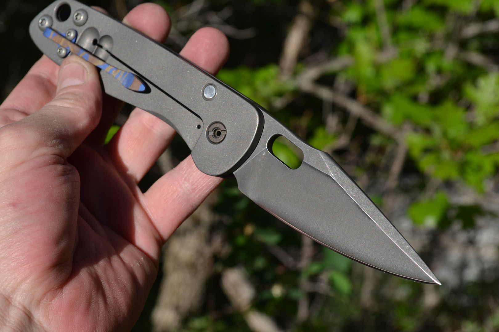

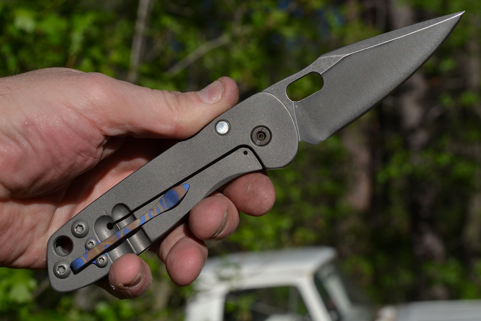

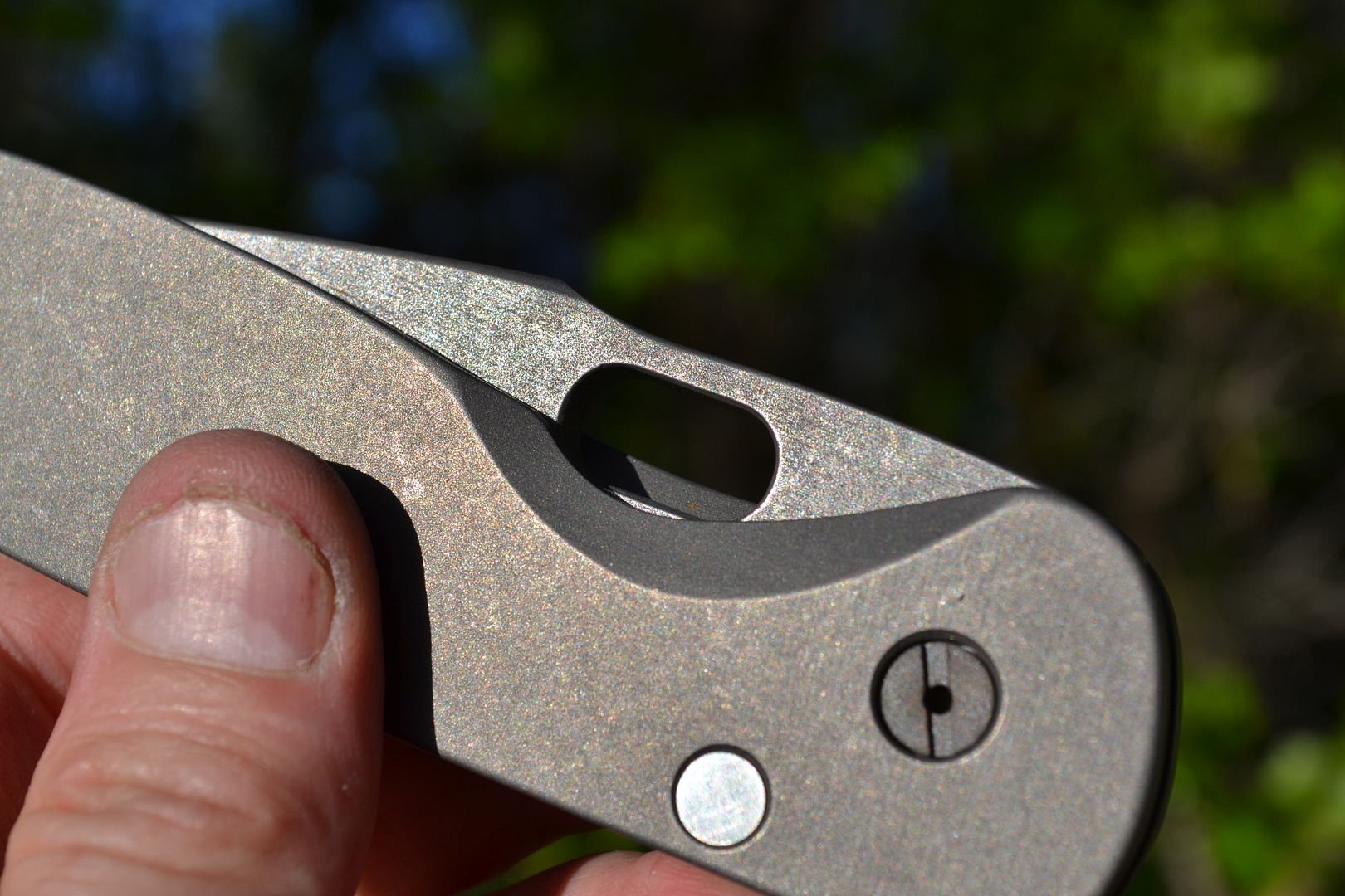

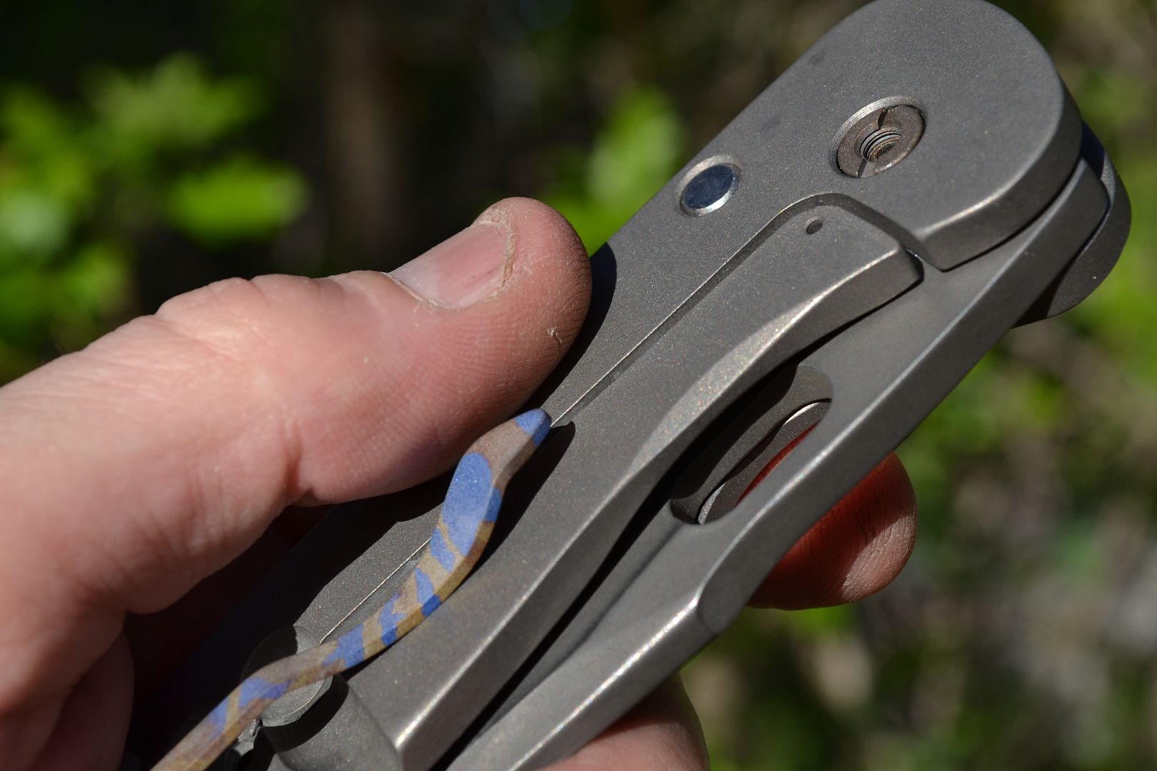

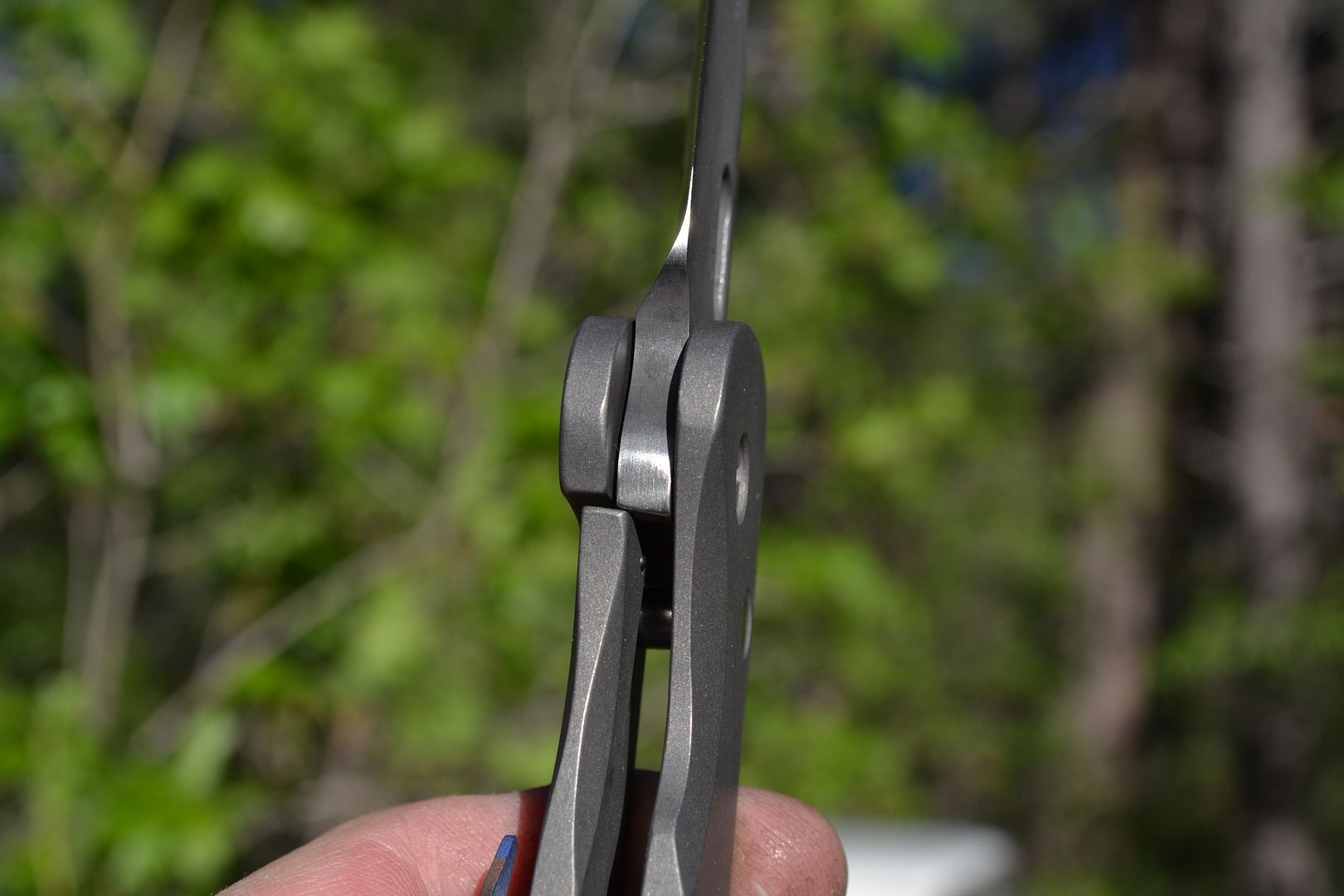

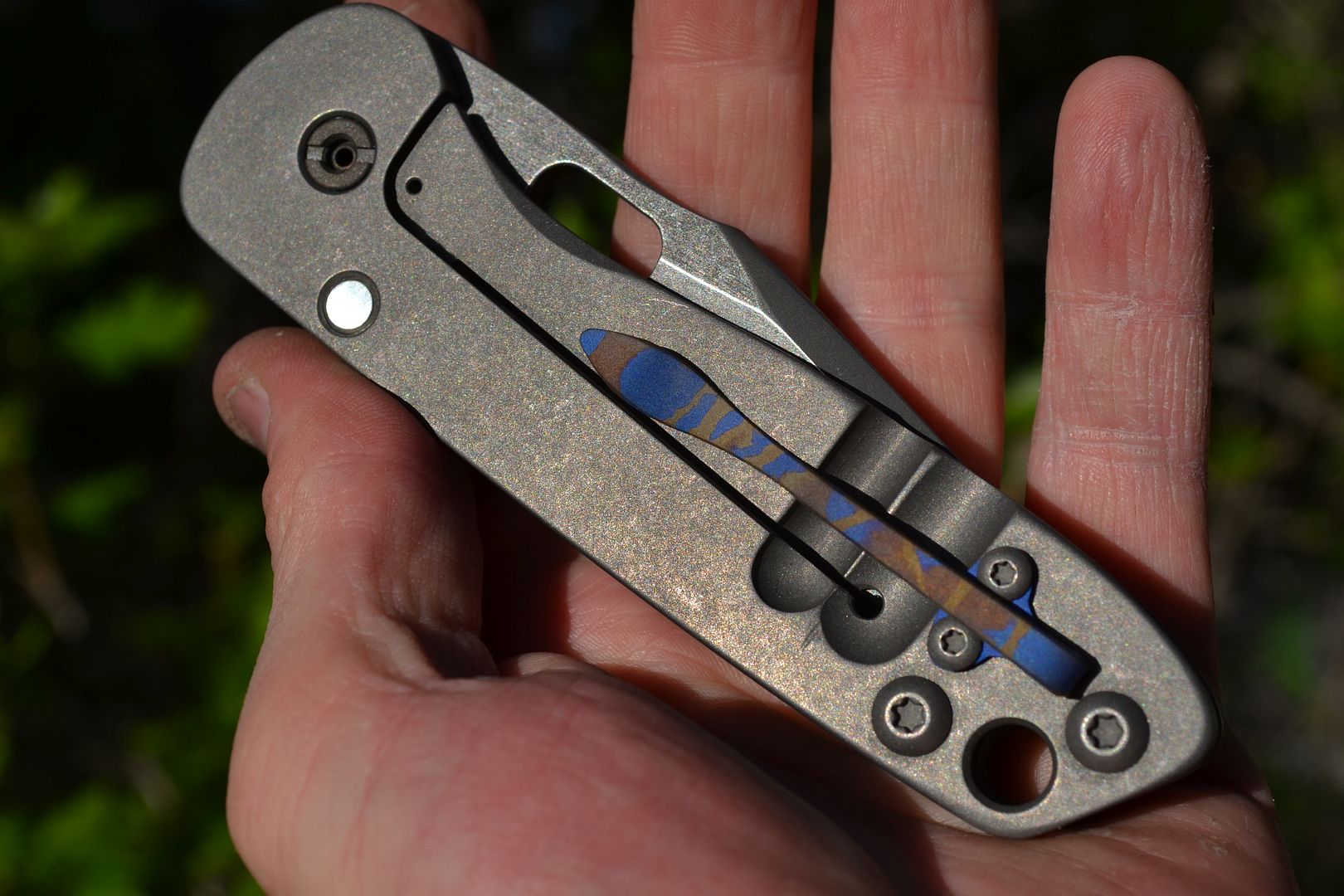

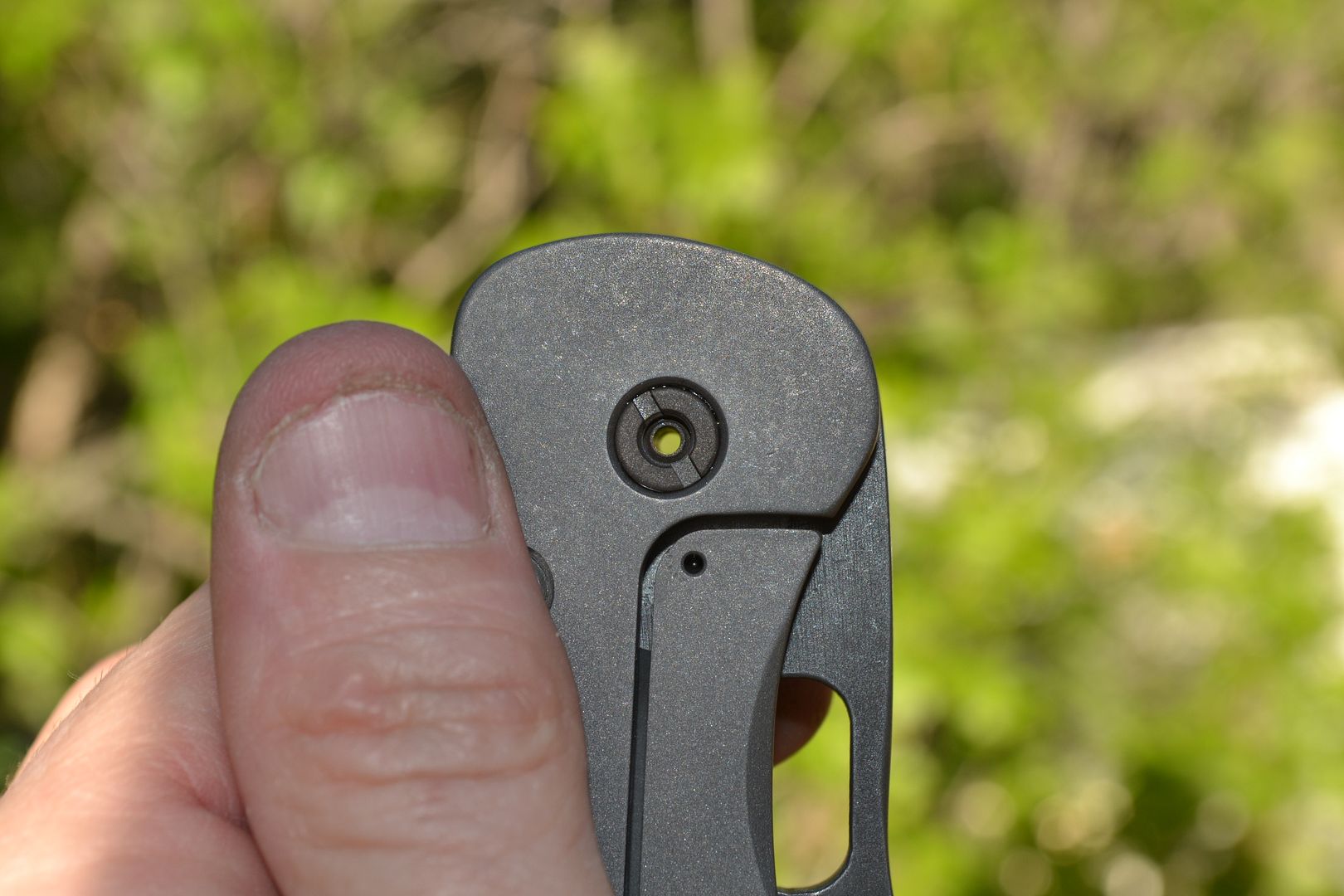

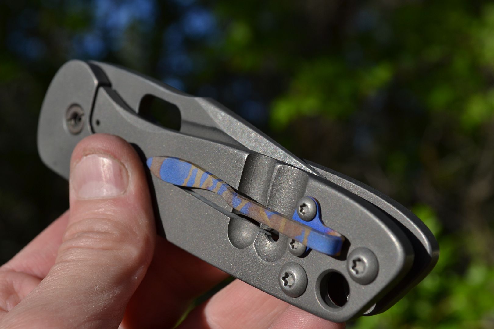

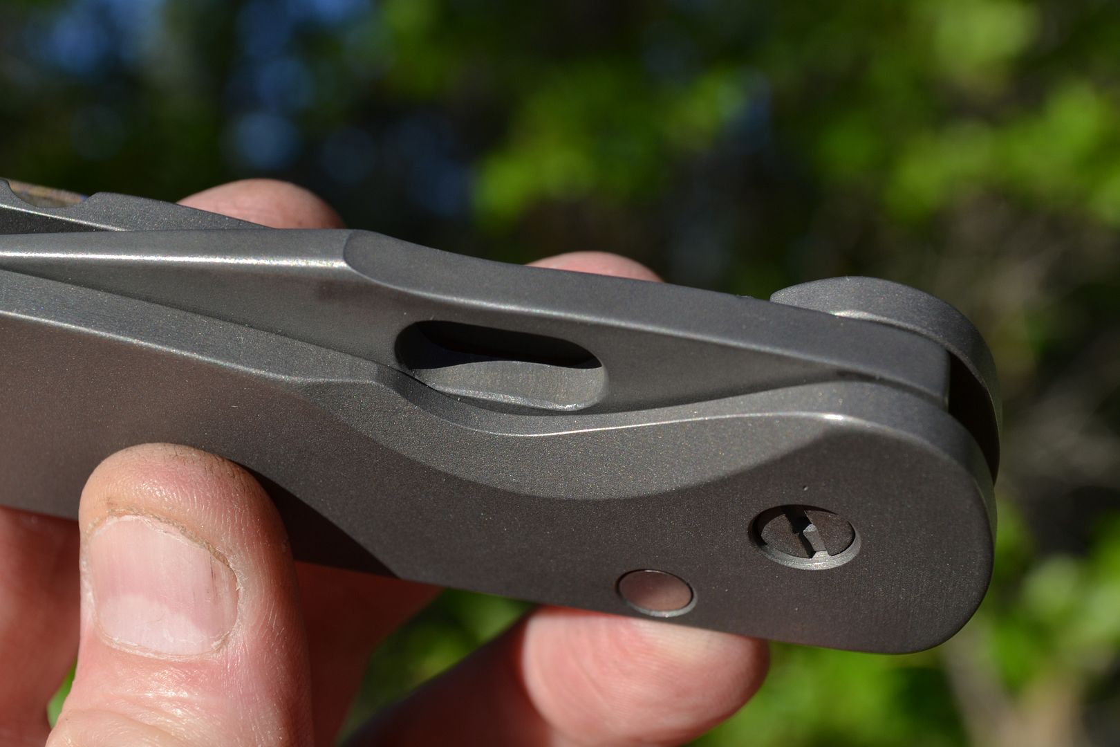

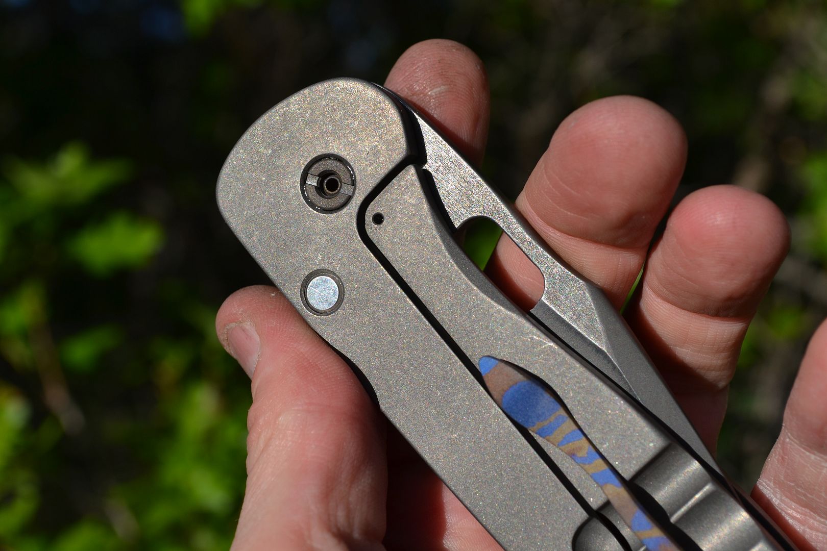

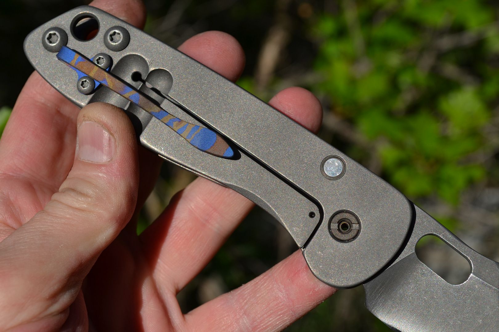

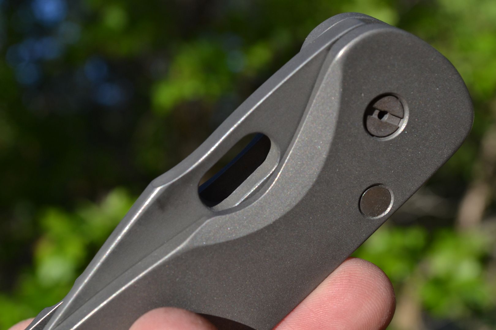

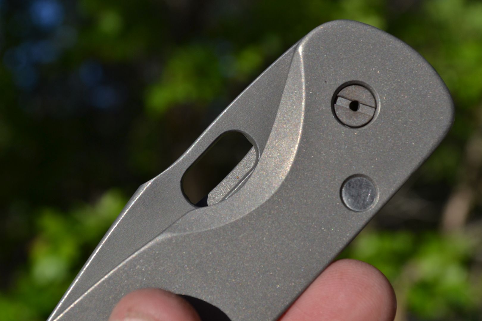

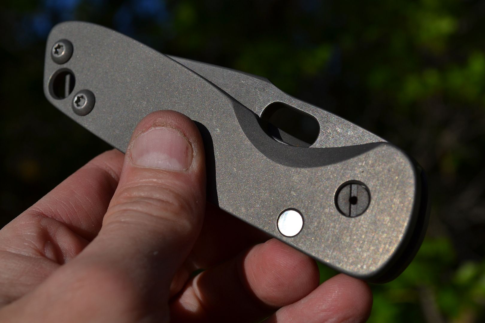

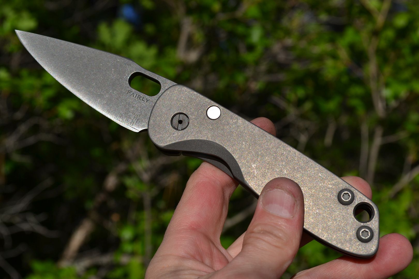

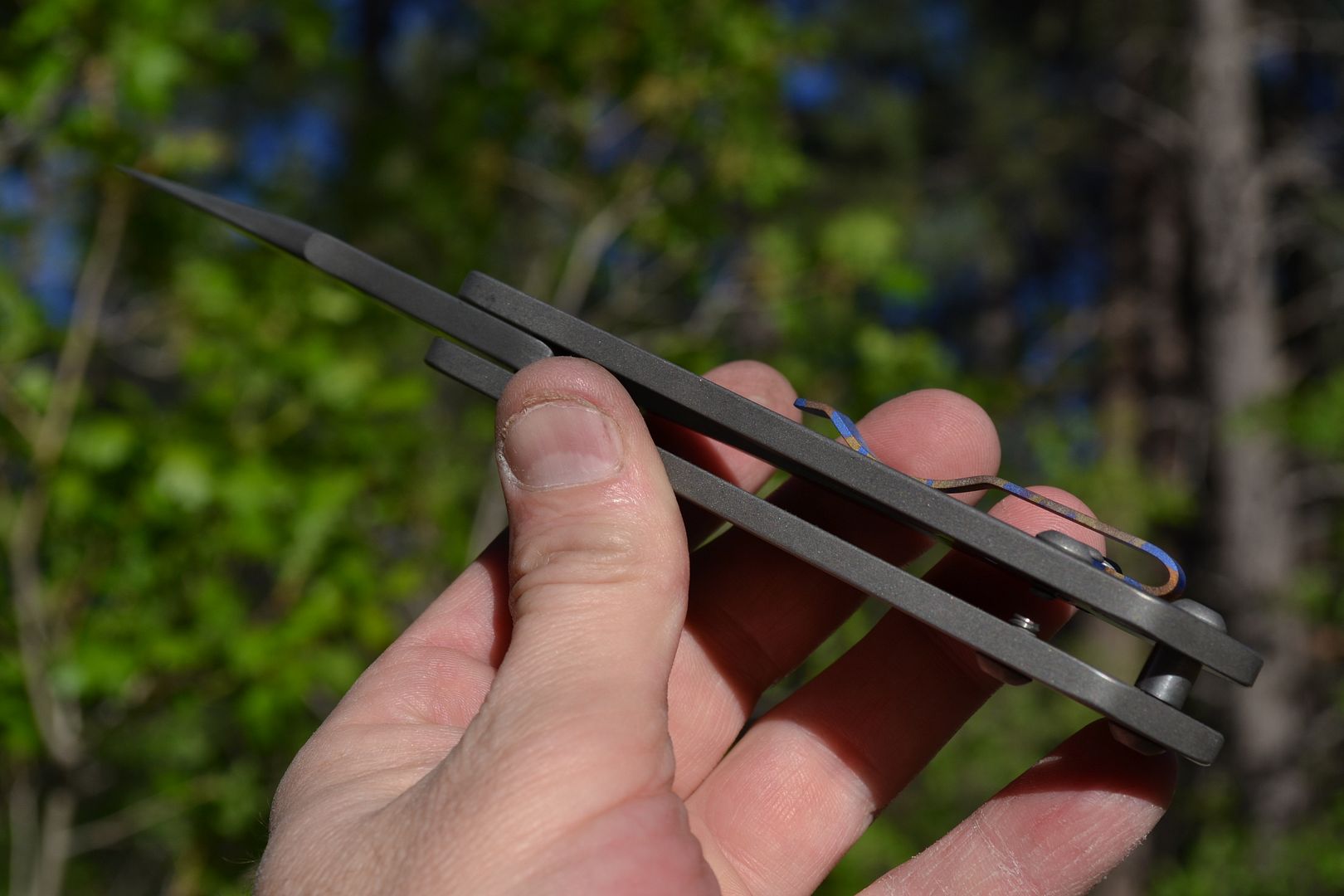

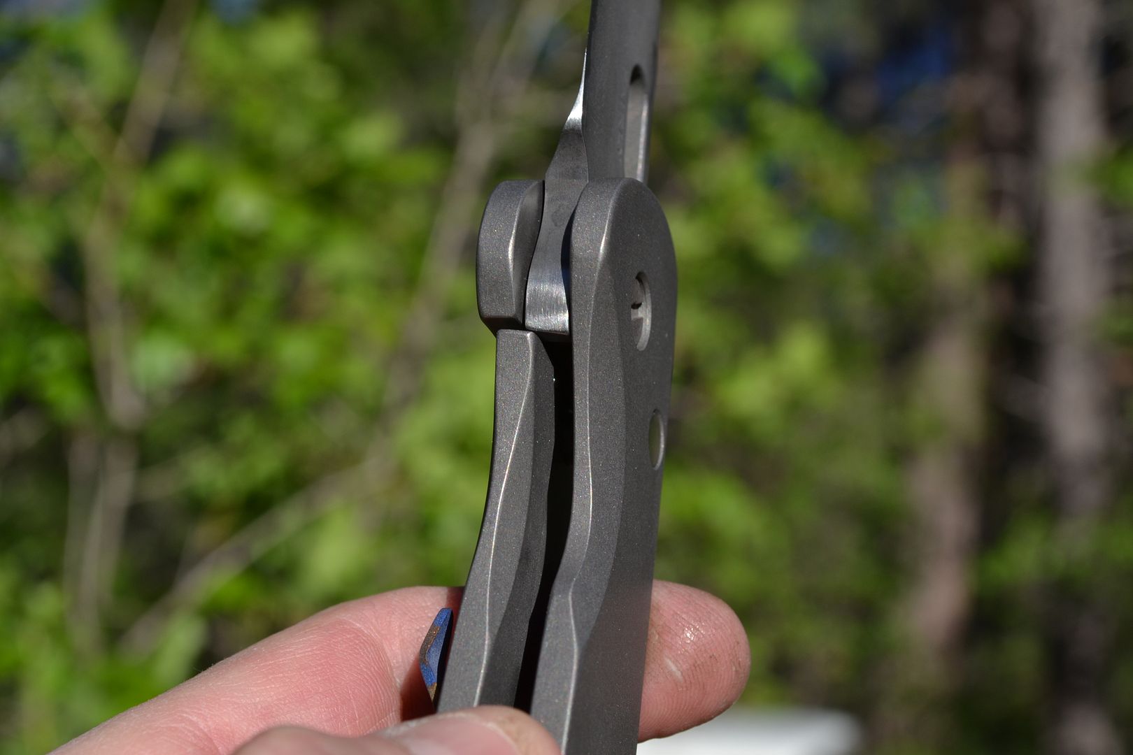

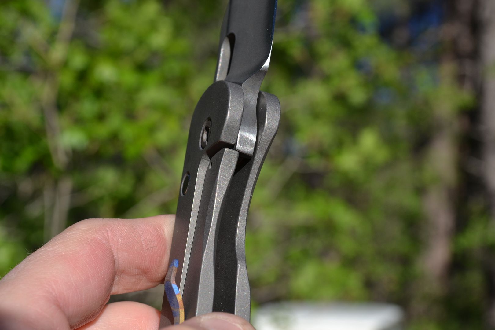

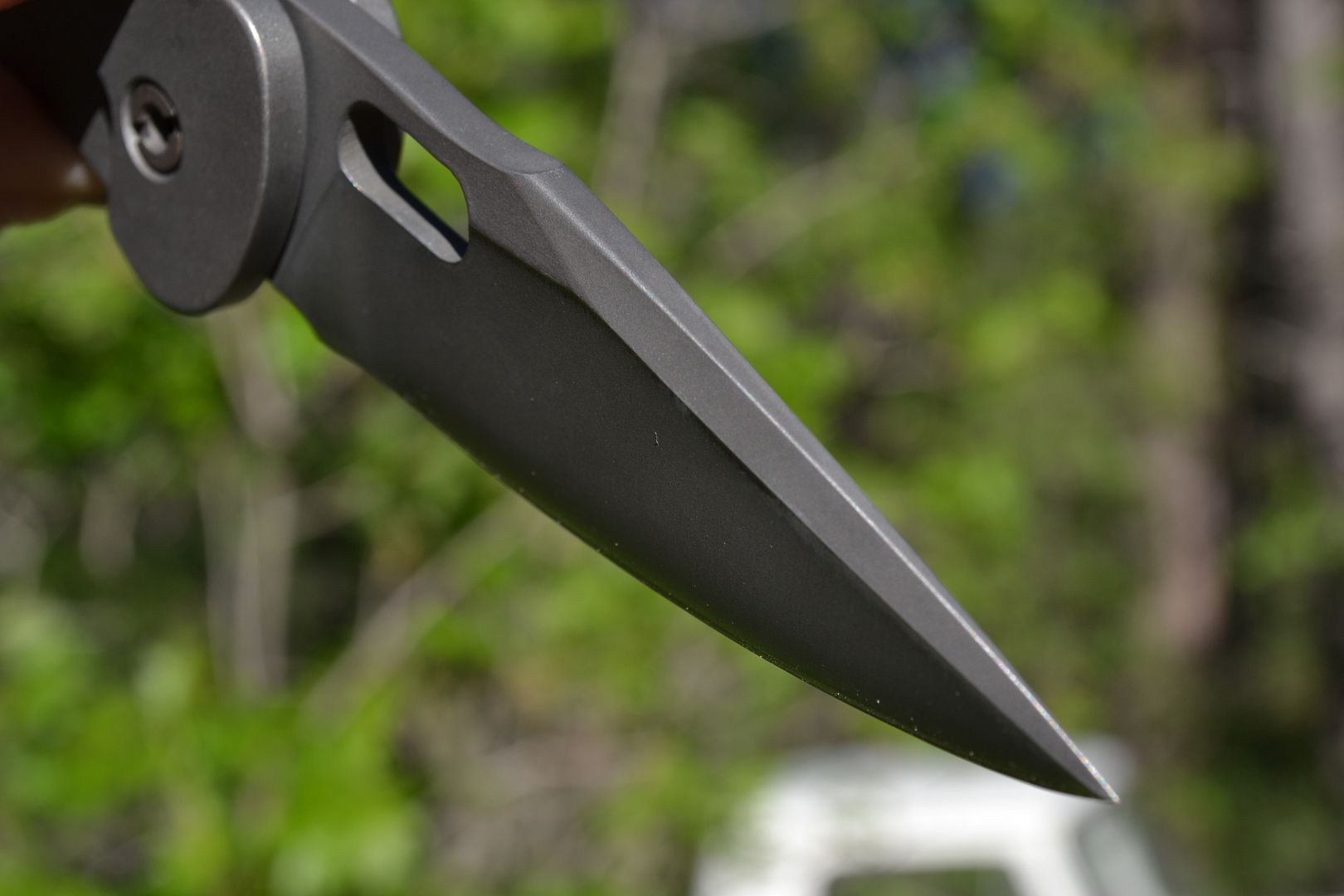

Framelock #1 - I just finished up my first framelock, check it out!
Size - 8.48" total length, 3.48" blade from tip to choil, 4.95" closed
Materials/Specs - .207" CPMD2 blade, .190" 6al4v Ti frames, phosphor bronze washers, 1/4" pivot, 1/4" hardened stop pin, 1/4" standoff's.
Finish - stonewashed frames, acid washed blade, blue and two-tone bronze anodized USAKM clip, heat colored pivot
Misc. - flat chisel grind with thin edge at .008" before sharpening, half-stop, 59-60 RC hardness, in-house heat treat, carbidized lock bar
This was my second attempt and I'm really excited to say that it works very well! I'm missing a standoff in the pics but that problem has been solved. My biggest mistake was using an etching stencil that somehow had been marred and because of that I etched some scratches into the blade below my signature. That's fine with me, I'm very excited to say the lockup and detent are spot on.
I'm waiting on the right screws, the scales are countersunk behind the current ones and the screws will be recessed. I'm counterboring and using button head screws on later ones.
One big goal was to use the biggest hardware possible and still have the lock geometry set up ideally. I wanted to do this in a size that could still easily be pocket carried. It took me a while to get everything right but I'm really happy now that it is done and working very well! It's smooth too, I'll do a video later, this one will be kept for more testing! :D

That is perfect! I love the clip; just enough color to add character, and still remain tactical.
really, really not keen on asymmetrical bevel grinds, but I understand that some people like them so whatever.
Otherwise, to my eye, this is a great looking knife. Very sleek but burly too.
Thank you! I'll probably move to a wider clip but will be doing all sorts of anodizing.
Nice work
Thanks Lorien! I really appreciate your input, it means a lot!

How fast can you get one of those to me? :) Great looking framelock - once the screws are sunk, this will be hard to beat for sure!

That is great. Lock geometry looks properly designed. :)
I'd like to see some wider, more interesting stand-offs though.
You are making it look easy. Great design.
Thanks! I am very happy with the design... took me forever to get the lock contact area almost under the pivot and as far away as possible. Now that it is I can rest soundly!!
I'm looking into standoffs too, thanks for the input!

I love that look. The dull gray definitely appeals to me

Are you suuuuuuuure I can fit 550 cord through that lanyard hole?:D
Only a few strands... :D
Dig the grind, profile, clip, everything. Nice! :thumbup::thumbup:
Much appreciated!
