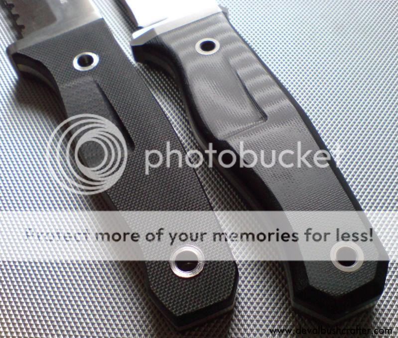

The fake (right) also has basic aluminium tubes holding on the slabs. The Bayley knife has tubular (4mm hole) loveless type handle bolts the thread end can be clearly seen.
As you can see from the close ups of the G10 slabs, the fake is flat without any form or ergonomics in mind, while the Bayley is hand finished and shaped to fit the users hand for extended periods without causing blisters. use teh fake for more than a minute and you really know about it!!
The edges on the Bayley are also shaped and ergonomic, while the fake is left unfinished and square, although a half hearted attempt and putting an angle on the edge of the slabs has occurred in some areas, but they must get bored easy as it is not consistent or even regular.

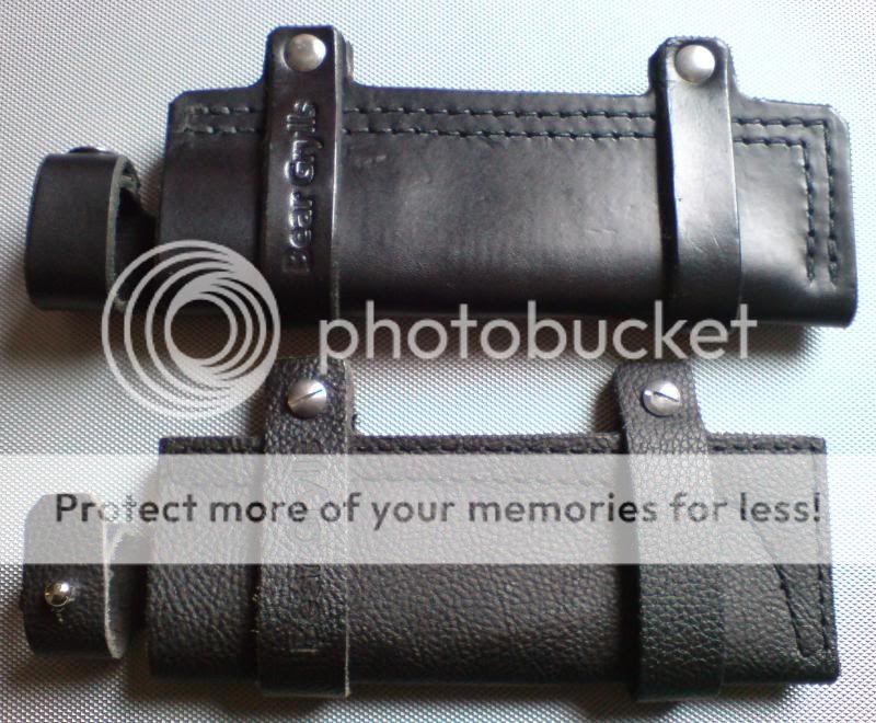

Now the sheath. Where do you start here?
The fake is made from awful, very thin leather and the knife point actually pokes through at the bottom after sheathing it a few times due to the multi layered and thin leather stacking. The Bear Grylls printing is crude and it is just the cheapest thing you can imagine. This Bayley one next to it is four years old and in better condition, made from thick saddle leather and finished as you'd expect from a custom knife maker.
