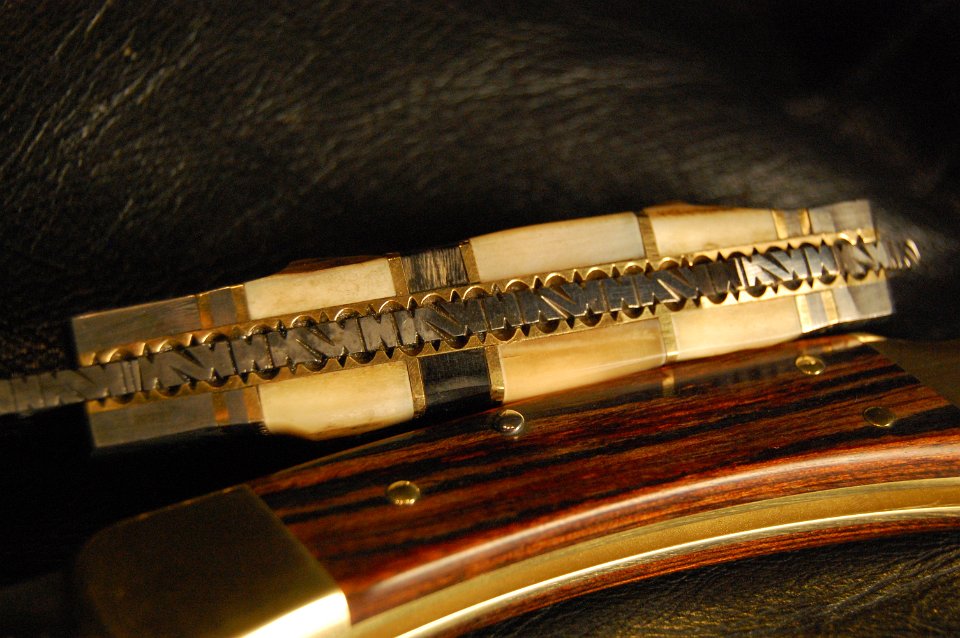

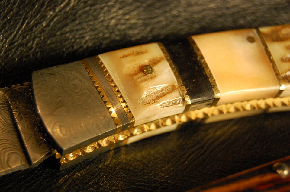

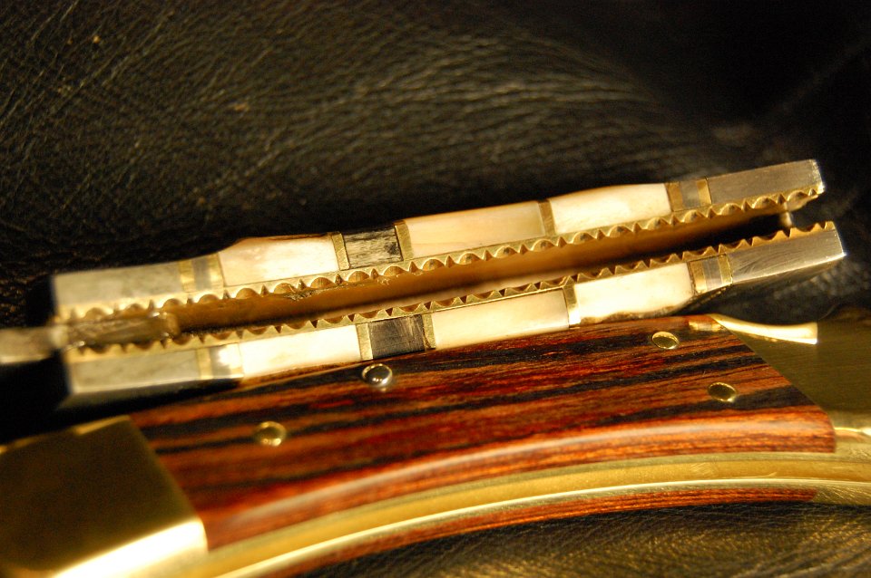

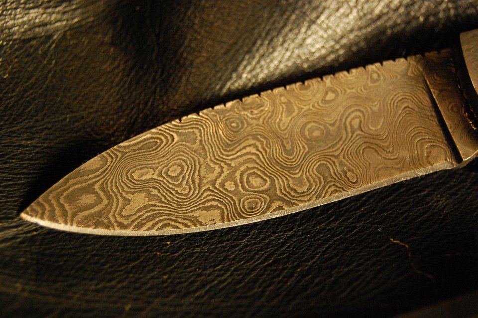

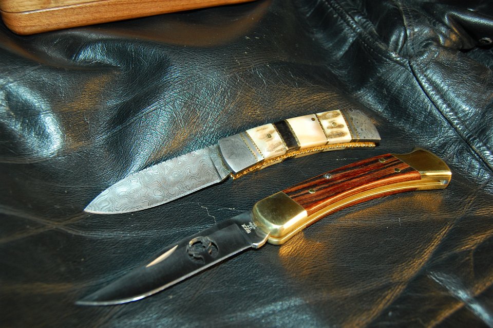

Hi Folks -
Here are a few pics of another Pakistani Damascus I picked up - a nice folder (non-locking).
best regards-
mqqn

Nice folds and twist to this DS. Edges appears to need to be anile, just looks like it. Anyway nice knife, fun one to put a little self work into just to finish it off. You can make it a lock back blade if you want. Like the wood and how it is layed out.
