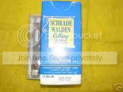

Let me know if there is any way I might help, please accept my best wishes. Hang tough Micheal, just like I know you always have in the past. LT PS Yup that is the real deal on the 8-OT. However these are the delrin versions they and the 2-OT were made in smooh bone. Still that is a nice six pack.
Pick your poison:
For the pure excitement, I'd take the bimbos. But for getting my money's worth, I'd have to take the Old Timers. :)
I mean, how long are three big-chested blondes going to hang around after they find out I'm a broke-ass geologist? About as fast as they can get to the door I imagine. How long's a six-pack of beer going to last? About an hour, maybe two. A six-pack of mint-condition OldTimer knives? They'll last forever.
Can anyone explain why the multi-pack box is labeled "80-OT"? I don't have a model 80 on my OldTimer list, and they look like regular 8OTs to me, but I can't read the tang stamps in the auction photos.
-Bob
