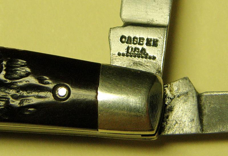

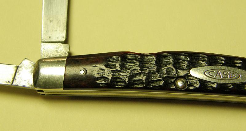

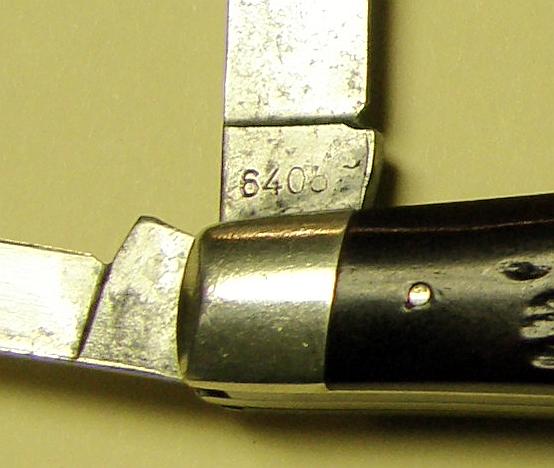

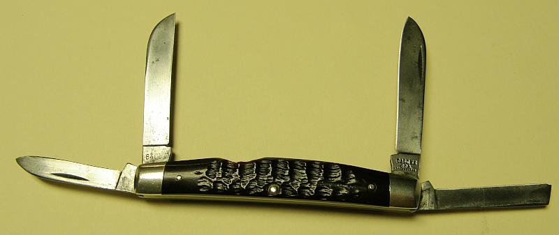

Here's an otherwise good looking "old" knife, you would think. It's suppose to be a 1970 Case small congress but it isn't. Looks good at a glance but my bad for not looking closer.

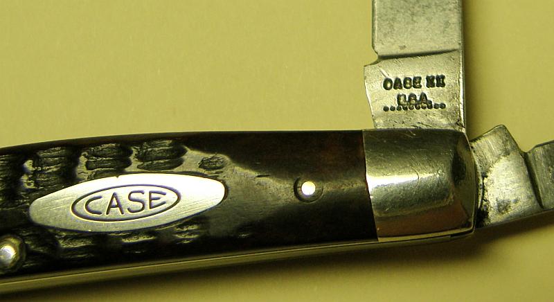

Look at the bulbous Case XX stamp. It's not crispy like the real deal. The 64052 pattern stamping is really bad. The marks around the pins are signs of shoddy, dare I say, workmanship. The shield inset job was done by hand. Do you see anything else?
I was in a hurry and didn't look at it with a loop but, thankfully, didn't pay very much for it. Had the price been up where it should be I think I would have looked a little closer and caught it. Another fake is off the street though but there is plenty more where this came from so, buyer beware.
It's still a knife. I sharpened it up and I'm going to use it on the bench till it gets worn down or broken and then I may just crack it open for practice. :D
I dunno Kerry -- if it's a fake, it looks a *lot* better done than most fake Case knives I've seen. My question is: if it's a fake, why fake a 1970 Case 64052? With that green bone, it would have been much more profitable to fake up an early Case XX (1940-1950), and the straight "Case XX" stamp is a heck of a lot easier to do. The number stamp doesn't look too bad really -- it starts deep and gradually fades in a consistent manner to a stamp not applied quite dead perpendicular, not unusual for Case - also the numbers are spaced evenly and they're in line with each other, all good. I'm also *not* seeing any stress risers around the stamps (upward metal displacement around each letter - typical of them being cold stamped - and thus fake). The scales look to be very well fitted with the bolsters - not typical of a fake.
Look at the construction: is the center liner quite thick -- about as thick (or maybe even a bit thicker) than one of the springs? If so, this is a characteristic of a real (somewhat) vintage 64052. The blade profiles look like they should - nothing weird looking there. From what I can see of the shield inset - it might have been an issue of a dull bit tearing the bone as it did the insetting. Hmmm, were the shields of 1970 Case knives glued, not pinned? IIRC they were glued -- and came out easily. That might be a replacement or reglued shield. The hafting looks pretty decent - typical of a true vintage Case.
By 1970, Case construction quality was already slipping somewhat as they worked to leave their hand craftsmanship behind, so the various problems you're seeing wouldn't surprise me on a real Case of that era.
Looks legit to me, I see Case knives from that era with all the things your pointing out all the time.
I think the master blade, and thus the one with the Case stamp, should be the sheepsfoot and not the spear blade. Just my 2p.
Looked again...seems both large blades have the stamp and dots which seems odd IMO.

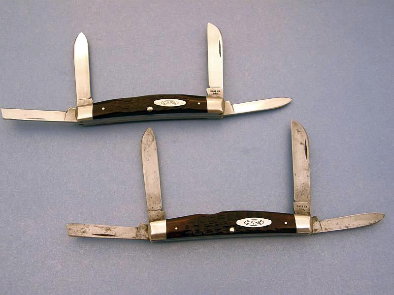

I have to admit that I don't have the experience of looking at many 70's era knives to make comparisons. I do understand that it would be relatively easy to increase the value of a knife by pulling the blades out of an off year knife and putting in a faked 10 dot or 5 dot to increase it's value. Apparently that is one of the things counterfeiters do.

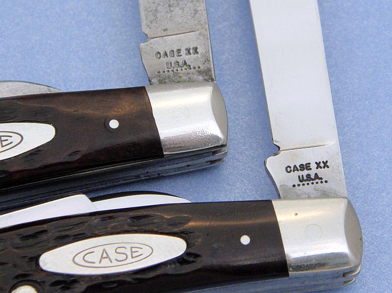

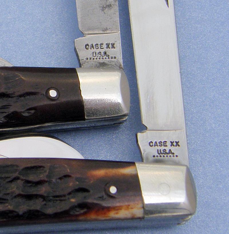

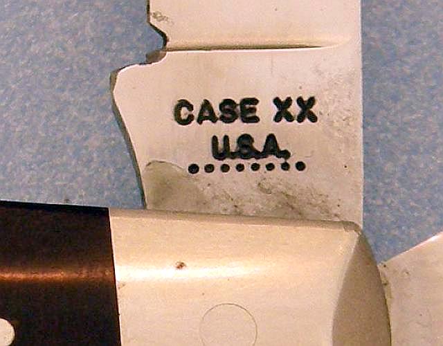

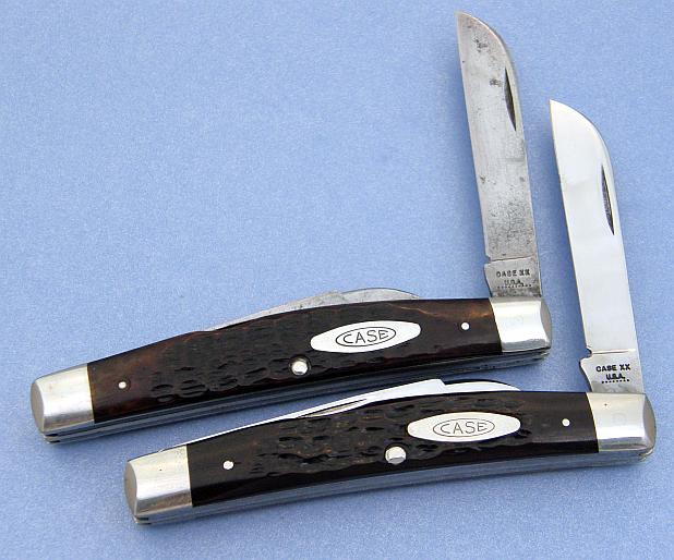

I do have access to a 1972 congress in mint condition and layed both of these knives down for comparison. I think the handle, pin and shields look pretty much the same as far as workmanship. The stamping is mighty queersome though, posted here for your amusement. The stamp on the 70 is what I would describe as being "webbed" or over stamped. The stamp on the 72 is crisp with no webbing.
The 72 is on top in this image. The blade config looks ok.
Whew, man, I thought I'd totally lost my mojo there for a while -- thanks for the second set of pictures - that last picture makes it very obvious that it's been restamped. So, it *is* a Case 64052, just not the particular vintage of 64052 it's pretending to be. So long as the blades all have good walk and talk, and they all take a good edge and keep it reasonably well, I'd say a carbon steel 64052 with full blades for $50 is a pretty decent deal.. Use it up and enjoy it.
