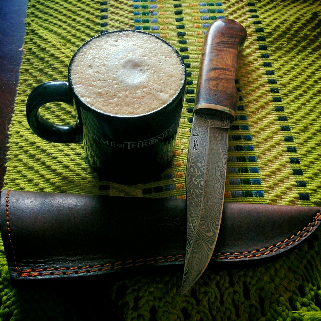

I have this bushcraft knife from Perkin knife in the UK.. it cost me almost 95 euros. Real Damascus? I prefer to think that..

The crooks from Perkin sell a lot of shit knives from Pakistan. Perkin 'marketing' is undiluted bs. Often the price for a Perkin 'knife' should be a hint as to who and what we are dealing with (but then again the Böker is also cheap and Böker makes a lot of nice okay quality knives depending on the model range/knife line).
Dont buy from Perkin!!!
Buy your pattern welded knives -any knife really- from a reputable dealer and get a quality knife.
The crooks from Perkin sell a lot shit knives from Pakistan. Perkin 'marketing' is undiluted bs. Often the price for a Perkin 'knife' should be a hint as to who and what we are dealing with (but then again the Böker is also cheap and Böker makes a lot of nice okay quality knives depending on the model range/knife line).
I know the reputation of Perkin, but the knife I bought is a really nice well constructed knife, perhaps is made in Pakistan, but is a nice piece of cutlery. Maybe we have to call it Perkin from Pakistan..

If that knife is Pakistani "damascus", the odds are 0 that is is "historical" damascus, incredibly slim that it is pattern welded "damascus" steel, and quite likely that it is mystery steel that just has a pattern applied to it via some photochemical process

I don't care if my knife comes from Pakistan, China, USA or Mars.. if is well constructed, nice blade shape, decent steel and safe to handle it will have for sure a place in my collection... All knives are welcome....
