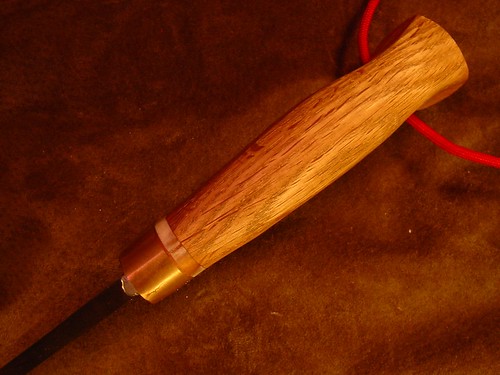

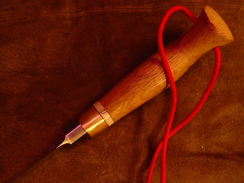

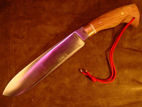

I dont know if you guys really want to see this knife. I'm not sure your ready for it.I have to say this knife is one of my experiments in blade design. It's not pretty, but boy does it cut!
The blade is just about 10 inches and the OAL is 14 7/8. I made this blade from a late model Chevy truck spring. I felt like I needed the mass for the heavy spine, which is about .035 at the ricasso tapering to the tip. I had to rush this one because I used my former competition knife to pass my JS test and did'nt have much time to make another. I used the opportunity to try some ideas I wanted to try. Of course, seeing the designs of others did influence my choice of features, but I definitely wanted more weight foreward and wanted my handle to have more pull/power. There was other things too, but those were the major things I was trying to accomplish. As you can see, I did'nt finish the blade or the handle. I am thinking about going ahead and rehandleing it and bringing the blade to a better finish. Heck, the handle is from a peice of oak railing that I just picked up from the job. As I said , it was just an experiment that turned out well for me this time.This shows the botom of the handle.![]()
This is the top.I'm stressing design and not looks by showing these photos. The knife was meant to be a "beater" and it looks it.![]()
I am pleased with the way it cuts. If I rehandle it, I may add a minimal guard for added protection for slipping forward, although I did'nt notice this problem during the competition. I would be glad to hear you guys suggestions. Really, what do you think?
