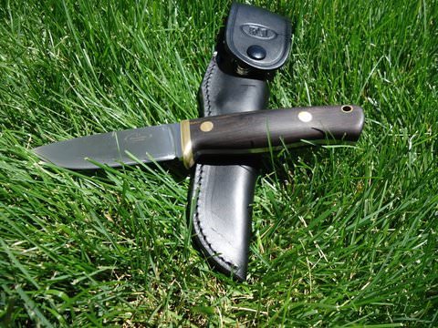

Yes the handle is homemade.
It was fairly popular to rehandle FK's when the old FK forum was alive.
Jhansenak47 also did some of them.
Regards

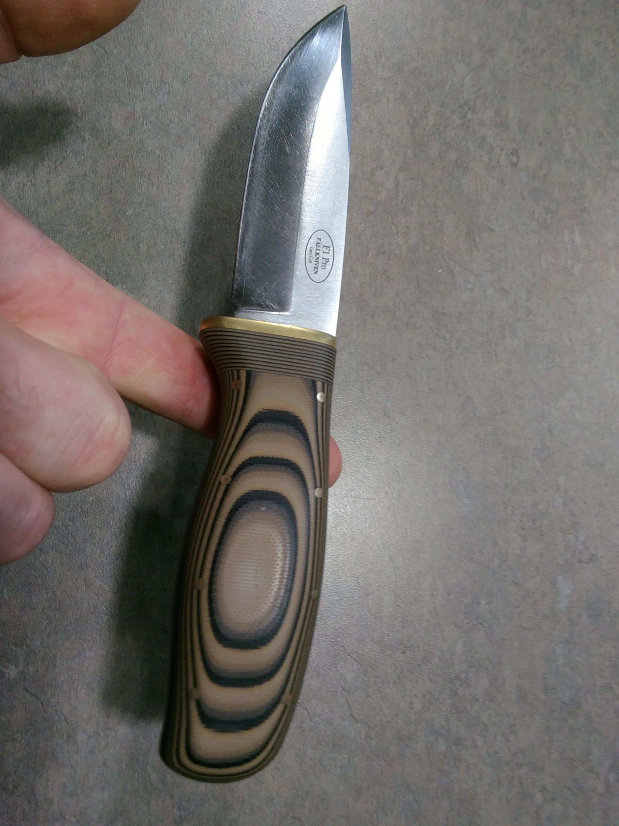

The F1 pro is an experiment.
I want to make something like this.
You should check out "thetopicala" on youtube. He has done several nice builds on fallkniven blades, amongst others.
I want to make something this.

That's Jawsdropping! :thumbsup::thumbsup::thumbsup:
I don't do much rehandlings nowadays, but I do have the F1 Pro and a nice block of Bubinga.
So maybe it could happen in the future.

Awesome work on these knives guys, I'm liking those rehandled Fallknivens and Thanks for the Video J.
Doug

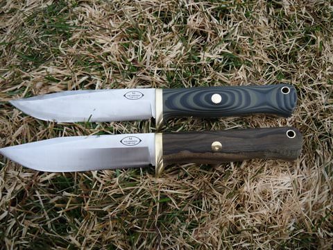

I regret a lot NOT buying some Falkniven blanks when they were available (full tang)... those handles look great, although so much polish may turn into slippery if your hands get wet or oily. I think the kraton handles work just great (but I don't have big paws).
Mikel
Mikel

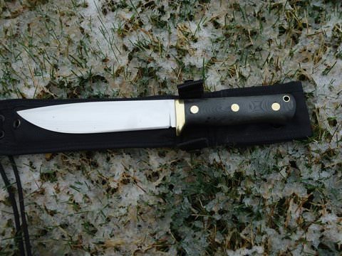

I use 100 grit sandpaper and the contours to alleviate slippage. I personally hate the shape of the Fallkniven kraton handles because I think they are too thin and squared which gives me poor ergonomics. (Except the Fallkniven H1 which is an oddball in the Fallkniven lineup.)

Your right as I feel the same way about the squareish handles. It looks like you know how to fix that problem though, nice work. I do kind of like the exposed handle butt steel sticking out the end of the handle though. I'm not sure how you could pull that off with a linen micarta rehandle job.
Easy. It only requires to shape and polish the front AND back end of the handle slabs. Is you are starting from a rubber handle piece and want to keep the tang hidden on the sides, you can route/mill a channel (half thickness in each slab). Enough epoxy and a couple pins.... And you are good to go!
I did something like that for a diving knife and it came out great.

I made the pommel a large bell to make it easy to pull out of a pouch sheath and give somewhere to strike with the palm to drive the tip in. You could probably strike with it as well, but it will just get marred like the rubber handle Fallknivens do.
Fallkniven is on the record stating that the only purpose of the exposed tang pommel is to drive the tip in. They make poor hammers.
