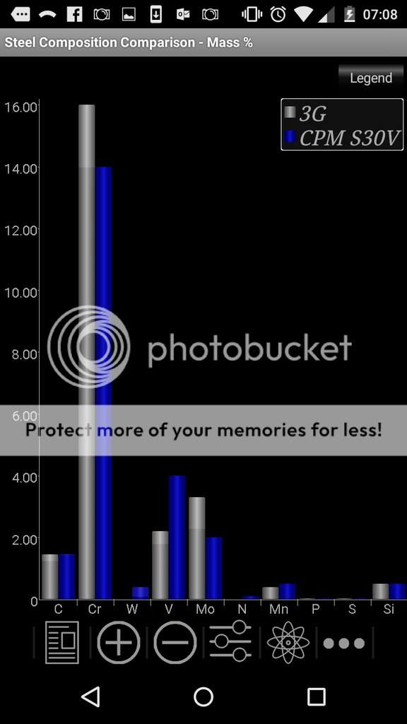

Now that I've made some observations
Let's discuss in detail 3g and how it compares to other steel on the market.
The Steel is made by Takefu Metals in Japan.
There not the biggest steel mill in Japan but they are the creators of one of the most prominent high end stainless steels in the world, V Kin (Gold) Ten or VG10.
3g is a not the name of the steel used rather it's a proprietary Laminate with two softer pieces of vg2( a low carbon stainless much like 420j2) for added ductility and strength
The core is listed on the Takefu site under "Super G2"
Also known as Super Gold powder steel (SGPS, or SG2)
To add to the high cost, the steel is actually devolped by the hugh Kobelco Steel company of Japan. It's under the name "R2"
According to zknives,
It's supplied to Takefu Metals and sold under the name "SG2"

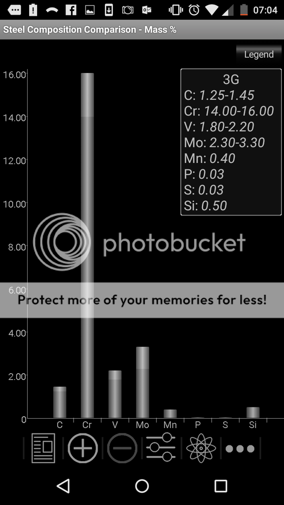

Here's the composition.
Recognize anything?
The composition is actually very similar to S30v.
Yet it works differently.
It has the same carbon but the vanadium is lower.
Vanadium is a very good carbide former.
If you know nothing else and are looking for high amoints of wear resistance Vanadium is key. (In small amounts it's a grain refiner though)
It's seriously the biggest leading factor in wear resistance which contributes to edge holding but is not the sole component.
3g has more molybdenum however which is another carbide former it makes softer carbides that are easier to sharpen.
Also 3g has a higher amount of chromium.
These leads me to what sets 3g apart from S30v it has a higher working hardness of 62-64hrc versus S30v at 59-60 hrc
Yet it takes a more polished edge and sharpens faster then S30v.
This has its merits especially for a steel made for a different knife culture that sharpens on waterstones, but I believe S30v is still the all around champ when it comes to wear resistance and other factors we will discuss in even more detail.
Also a disclaimer about discussing the mechanisms of steel ingredients
It's really speculation to a degree.
There is so much synergy between how the alloys behave with each other let alone various heat treatments and underlying structures that form that a true understanding is out of my grasp.
Especially without a few Master degrees with a PhD in metallurgy with specific knowledge of how to apply it to knives
I'm just a caveman just like you guys.
I just like sharp pointy things:D
