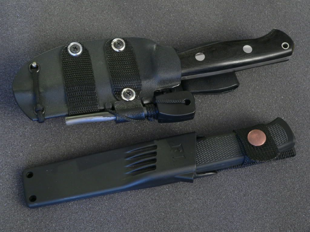

I had both. I like my Bravo 1 more than F1.
As it was said before these knives are a bit different. F1 is a bit closer to a Gunny.
F1 is an excellent knife. I really like the Zytel sheath. It is simple and works great. If you want stainless I think F1 is a better value than CPM154 stainless B1. But as I have said before I like my A2 bravo more than F1. Blade on B1 is thicker, but still performed a bit better than F1 (your experience may vary). Handle on B1 is more comfy too. Kydex sheath the way it ships from Bark River is pretty crappy. With some heat and a bit of tinkering, it can be adjusted and fitted properly.
