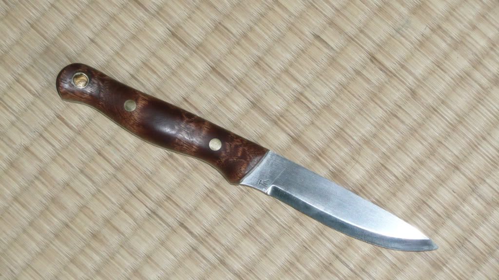

When using knives with no guards, I always go for something with some belly to the handle and the thinnest part of the handle is where the little finger wraps around. This will stop the hand slipping up. Grip is more towards a katana grip than a fencing grip. Something like this
that being the case if you're using this as a hunting knife or EDC, there's going to come a point where you're going to require multiple hand positions and with wet hands (or bloody) I wouldn't even consider a knife like this an option... the last thing you want with animal blood on your hands is to run your fingers up the little hump and across the blade. I cringe just looking at that.
