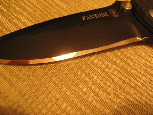

A well designed folder, the Fantoni/harsey also boast the extremely wear resistant CPM S125V. The knife overall would be a good general user blade, its has good handle ergonomics and a larger hand filling size (I wear a lg glove) that most smaller blades don't possess. The blade shape lends itself well to nearly every cutting task and due to it filling size keeps hot spots in your hand from forming during long periods of cutting. The action was smooth with a strong detent, there was slight side to side play but that was corrected. The knife arrived with the edge in a sad state and needed a little fixin

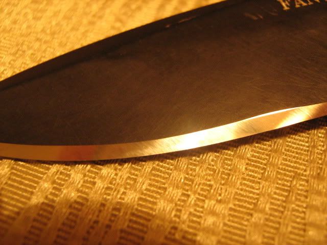

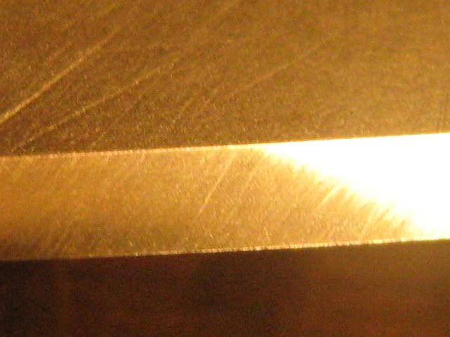

The steel was surprisingly not that hard to sharpen with diamond stones and in my opinion easier than S90V. Using the aligner clamp and DMT bench stones XXC-EEF I did a complete re-profile and sharpen followed by a light strop before testing. With a stated Rc of 62.5 and such high wear resistance I expected it to take much longer to sharpen. During sharpening the steel unfortunately did not feel this hard and developed a burr that stayed with the edge until polishing. The burr and "feel" of the steel on the hone leads me to believe the heat treat may be less optimal for this steel than it could be with the slight possability that its not all the way up to the 62.5 mark. It did however yield one of the best finishes to date from my EEF stone and aligner combo.
Here you can see the burr

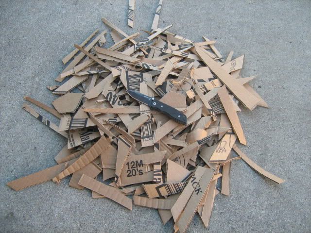

When it came time to cut the steel lived up to is rep and dulled in a typical CPM stainless fashion (that's not a bad thing). The razor edge was lost quickly but stayed fairly sharp throughout the cutting session, I found myself having trouble trying to really dull the knife and with cutting cardboard was unable to inflict any visible deformations to the edge. I repeated this test twice with almost exacting results and was able to restore hair popping sharpness with just a 1 micron diamond compounded strop. This was also a good test of the blade coating that surprisingly showed minimal to no wear.
