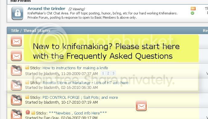

FAQ sticky
Lots of good suggestions.
One thing I would like to restate is that a FAQ is not a tutorial list or a book on knifemaking....
It is a Frequently Asked Question folder. The question should be very basic, and the answer should be short and reasonably universal.

Stacy, could you possibly change the layout of the main page? Maybe make the first two lines into one so that it stands out more? Maybe something like this:
