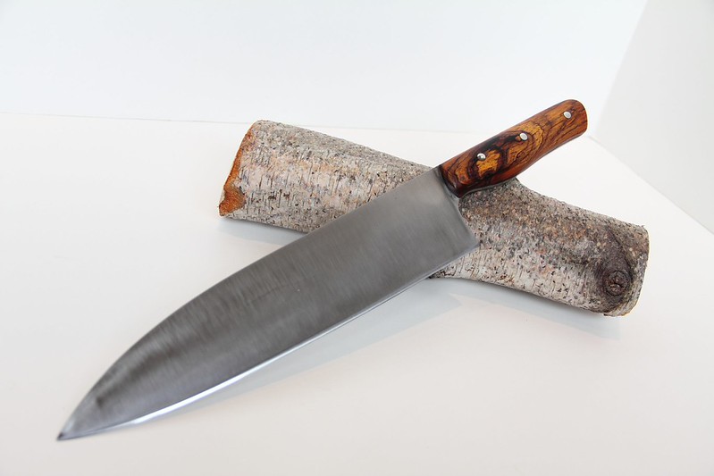

I'm sure it's not the best, but I used 1084 for my first one. It seems to be holding up well and it keeps a good edge.

1084 makes a great knife. The fine edge needed in the kitchen is just better served with the steels listed above. Nothing wrong with 1084, it's just other steels will het a few % better if correctly heat treated.
