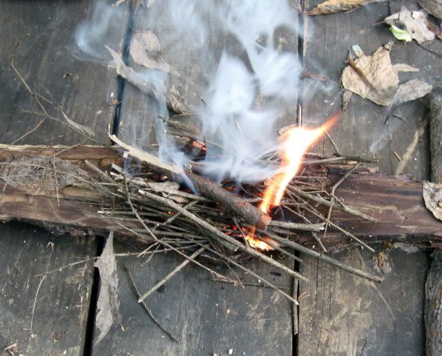

I saw a version this method for fire starting on you tube a while back. It was done by the editor of a magazine. In his video he used the terminals of a cell phone battery to heat a piece of a brillo pad hot enough to ignite a cube of "wetfire" tinder.
Since I have found fatwood as easy to ignite with the sparks from a firesteel as the wetfire I wanted to see if fatwood could be ignited this way.
For this method pretty much any knife will do, as long as it will cut thin fatwood slivers. I used some "fine" steel wool for this experiment.
I sliced some very thin slivers of fatwood, tore off a piece of the steel wool and rolled into shape about two inches long, and got my cell phone battery out.
On this particular battery the positive and negative terminals are the two on the outer ends of the row.
Folding the wool into a "U" shape and touching the ends to these two terminals creates a short cause the steel wool to spark and smolder. Blowing on it once it sparks good causes the steel wool to burn in ember fashion and flair very hot (wasn't blowing while I took the picture).
I then placed one of the long thin slivers of the fatwood on the glowing steel wool and blew causing the steel wool to flair and ignite the fatwood.
Then using that sliver like a match I ignited the pile of fatwood shavings.
Add some small twigs for fuel and you have fire.
Note: This took a few tries to figure out which steel wools would work. I learned that medium and coarse steel wool would not work...at least not in my tests anyway. I did learn that I could consistently get the fine wool to spark and flair. however in the course of the experiment I drained the battery and even melted part of the plastic of the housing around the terminals. The phone I used was an old one, and i suggest that if you wish to practice this you do the same. The battery is in the phone now, and is charging and the phone did power back up and function however I do not know if it will hold a charge now.

Good one, Mist. When I first learned of this technique, about 30 to 40 years ago (the technique has been around a long time), I went hog wild and tried all kinds of batteries and steel wool. 0000 (4 ought) steel wool seemed to work the best. I was surprised to find that virtually any battery would work: AAA, AA, C, D, and a 9 volt all sparked my fire, so to speak. What I didn't have was fatwood (honestly, I never even heard of fatwood till I joined this forum). I used dried grass back then, and it worked pretty well. I think fatwood would be even better.

The reason I wanted to try this with fatwood is to see if...in theory at least...it could be used to start a fire in damp conditions using a non chemical accelerant. However I suppose it isn't all that practical with steel wool not being common in most backpacks. I may just put a small piece in my cell phone case though as a "just in case measure. After a while I'll get a chance to see if and how the inevitable rust effects the method.

Seriously - I wish to heck there were a few decent flashlights that used 9v - love them square batteries and boy do they work well for this. Rick showed me the cell phone trick earlier this summer. Also showed how it could be done by stacking AA's like in a flashlight and holding the wool to each terminal end. That was trickier but he got it to work.
Best think on this one is having char cloth around to take that glowing steel wool and hold the ember. As Mistwalker says, the characteristics of the wool are critical. I get the fine wool to spark up well but I find it doesn't hold that glow overly long. Like I said, the char cloth or tinder fungus works nicely for holding that ember and giving you some time to get you tinder into motion.
