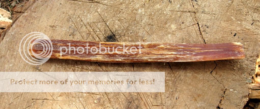

I decided to use "average examples" for the test. In other words, what the average person would most likely buy or find on their own. I do have premium fatwood sticks of Douglas Fir and Longleaf Pine that are almost solid resin, but wanted to test stuff that was slightly more typical.

So which fatwood do I think is superior? Without a question, the Douglas Fir. It was the easiest to light, burns like a road flare, has plenty of resin for longer term storage, and puts out the most heat (I couldn't measure this per se but it was obviously hotter than the other fatwoods when a hand was placed near it).

PS- I read in Mother Earth News that Douglas Fir has the most flammable resin of all conifers, hence the heat output.
i guess i 'lucked out', the mountain property that we own and live on, was logged around 50-60 yrs ago and some large DFs were taken. leaving some pretty nice stumps, so over the years the fatwood formed and i just happen to find it. it was actually by accident, i was screwing around the cabin here one day and just started knocking on an old stump with an axe, and 'lo and behold', the stump crumbled, but left the fatwood standing. i did the same with a couple more and the result was the same.
