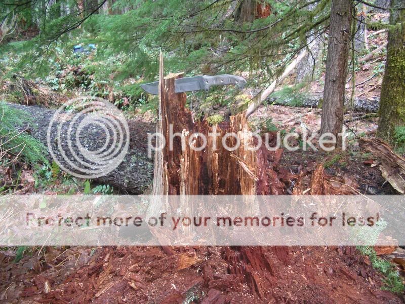

On a recent outing with River-8 and Rescue Mike they showed me what to look for in a fatwood stump. A pine that has been blown over, struck by lightning or cut down. Basicly a catistrophic event caused the tree to die with the roots still in the ground.
River-8 found a good stump, you can see in the pic the dead rotten punky wood that surrounds the fatwood. If you take your knife or axe and hit the hard wood you can instantly tell by how solid it is. You can see in some of the pics the dark translusant almost purple color, that is very saturated with pitch.

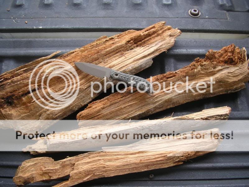

Some great pieces that I collected.

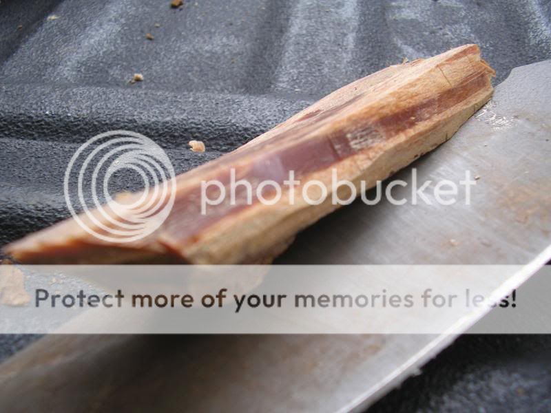

Here you can see the saturated fatwood!
