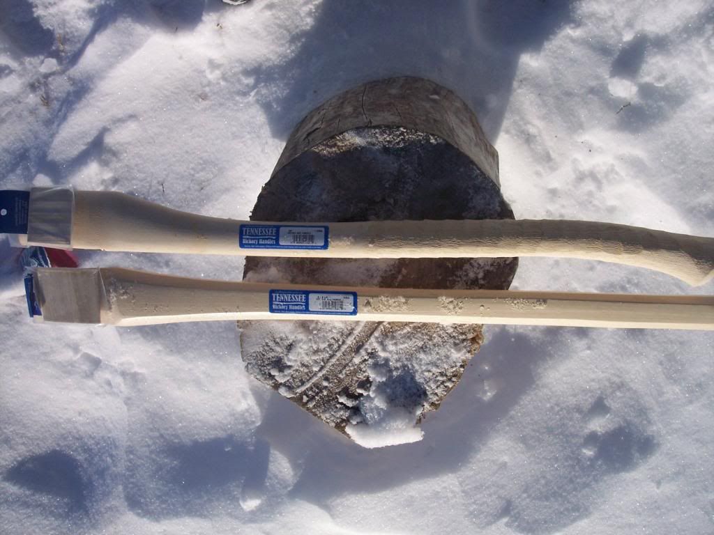

This has been my experience with their full sized handles as well. Their boy's axes tend to be the right thickness for me. The other day I actually hung a 3.5lb HB double bit on one of their 36"ers and the stock was so thick that I was able to knock the shoulder down 3-4” and make it a 32.5”er overall. Also probably took off a third of the thickness when reshaping and octagonizing. But if you have the time, tools and patience, TH has great handles with awesome grain and plenty of stock to make customization a forgiving venture.

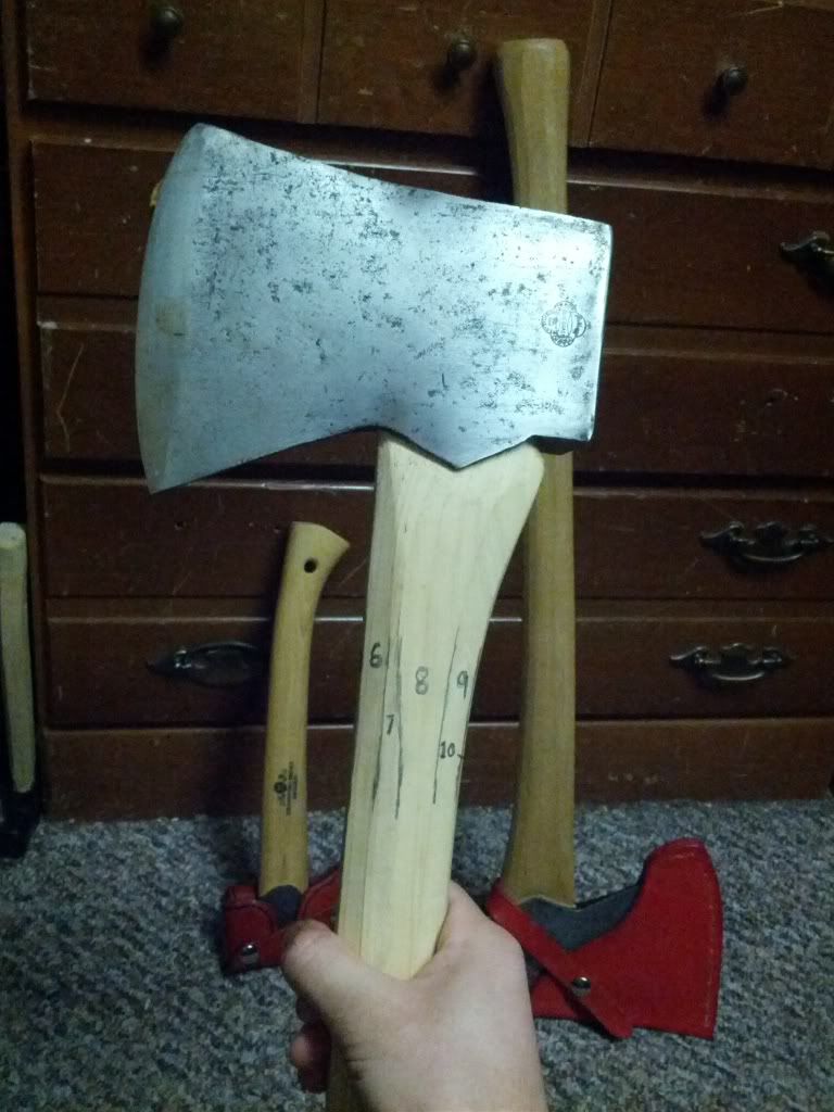

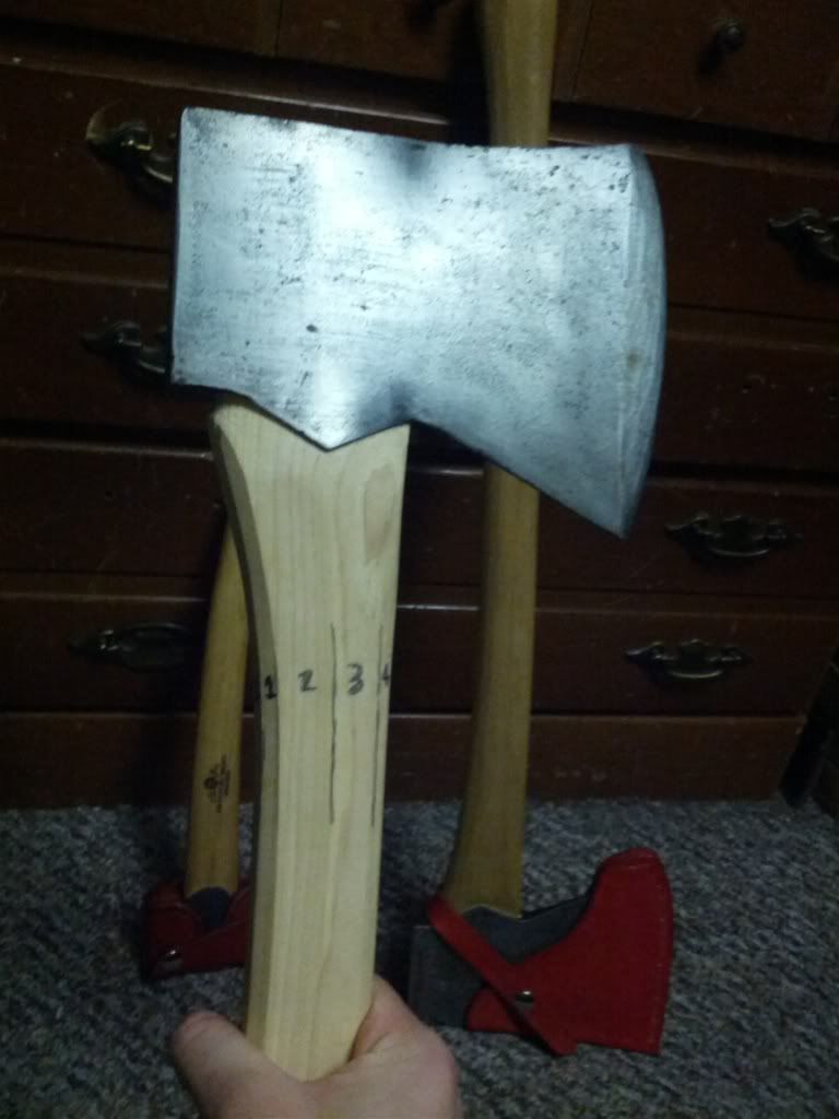

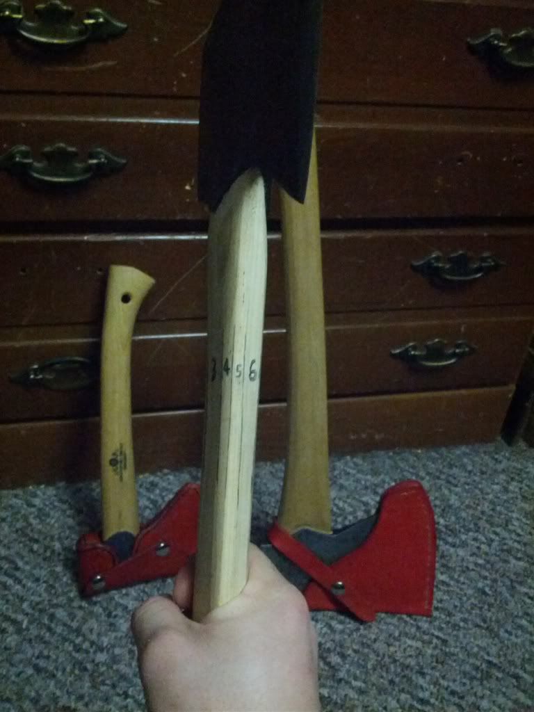

Oh and here's what I meant since everyone else seems to be posting pictures in this thread. Probably the worst offender of what I was saying about House Handle's octogonizing. A 30" curved handle that I used for my 3.5 lb Bluegrass Jersey. It doesn't actually impact my swing and overall accuracy, but I really can't use the "feel" of the faces to know exactly where the bit is in relation to the handle as I'm swinging. Somewhat hard to explain. Still, my main issue is that I paid a premium for a half-assed job...
