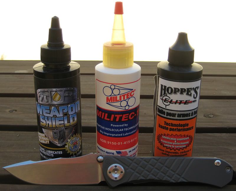

I use the stuff I use on my firearms. Pivots, bushings and screws treated with MILITEC-1 and maintained with Weapon Shield, Hoppe's Elite Gun Oil on the blade.
