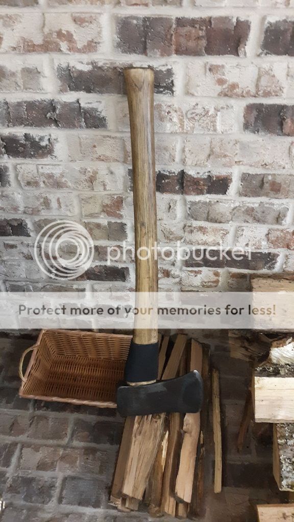

I put a leather handle saver on it-joined in the back. It's held by contact cement. Then I saturate the leather with pure boiling beeswax. When it dries it contracts very tightly to the handle and the beeswax makes the leather much harder and abrasion resistant.
The head is a 3.5# vintage Craftsman Ebay find- has good steel. I typically look for Craftsman first as they are often good deals. The handle was a 28" Faller's axe handpicked "House Handle" unfinished handle. It took very little shaping with a draw knife to fit the eye. I always eliminate the steep shoulders on the sides of the handle to make a gradual transition to the eye. I don't like wood protruding beyond the axe width. This is especially important if you add width with a handle saver. I don't like a saver that is a always being caught because it makes the handle too thick.
When I blued the head I discovered that there was some residue of light blue paint in the pores of the head that didn't take the bluing. It wasn't noticeable till the bluing was applied. I'm not sure yet If I will leave it as is or strip it and remove the old paint residue. Functionally its ready to go.
Head fit. I gorilla glue the handle to seal the wood, fill all voids, and bond to the eye. I also gorilla glue the wedge--waited 24 hours and then drove the metal wedge in additonally. The glue keeps the wood wedge from pushing when inserting the metal wedge and it gets the whole fitment very tight. Using Gorilla glue isn't part of a traditional fit, but it keeps things very secure through all types of weather changes.

Looks like it will work.
These axes take quite a beating if you really cut much. And suffer through a lot of weather of all kinds. Just the pickup bed in summer, might be 150 degrees around here. Then rain and snow all winter. Try as you might they're going to get some of that.
So all bets are off. Gorilla glue. Drift pins. metal wedges. All the axe snob
no-nos......whatever will get it tight and weather resistant as possible.
Yup function first. I do think I might square the head up a bit more on it. I heat primarily with wood but the last few years I've had so many downed trees from wind and ice storms that I haven't felled many trees.
