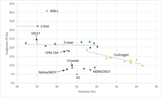

elmax is 1.7% carbon... I don't think it is known for being particularly tough as a result. (I agree that it is great stuff, overall)
it still only manages to get to the low 20's foot-pound wise in charpy v notch tests: http://www.bucorp.com/media/Toughness_testing_for_knife_steels.pdf
but this old BF thread explains the charpy's are not equivalent: https://www.bladeforums.com/threads/toughness-of-s35vn-and-elmax.1503215/
I expect sandvik 14c28n is higher in toughness... but for some reason, sandvik does NOT publish any charpy test results for it that I could find
https://www.materials.sandvik/en/materials-center/material-datasheets/strip-steel/14c28n/
but with 0.62% carbon, and around 0.1% nitrogen, it really should do better in toughness than elmax
found Larrin's tests! AEB-L is the toughest stainless tested :) about double elmax

I haven’t tested any Elmax or Vanax yet. I would be surprised if they are tougher than AEB-L but I am excited to test everything. The Bucorp toughness testing shows very surprising and perhaps even questionable results but I will reserve judgment until I can actually test Elmax. As for CoS it is likely to behave similarly to steels in its same general category: 154CM, 440C, etc.
