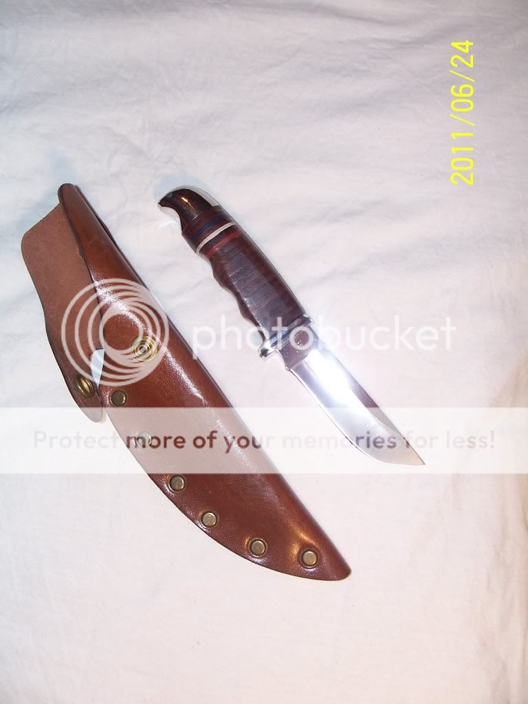

Something like this skinner works very well for me. It needs good belly, point and grind. With balance a lanyard and good handle grip. It does not necessarily need to be S30V. This one is a 440C blade and cuts for a long time. DM
