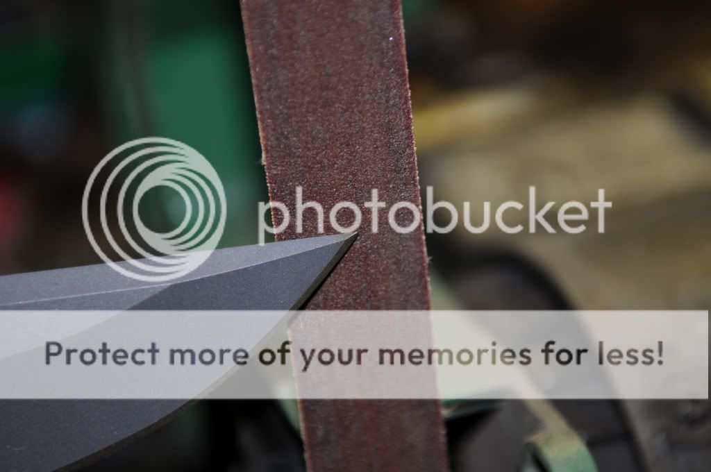

Making a nice tip was always my problem with the belt sander. I finally figured out a way to do it a couple years ago.

This is a great job! How did you manage to make such a nice tip on it?

I only bring the tip over about half way at most across the belt and then pull straight away.
Oh and thank you.
Sometimes I will get to the tip and reverse back the other way. Sounds silly but it works for me. the tip was the last part that formed a burr when I did it.

Thanks for your reply. I believe it is similar to asking about driving without me getting behind the wheel. I have to give it a try. Nevertheless, what do you mean by saying that you bring the tip over about half way at most?

Basically you just do not want to slide the tip off of the belt while you still have any pressure applied. The belt will come forward as the tip is sliding off the side and round the tip off. That is what I figured after messing up a couple atleast. It may not be the best way to form a nice tip but it is what I have figured out.
Below is what I mean by bringing the tip over about half way.
Once you bring the tip across this much or less, you will figure out how far you need to go, pull the blade straight away from the belt.
I hope this is better. I was having a hard time describing it.

This is definitely clear now. I understand what you mean. Thanks for clarifying that for me. As for whether this is the best way to convex the tip, I believe that the result speaks for itself. What more can one possibly ask?
