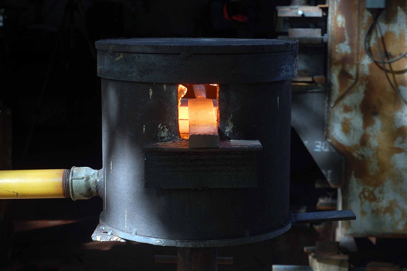

Feather damascus hunter, african blackwood frame handle (damascus making pics added)
That damascus us stunning, That is some of the best feather pattern I have seen, love the knife also
Thanks!

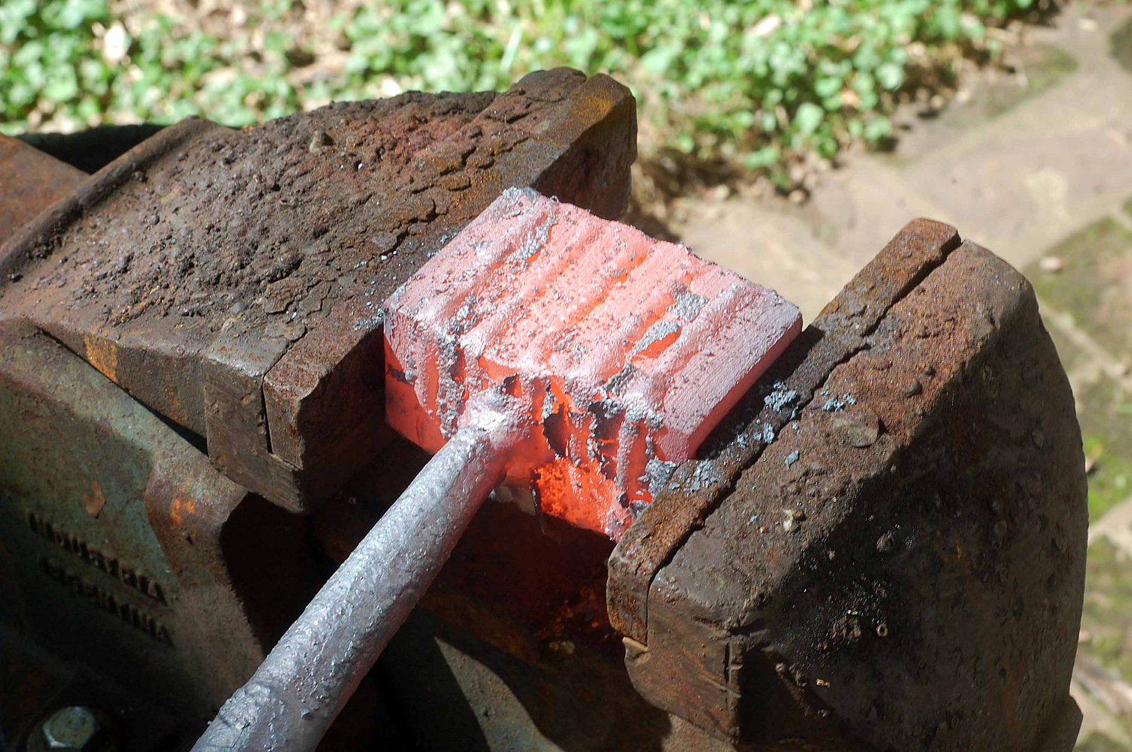

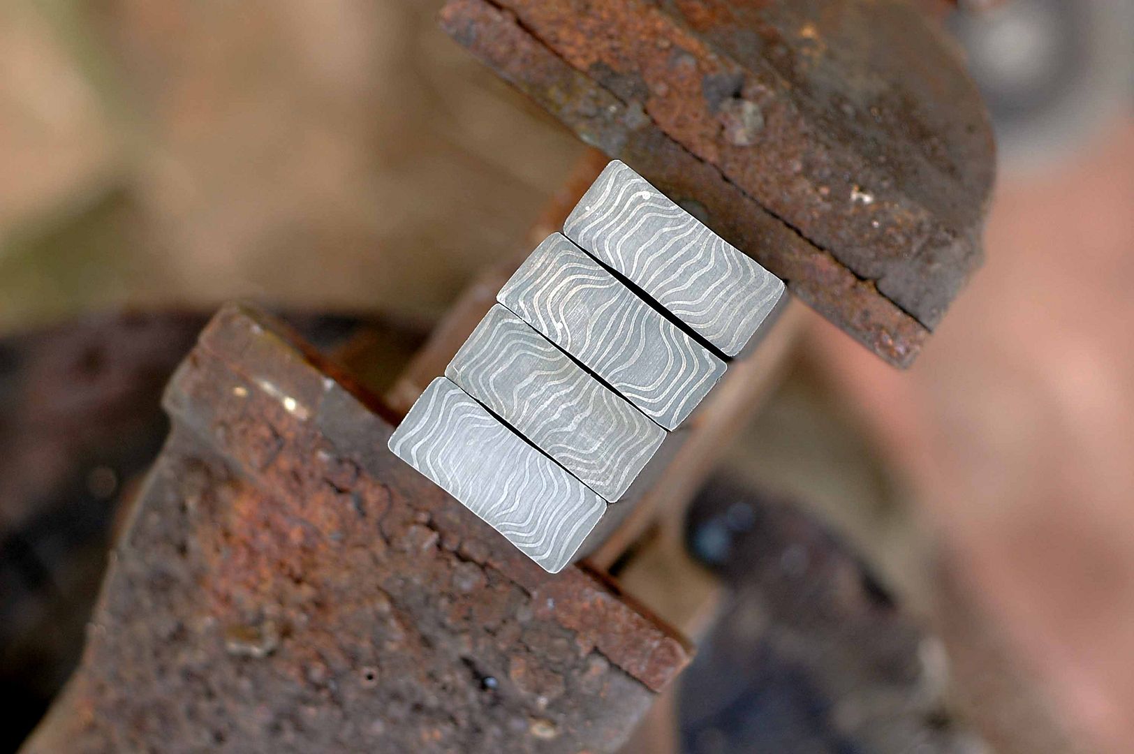

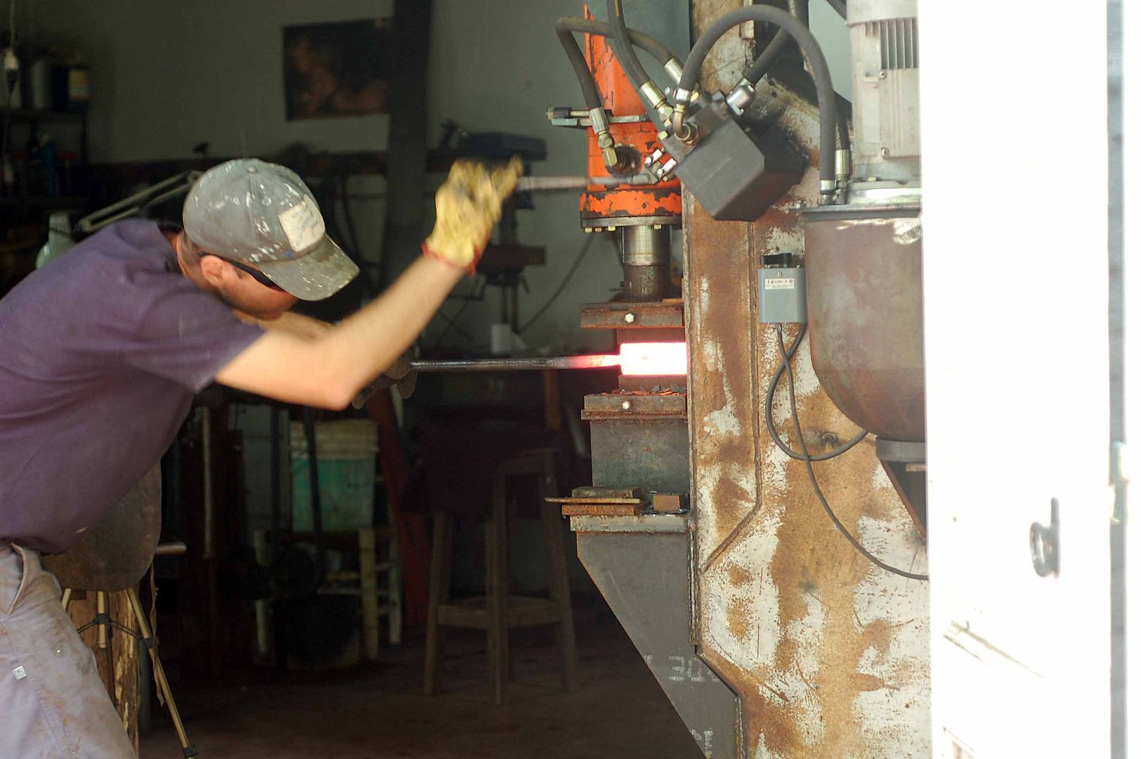

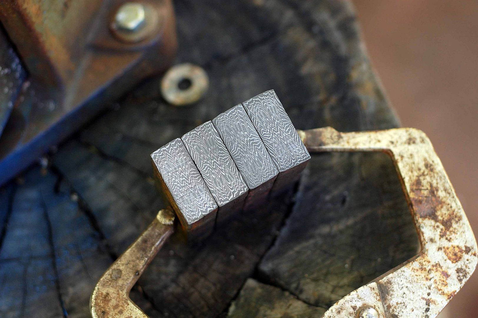

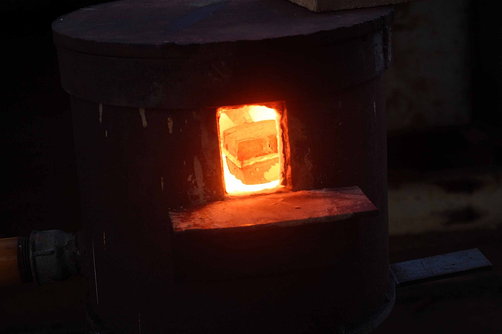

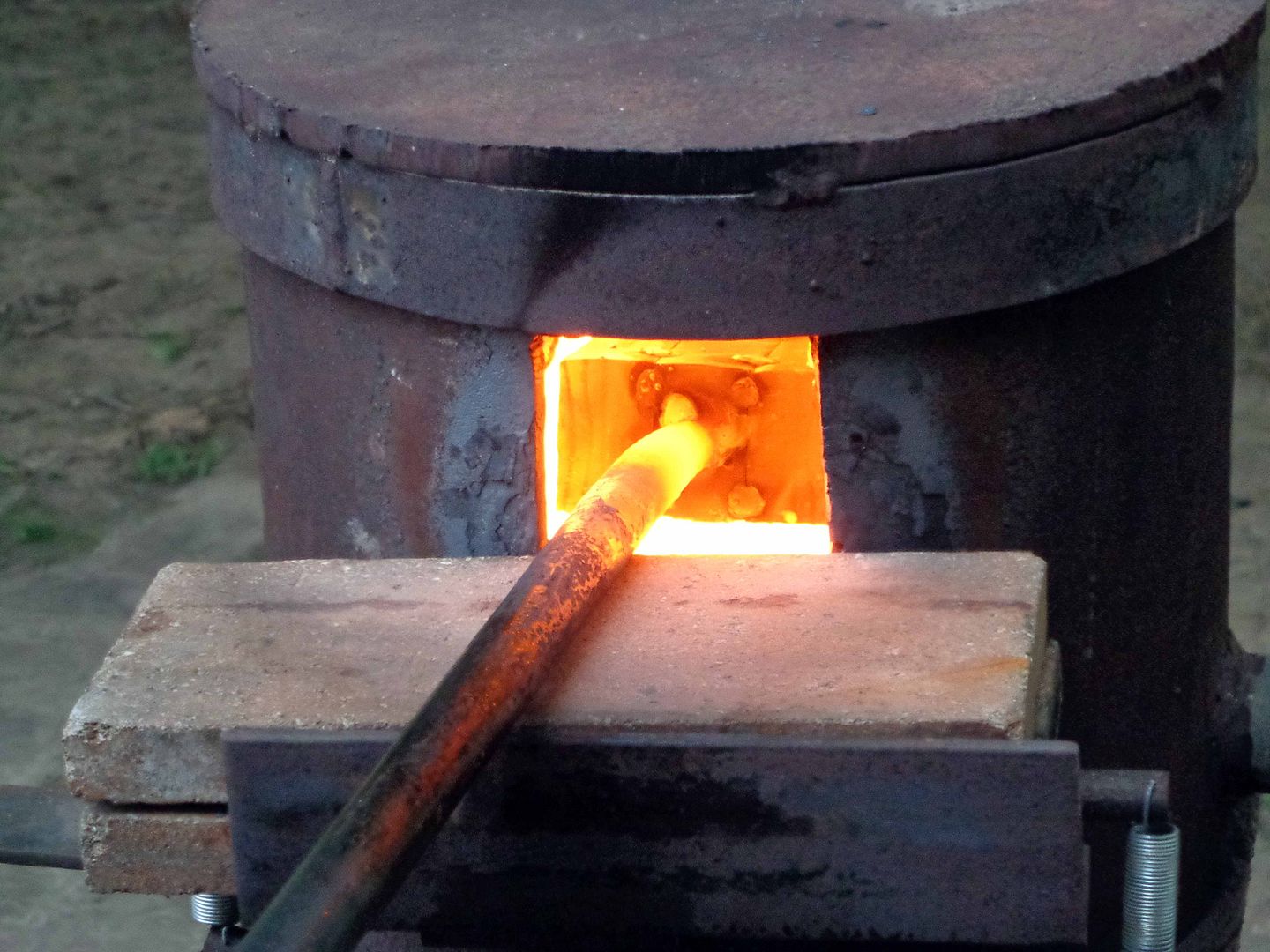

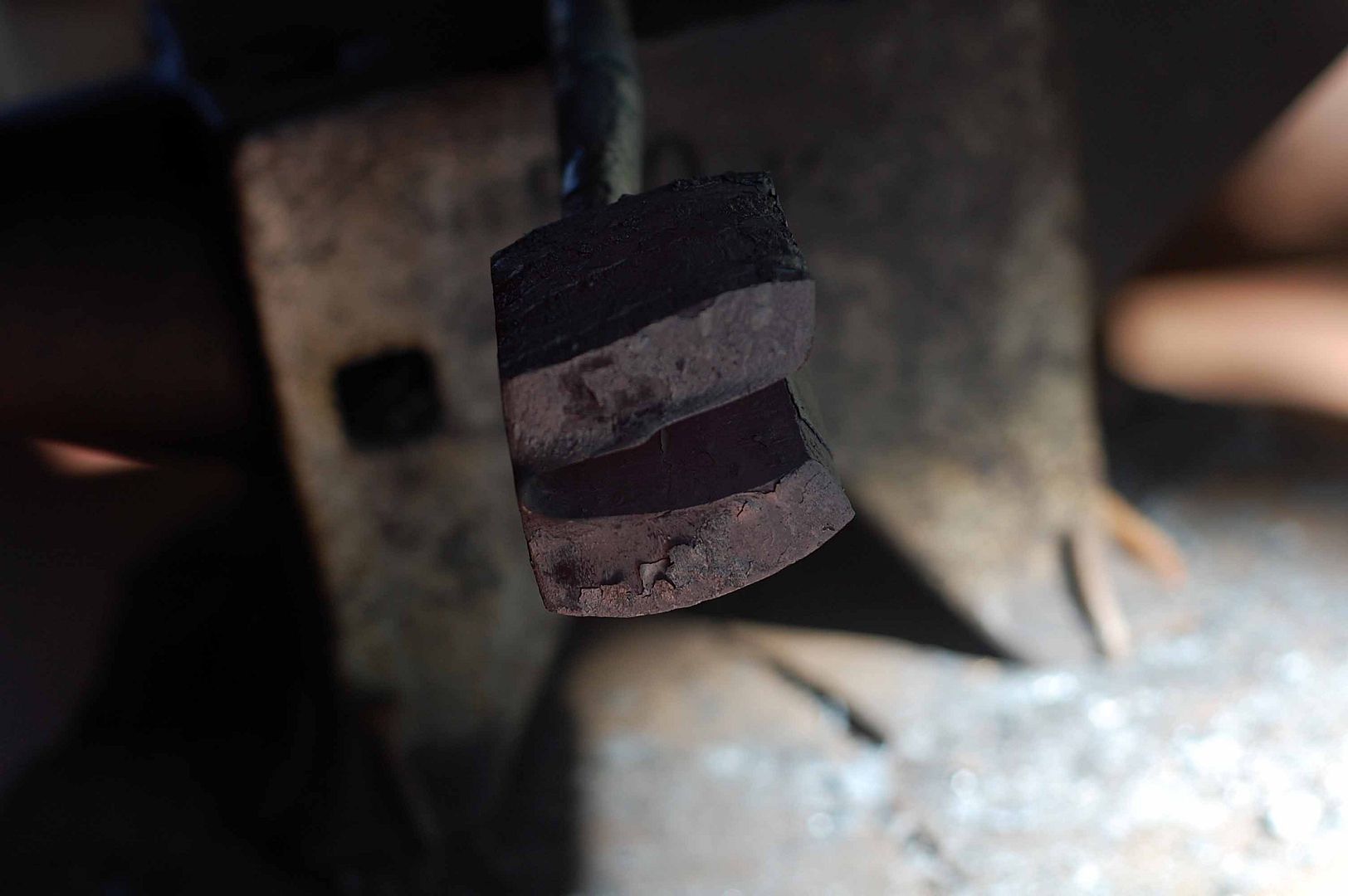

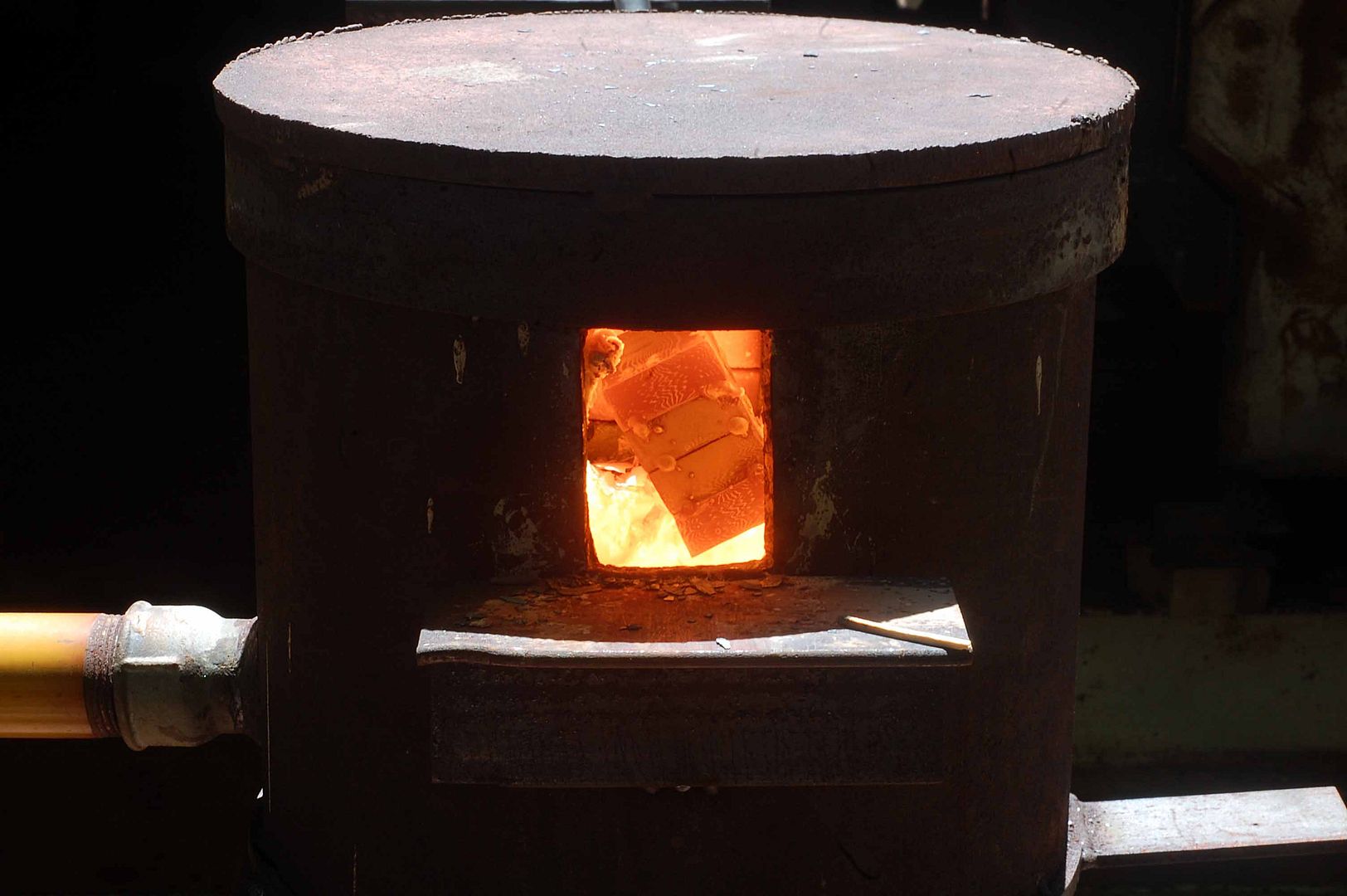

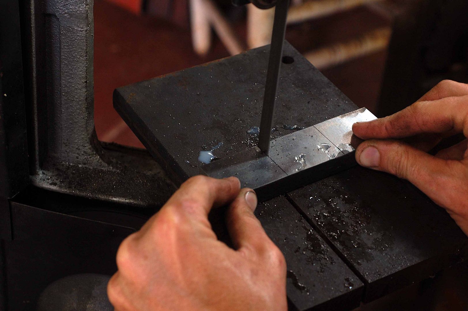

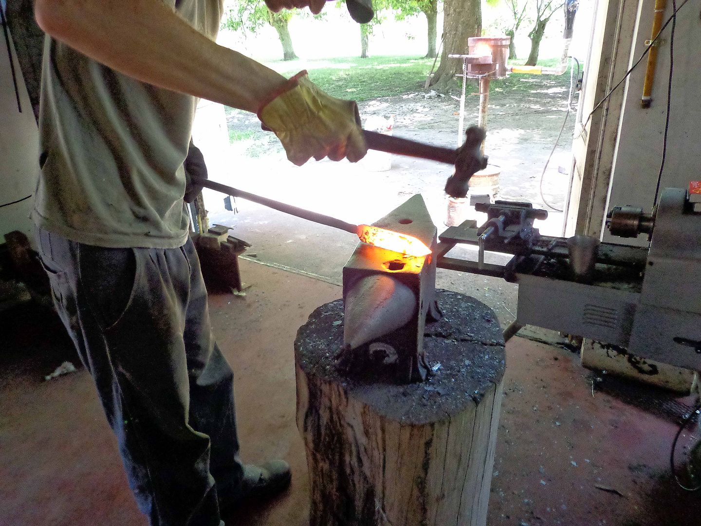

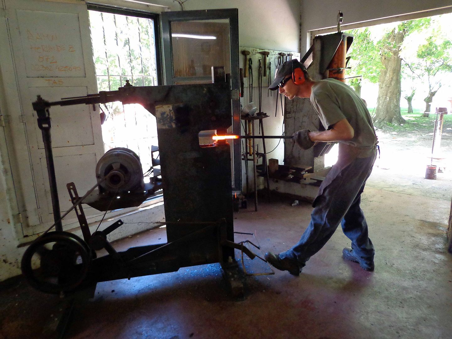

I forgot I had some pictures of the damascus making process, so here they are:
