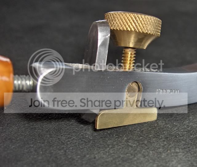

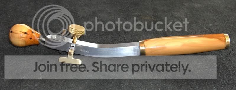

You can make a groover/fullering scraper. This is one I made a few months ago just from some scraps. The blade is 1095 and and I few others I made from CPM Rex 76. Each blade can have two different profiles on each end. It can also use 1/4" and 3/8" lathe chisles.
Video of it in action.
http://www.youtube.com/watch?v=DLaXnk5131o&fmt=18
