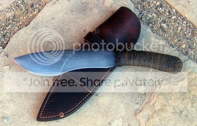

Feeling better today... aren't drugs grand? WSK Blade in progress

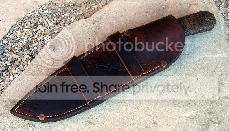

Finish pics....
That is a beautiful knife. You nailed this one to the wall. Well done.
Thanks, MonkeyMan!
The forward edge is a heavy but aggressive convex and the recessed section is almost completely flatground with a micro convex secondary bevel.
Wow, I like seeing the difference between your rough grind knife and your finished product. No one does the working finish like you. Great work.

how are you getting that patina, and how is the rust resistance afterwards?

They are as rust resistant as any 10xx series blade with a bit of gun bluing would be. Put it away wet and you'll need some WD-40 and steel wool in the morning. The good news is that even if you may that mistake, the finish will look no different then how it started out. I have been making and using knives like this from the beginning. You could always throw more gun blue on, later. I made them to be ugly users. Some folks find beauty in raw pitted tools.... How else would Jonnymac44 get a date?
