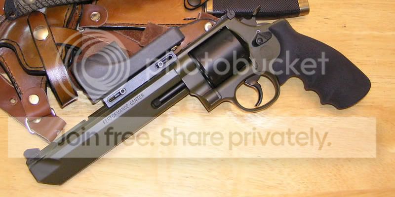

I would be interested in how that finish holds up on a knife. I've got a S&W with the green and black finish on it and it's some pretty tough s**t!
I had a long conversation with Mr. Birdsong after getting this gun and he definitely knows his stuff...just make sure you don't call it Teflon :D
