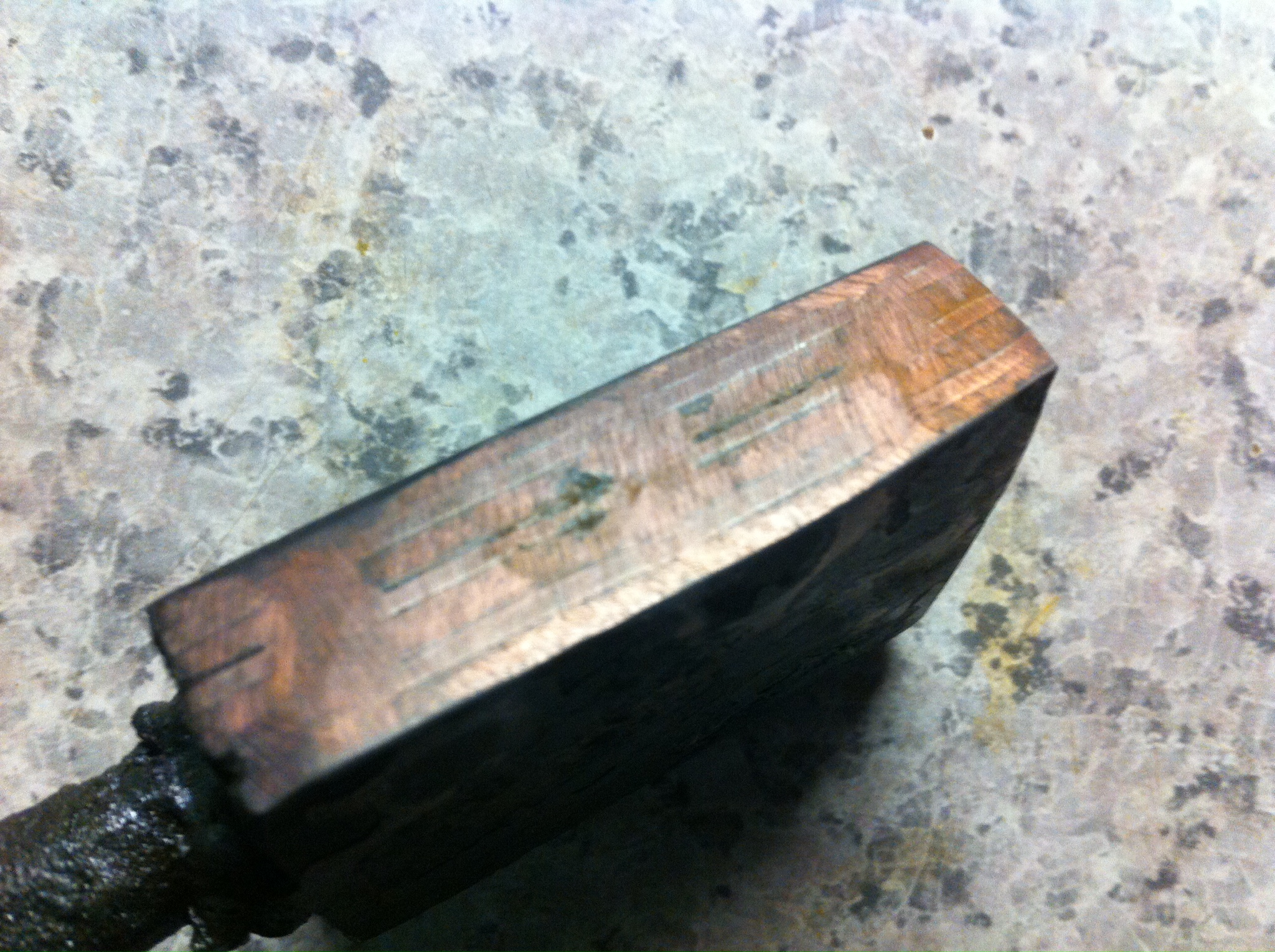

Has anyone else seen this reddish result from a quick dip in ferric chloride? The steels are 1084 and 15n20, but I saw the same result from leaf spring a few weeks ago, dusty rose red instead of the grey colors.
Any ideas what is going on here?

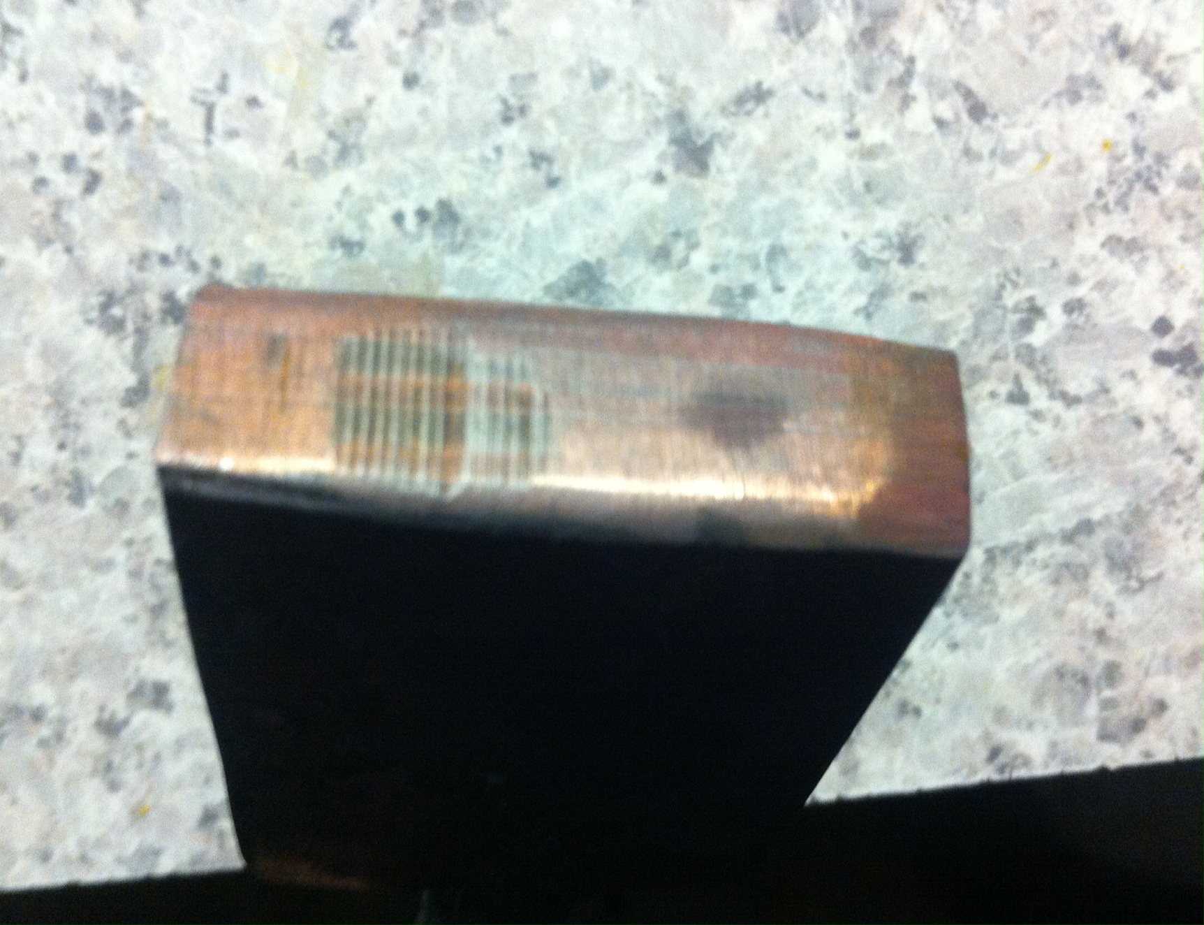

Yup, copper if it looks similar to this:
I tried to use contaminated Ferric to etch the logo on this Busse
~Chip
Yep copper contamination. Cool things can be done with copper contaminated ferric like the logo above but etching Damascus will leave the copper flashing on the steel.
