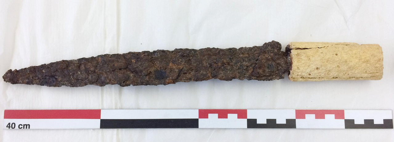

Newbie here, so go easy: I bought a bushcraft knife from "CFK Cutlery Company" on eBay - massive sales and 100% positive feedback, how bad could it be? The knife is a few years old, so I forget any technical specifics (probably "D2 steel"). I have used it rarely and lightly, and the other day, I was carving a Eucalyptus stick into a small stake and the blade LITERALLY STARTED TO RIP OFF IN SMALL CHUNKS. The only possible explanation I have is that when I last used the knife, I was having trouble starting a fire with a ferro rod, and I did run the rod repeatedly across the blade (not the spine). I know this is a bad idea for purposes of keeping an edge, but could it conceivably cause the metal to fail?! The metal does not show any discoloration I would associate with superheating. I'll see if I can upload a picture.

Okay trying the pic here. LMK what u think.

even steel not heat treated at all shouldn't show that behaviour...
it really could be 'pot metal' ... as it's commonly referred to... literally anything that melts?

It was probably hardened, but never tempered, judging from the pictures. I'd drop it on concrete and see if it shatters lol
That does not appear to be corrosion damage or anything from the ferro rod to me.
It's definitely some kind of steel failure.
Could be crappy "steel".
Could be poor heat treat
or maybe overheated the edge during the sharpening process at the "factory".
I agree. Despite the gobbledegook on their web page, they are made in Pakistan.
The owner of CFK has considerable history. And it is not good history. CFK is one of his later nom de guerres.
