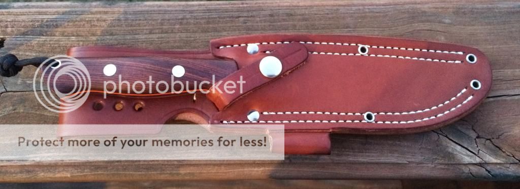

Does anybody know what size of rod would fit in this sheath? It's a BRKT Bravo 1.5 sheath. Is there a brand that you other Bravo owners know and use with this sheath? Thanks.
