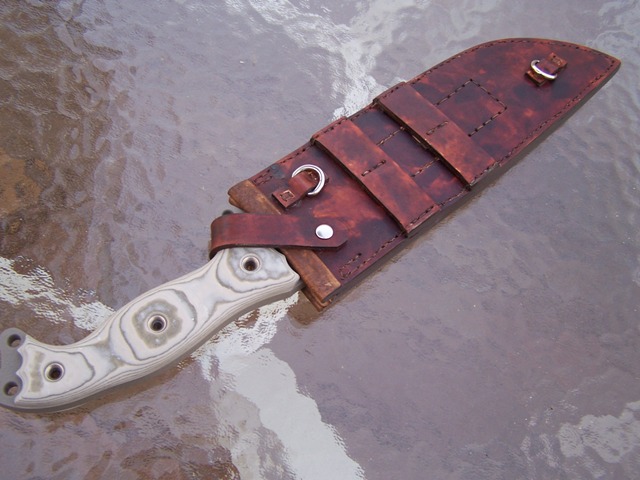

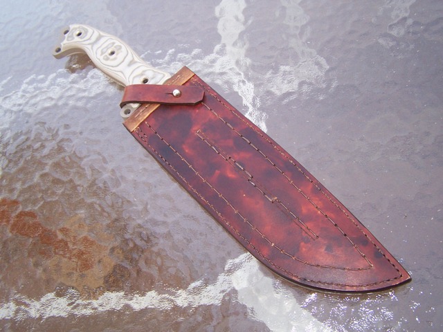

Just finished this. No belt loop. The intention is to Malice Strap it onto my Maxpedition pack. Its too heavy for a belt IMO.

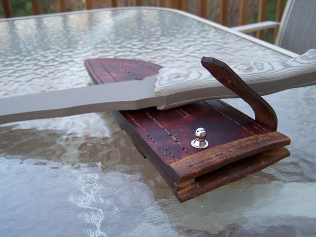

Its 9 oz veg tanned leather fully lined with a nice soft pigskin. The keeper strap is set on a rivet so it pivots out of the way. I don't like having to hold a keeper strap out of the way with my thumb while I'm sheathing a big sharp knife so this one pivots out of the way.

Naaa. There are some fantastic leatherworkers doing sheaths for Busse's. Those guys got skills, I'm just a knifemaker. What I like about it is that its a thin package. Once its mollied to the pack its on there solid too. I'll get pics of that later.
Gracias bro! I learned that splotchy stuff from GL Drew.
