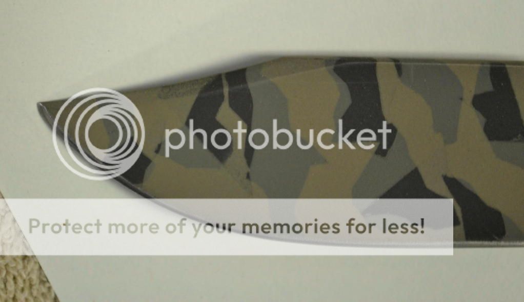

While I was mixing the coating I figured I'd do up another whole knife for myself in the same colors and pattern. But since designs evolve over time, this one is a little different besides the color, so I thought I'd share with you.
OK, Ta-Da-a-a-a! Take Three!
Also included in this package is aftermarket micarta obtained via Flea Bae that I'd been holding for something appropriate. I think it goes with the camo fairly well.
BK-17 - style clip point, even though it started life as a drop-point -16. Swedges, also. I'm getting better at it.
OK, so who are the eagle-eyed ones among us? What's different?
Note the jimping. Lots deeper than the stock jimping, with the additional feature of the thumb radius for comfort and additional grip. You can get a huge purchase on the top of the blade now.
Allow me to demonstrate:
So there you have it. Not an earth-shattering change from last time, but enough to warrant a post.
I'm liking the radius on the jimping. How did you do them, file, dremel, or what?
