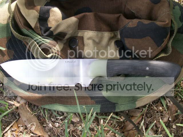

If you keep the same angle all the way from plunge to tip you will have a lot of full thickness on the spine till you get to the tip. This is when the spine is straight with no curve. However, if your spine has any curve to it then it will decrease in thickness towards the tip. When I say curve I mean from plunge to tip, not the last inch or so of a drop point (for example). I ground both of these with a constant angle. The spine on the second one is an arc from butt to tip. Not a single straight line across the top.
no curve
Curve
