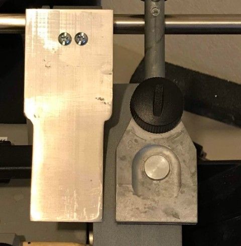

I'm really impressed with this knife rest. So much so, that I'm willing to order the scissor jig ahead of the T8 unit just so I can have this knife jig ready. The only question I have is in regards to the length of the steel sheet screwed to the scissor jig and it's thickness. By the looks if it, perhaps a 8 gauge piece of mild sheet steel would work. If anyone has made this knife jig and can answer my questions, I'd greatly appreciate the help.

I made one... I don't think the length is super critical... I matched mine to be approx. the same length as where the Tormek jig would be (here's a comparison shot)...
... which turns out for my setup to be 4 3/4" (total length). (Personally, you might want to order the parts, but wait to put it together, to see what's comfortable for you... not that it would take much to change should you decide to).
I do know if it's too short, (and is higher on the wheel), water tends to build up more on the knife and can make more of a mess. Too long, and you probably can't see what you're doing very well. (Why I chose just to match the approx. length of the Tormek Jig... but even that can be adjusted a bit). Anyway, that's the length of the one I made.
