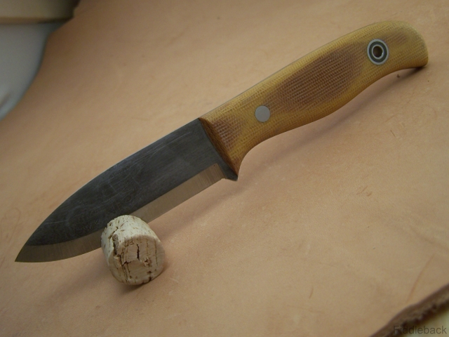

Original Drawing - after all the changes were made:
Original Prototype:
Finished Knife:

Fit and Finish:
The first thing that must be said is that Andy is doing the finest laminates on knives that I have seen. His stock and trade used to be a bilaminate with two hardwoods. Now he has expanded things - this is a trilaminate of G-10, Canvas Micarta, and Osage Orange. He makes these scales himself - and his attention to detail comes out in his scales.
The three colors Andy chose are so well matched and the Osage was just gorgeous. I cannot wait for it to turn a more orange, but am psyched about the color as it is. His finish on these scales are esssentially perfect. No sand lines, no issues, nice and solid. There is a slight glue line around a few of the pins - but this will weather very well as the Osage mellows.
I have handles dozens of Andy's knives (mostly for sheaths) and I have yet to see anything like a gap, or essentially seamless fit from the handles to the blade.
Andy is relatively new to the Scandi grind - but due to a nice jig in his shop - he is making them very consistent. On this knife, the plunge line from right to left was ever so slightly off - but was easily fixed with my 800 grit stone. I wager that these little things are soon to be a thing of the past with Andy care of detail.
The grind itself was VERY flat, very even, and very well done. I keep my stones very flat and hate to work convex grinds out of scandi's. This was no worry here - within no time I had the grind lines taken out and a nice polish.
His small logo looks great in the two spots it is at on this knife.

The Blade and the using of the knife:
I think that Andy's heat treat is right on the money. I sharpened the blade and ended on a 6000 grit stone - went outside and attacked a bit of hard wood that I had. The grind is slightly steeper than my Koster, Bernie Garland, and other scandis. This, I think, is because the blade stock is a little thinner. (3.34 mm v. 4 mm) However, I think this is a proper grind angle. It makes for a VERY robust edge, but also one that slices well. It sizzled though the hard wood, had no issue hogging off meat in the chest lever, and made THIN feather sticks.
In short, it does everything a scandi should do.

Excellent review TF. Yeah, we need to see how the Arete does in the working environment, but I have little doubt about it's abilities based on your write up. You and Andy made an outstanding team on this one. Sweet work!

What a great looking knife! I would hope for more contour to the sides (per TF's original drawing), as the handle's shape looks just like the Koster from the top. I would like to see a comparison shot with a scandi "Bushcrafter" as they appear to look similar. Andy, do you expect to add this to your line?
Feldgrun,
I little more contour might help - but let me say this - I think this knife is every bit as comfortable as the highly contoured knives I have. I think that Andy could take just a smidge off the pinky portion of this knife. However, to make it as contoured as my drawing would make it too small for this knife to be comfortable.
He has named a price on this knife - and as far as I understand the Arete is now part of his lineup. Andy can correct me if wrong.
TF
I may need to buy a new grinding wheel for the KMG to get deeper contouring. I had to back off to leave the swell the requested thickness on this one. If someone wasn't needing an inch plus thick handle, the contouring would be steeper even with the wheel I have.
I am adding this one to my lineup.:thumbup:
