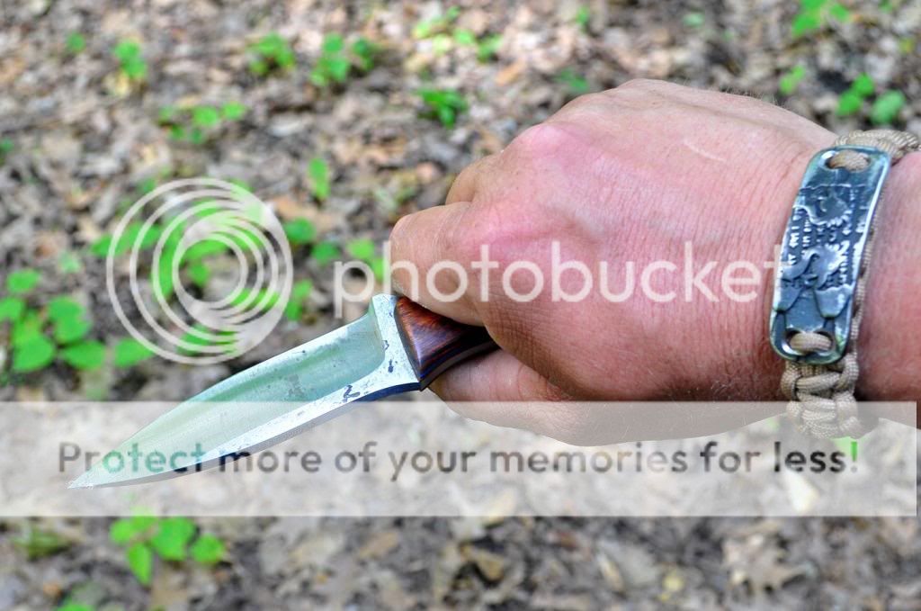

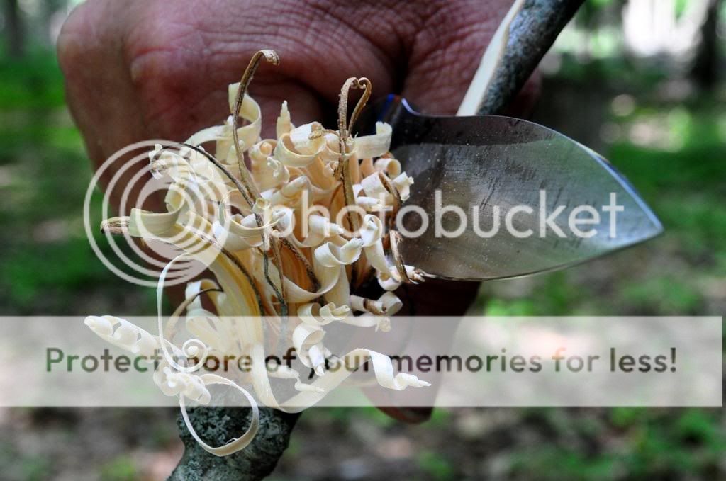

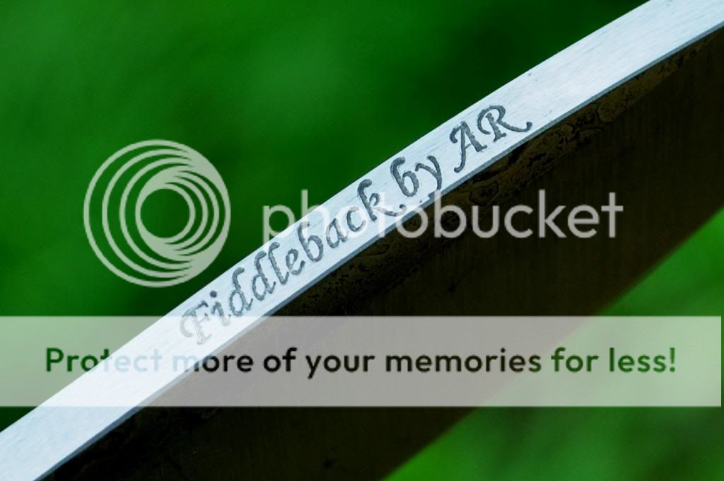

The Friday before the Blade Show in Atlanta, an Asp showed up in the Fiddleback Friday post, one I had been waiting on for some time. Tapered tang, 5/32 O-1, with a high-but-not-full grind, and a beautiful desert ironwood handle. I haven't put it through a lot of use just yet but I have done a little cutting here and there with it, and handled it in use in various grips. I have to say, there is just nothing I don't like about this knife. The handle is not only gorgeous, I love the ergonomics. It fits my hand like it was made for it in every hold I have used it in, and every aspect of the handle profile not only offers very pleasing lines and aesthetics, in my opinion, they also serve a well thought out physical function for me in use. The blade geometry is perfect for me, as I prefer narrower blades on smaller knives, and I like a nice sharp tip on them as well. I have taken a cuple of serieses of photos with it to try to help illustrate my thoughts on the knife.
Some photos of the knife from various angles

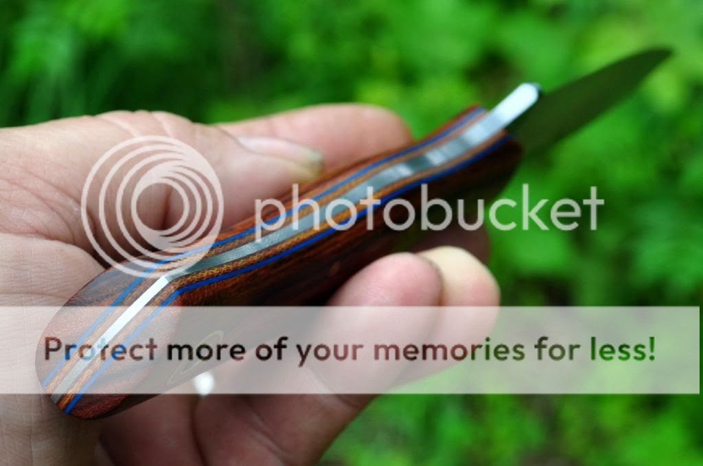

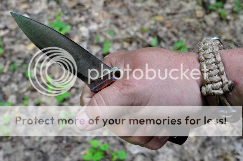

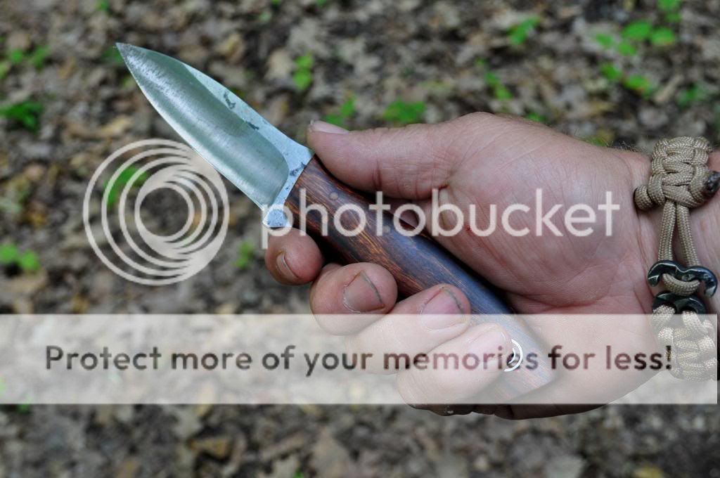

First, I love the palm swell of this handle. It seats perfectly and makes the marriage of the handle to palm very comfortable in use. The integral thumb ramp, or forward upper swell works really well for controlling force and direction in push-cuts, plunges, and boring with my thumb on the handle side of it, and in pull cuts and detailed cutting with my thumb or fore finger on the blade side of it. Also, combined with the integral guard, it provides a swell that anchors the hand well in plunges with a reverse under-hand grip.
I love that the integral guard is big enough to do it's job without being so large as to be obnoxious and take up a lot of space or add unnecessary weight. It is comfortable in a reverse over-hand grip, as well as makes a comfortable for my thumb for better blade control in cutting upward.
I also really like how the contours of the handle feel in a pinch grip, one of the holds I use a lot in fish and game processing, and in food prep.
I really love how the over all shape of the handle contours and oval-ish cross section offer high levels of both comfort and control, and combined with an awesome blade profile make the knife as comfortable in use as it is functional.
