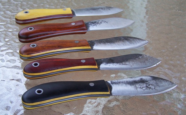

1/4" thick Cocobolo, and 1/8" thick Osage..... sounds like a good combination.
Do you have a pic of this one finished?
The middle Nessmuk is Cocobolo over Osage:
Edited to add that the knife at the top is Osage over Cocobolo.

I don't know how Andy does it but I just use a jig and grind the shape of one side on the flat platen. Then I take the other slab and clamp it to the one that is to shape already and use the first one as a guide. Once the two are exactly the same I finish with hand sanding using the same grits as I plan to finish the rest of the handle with. All still clamped together, finishing with the scotch brite pads. Works well to get the same lines on both sides. I have not done any rounded however, so that might present a whole new challenge.
