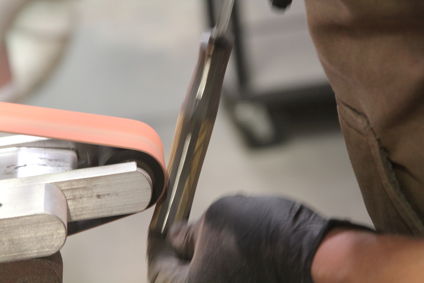

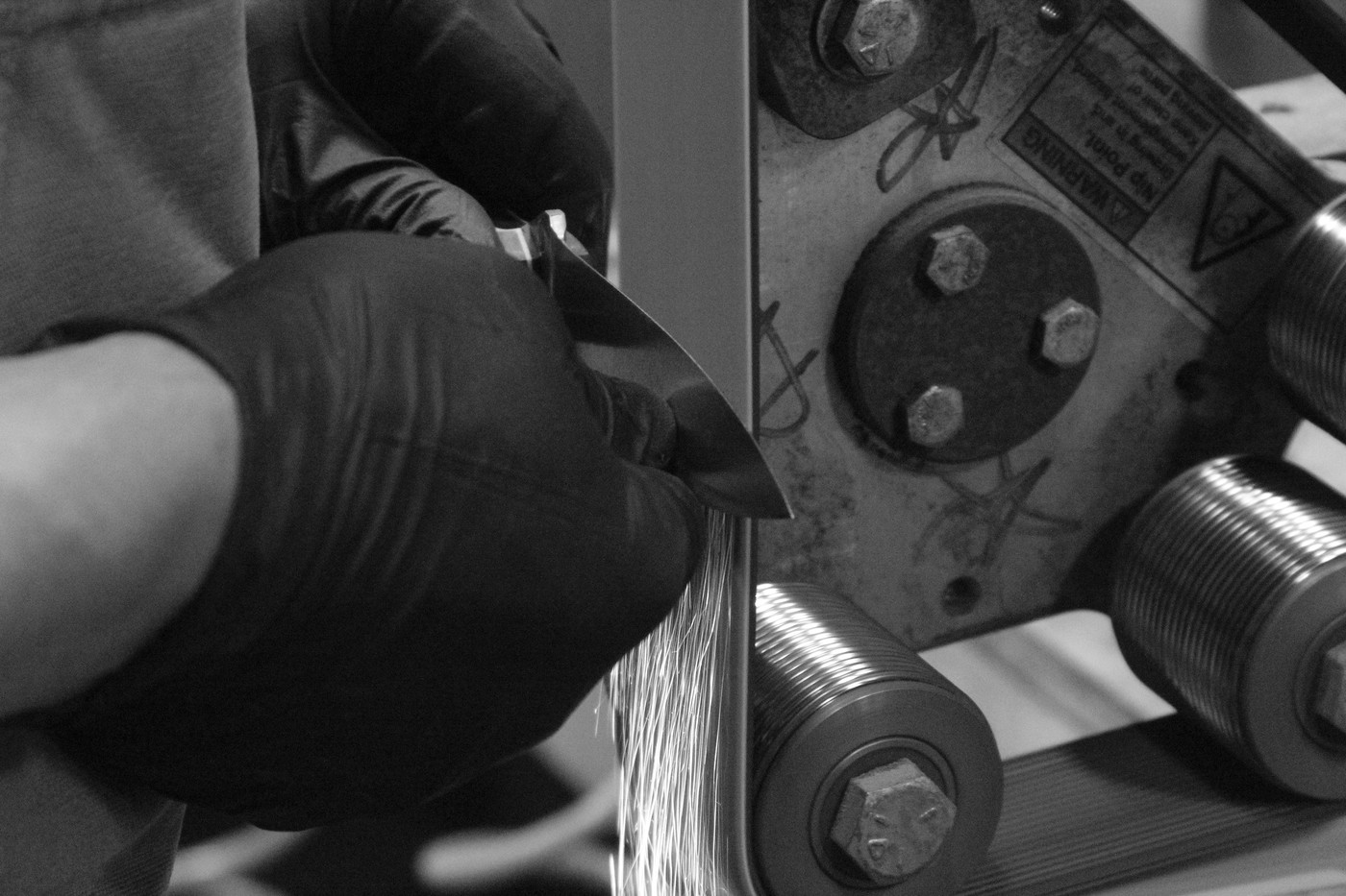

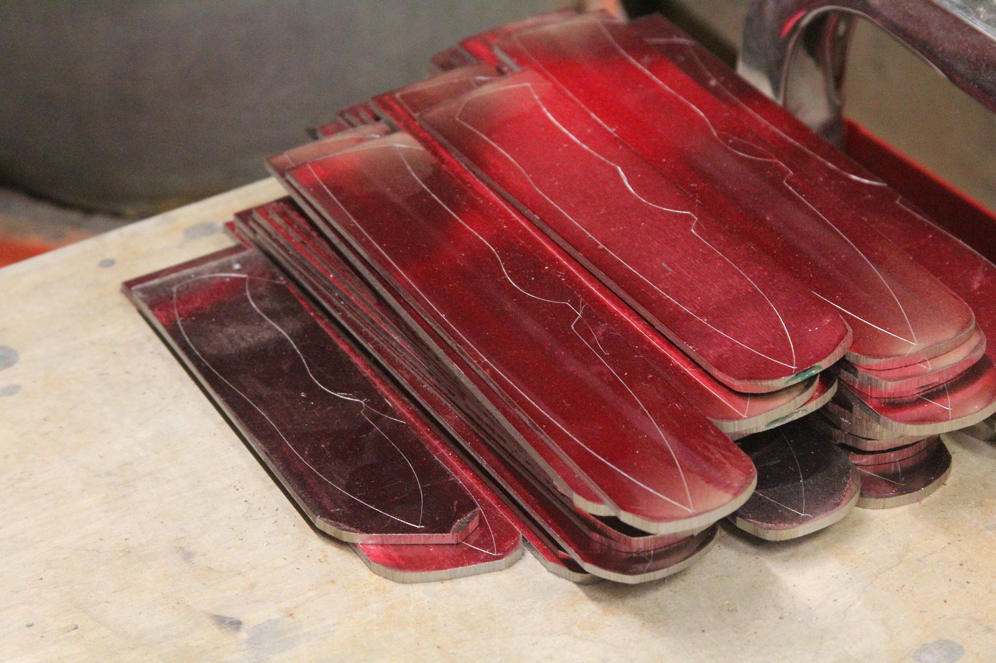

If you search the Fiddleback forum for "behind the scenes" you'll see lots of shop pictures and can probably find examples of all these steps. The process is roughly.
- Draw out knife profile on steel
- Grind out the profile.
- Drill Handle holes
- Rough Grind blade edge
- Heat Treat
- Attach Handle
- final Grind of blade
- Handle rough Shape
- Handle hand sand
- Mail.

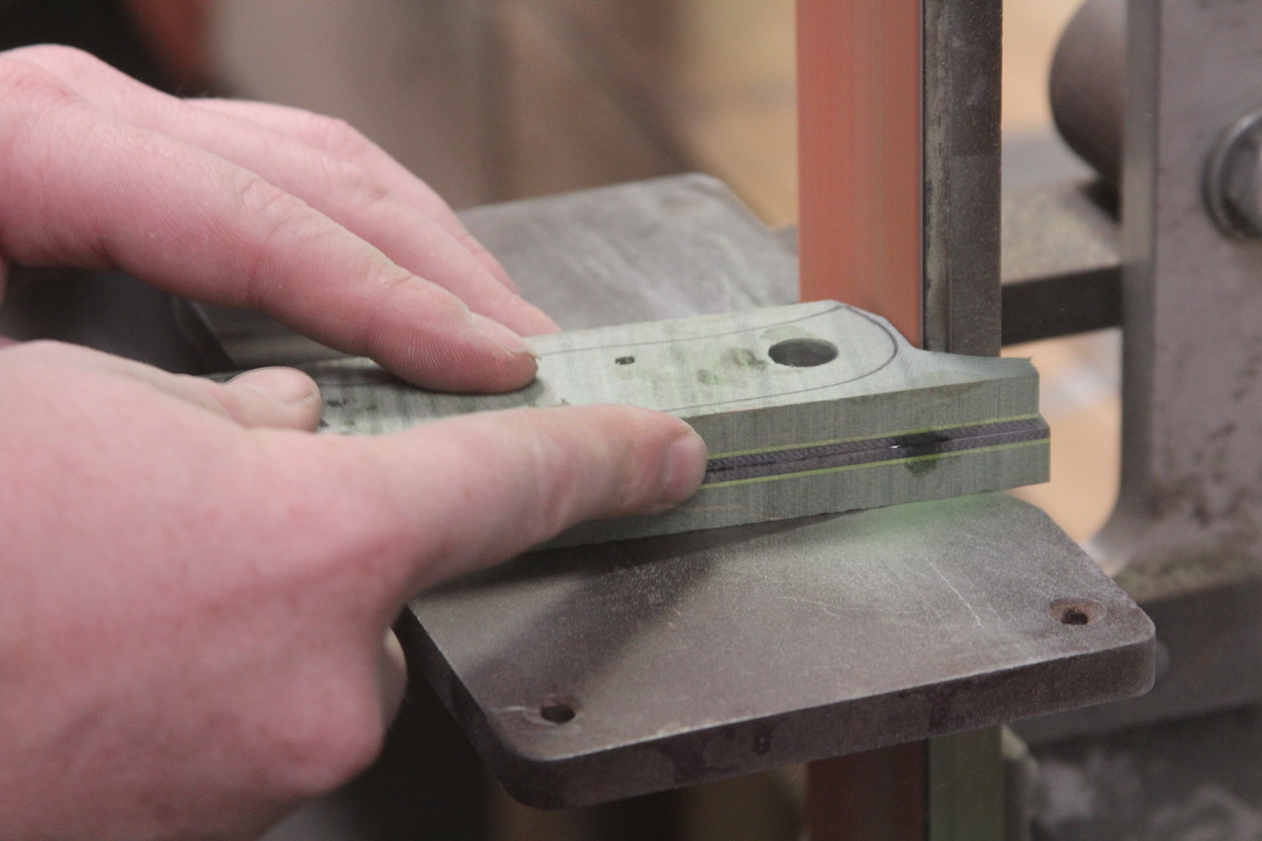

The handle sales get a process of:
Select material and backing
Epoxy into two blanks
Epoxy to blade with pins and tubes.

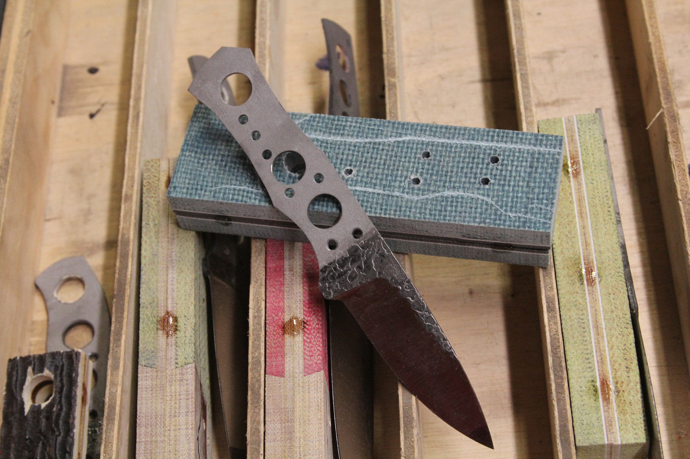

cliff notes version of the link in posted..

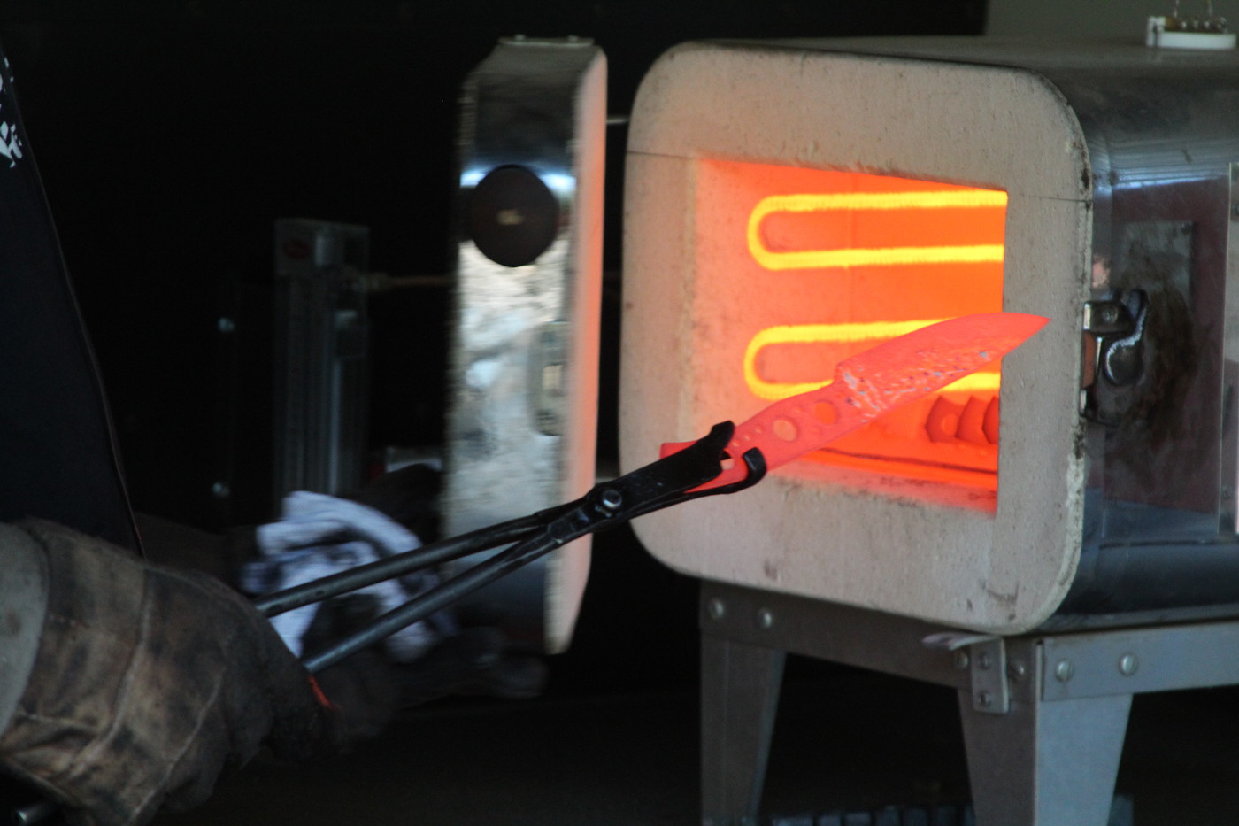

scribe pattern on steel
grind to the "line" the scribe produced
drill holes for pins & Bullseye
pre heat treat grinds
heat treat

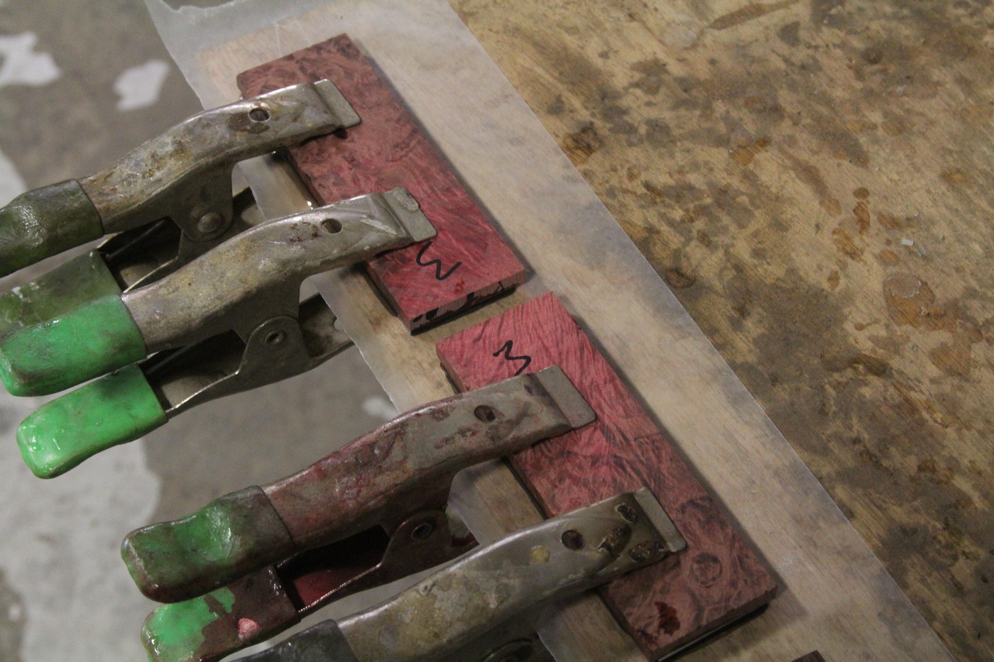

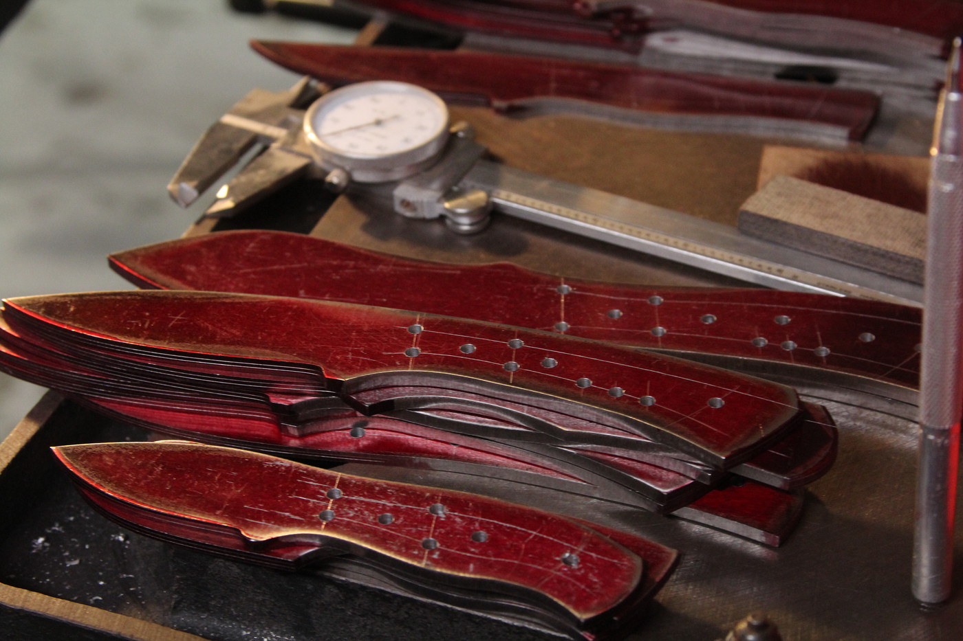

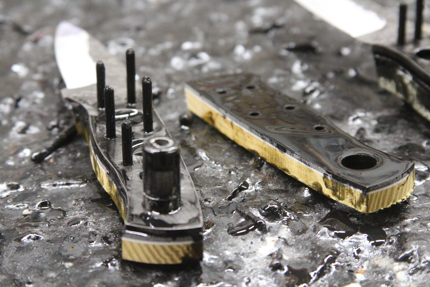

laminate scales to liners & pinstripes
match knife to scales & drill the holes
remove excess scale material

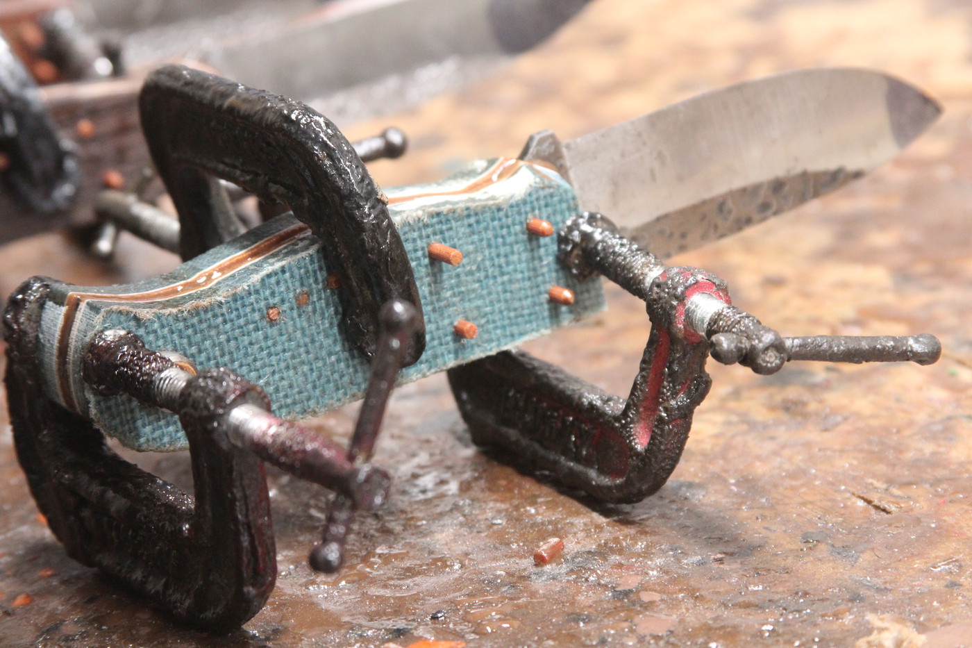

glue scales on
clamp scales over night

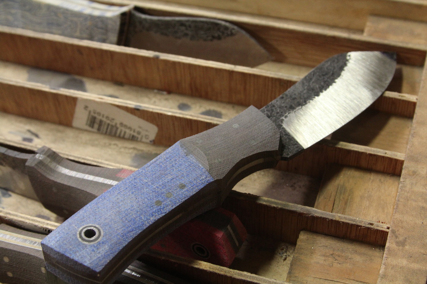

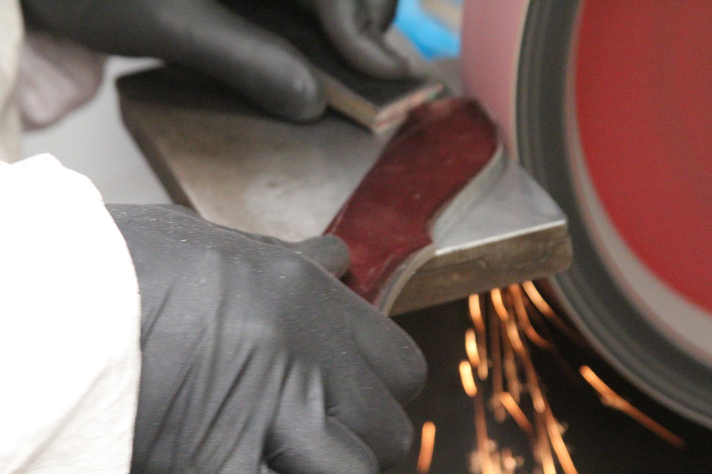

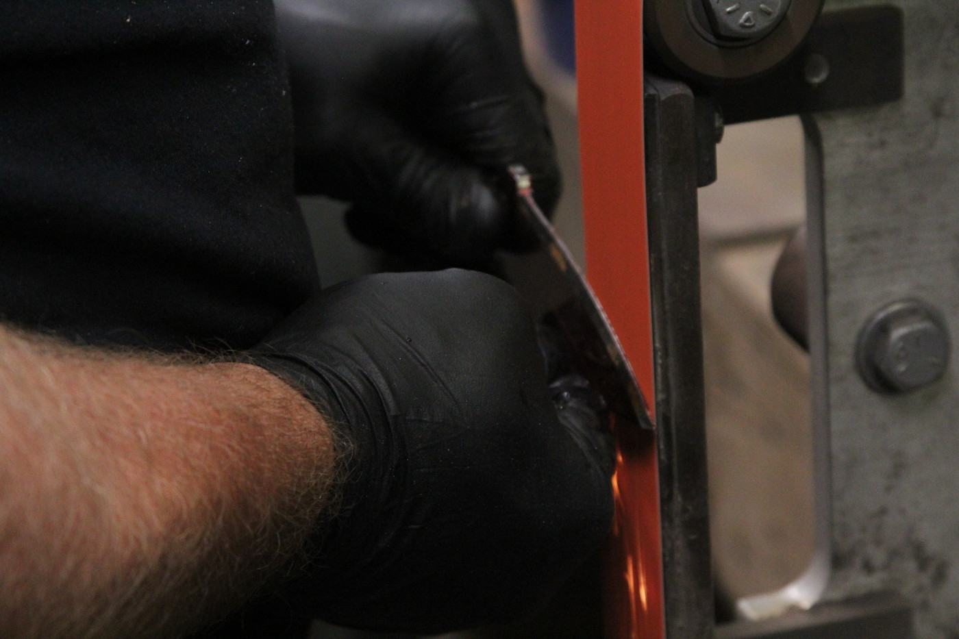

shape scales
here is where we hand sand the handle. i have no pics because I cant do both at the same time:D
Andy will put the finish grinds on
With any luck, you will see one you want like this on a Friday
Hope that helps

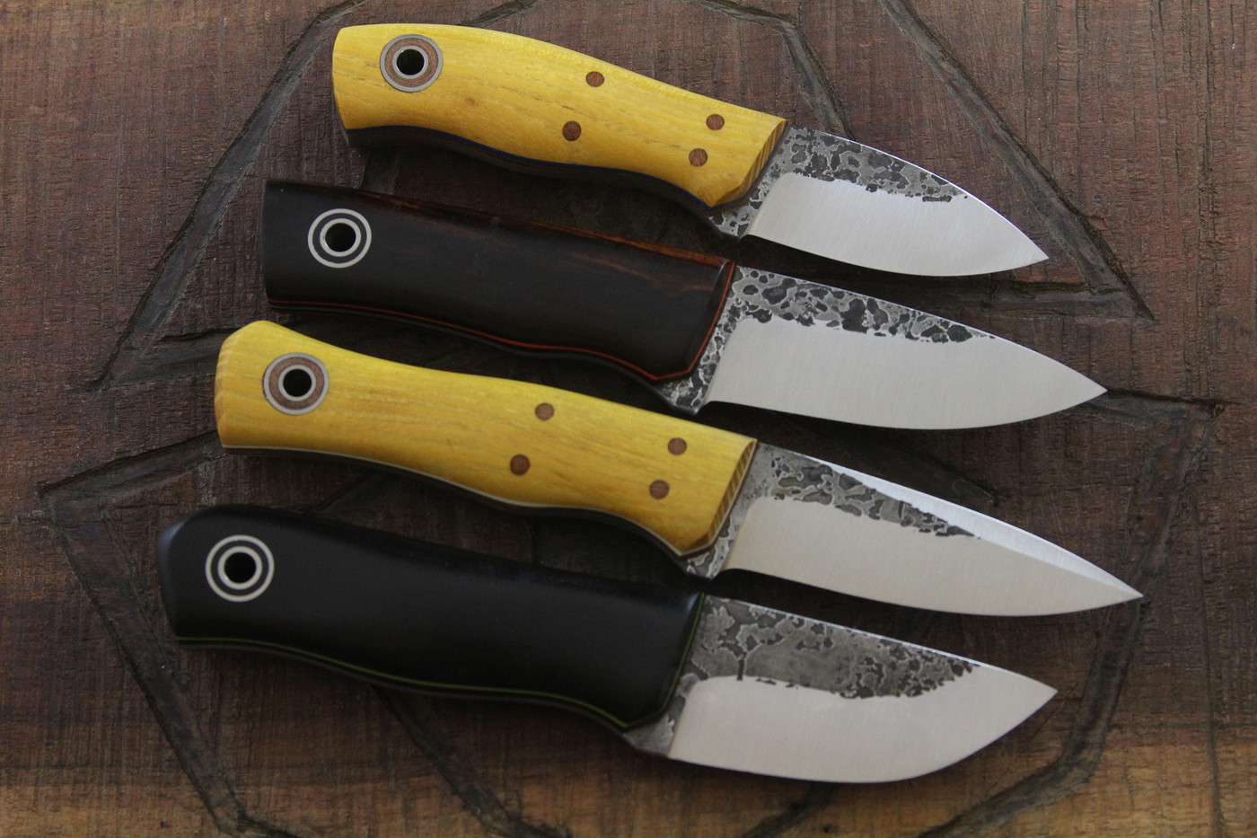

Hey Justin, you're exactly right! To have a little fun here, let's take a look at different angles comparing 3 Bushfingers.
Where you'll see definite consistency is in the profile silhouette. Take away the silhouette aspect and the blade could be convex grind or scandi grind. Within convex grinds, it could be a super high grind, lower grind or somewhere between.
Scale material aside, take a moment to pick which handle you think you might like best.
After you made a selection, scroll down.
Surprise!
Among the three, one is 3/32", one is 1/8" and one is 5/32". Can you guess steel widths from this angle?
Or this angle? Note in these two butt-end shots how much different they appear from each other vs when you saw them in the first picture.
Continue scrolling down to see the steel thicknesses.
And here are your spine shots, steel widths and additional differences in handle contours.
The top one is 5/32" TT
The middle one is 1/8" TT
And the bottom one ends up with the widest / most roundish handle along with 3/32" SFT.
At this point, there is no good or bad, right or wrong .. there is only user preference to decide which each person likes best. A wider handle and wider blade stock is likely going to be more comfy for extended use, especially with bushcrafting. I happen to prefer the middle knife handle the best because the handle is narrower and has a nice pinch grip with a little flare up front. The 1/8" TT and 5/32" TT have pretty similar measurements at the pinch grip but the 5/32" TT doesn't flare as much up front. To someone else, the 1/8" TT specimen might be their least favorite. Taken further, some folks absolutely love full tang, some absolutely love tapered tang and some might not even notice if there's a taper or not.
So yes! Buy a few (or as Danny said) 5 of each :D

Outstanding post. Thank you Sir. I will be honest, that is more variation than I expected!
Thanks and no problem. Please note that I've had a good number of duplicates across a good number of models and they usually don't vary that much. That was the most variation I've seen so thought I ought to take pics while I had them. The main point was that the starting template/blank is the same and then since they're hand made, they can vary. Also if you get a first of a model and it doesn't agree with your hands, try not to dismiss that model because you could very well get another and have it end up being your most favorite.
Hmmmm. This is a good point. The primary method I'm using to determine suitability is my preferred blade profile, and the in hand feel. Though I suspect I wouldn't remove one from the possible pool for being too thin or thick based on this information.
In general are there any predictable trends, like wood is generally narrow, micarta is thicker?
Not that I know of. You could also get something commando with no liners or stripes or there could be thicker liners/stripes. It's like a box of chocolates :D

when Allen cuts the raw material on the table saw, he has a exact thickness that he cuts them to. the rest is on how Andy shapes them.
