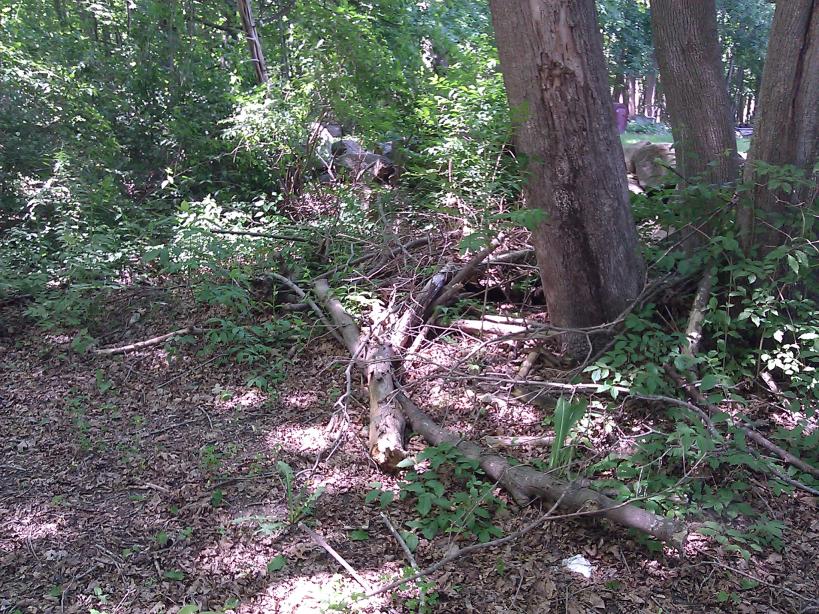

Hmm, must be something to cut on in here...

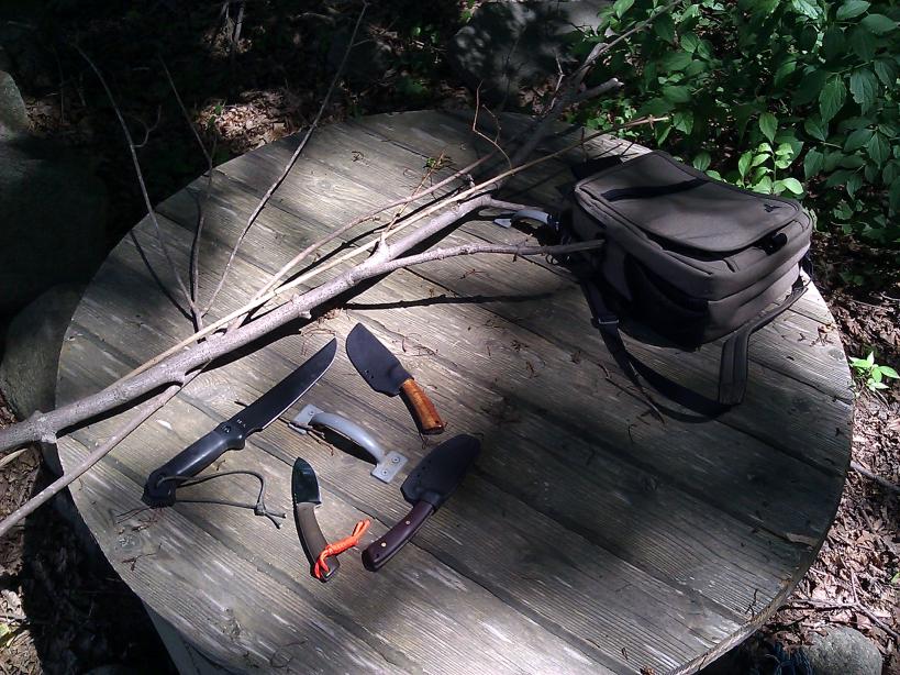

And a place to sit - how about the shallow well cover? Ok.
Note: this 'safari' takes place about 80ft from the back door. Not terribly adventurous.
And the primary culprits are pictured.

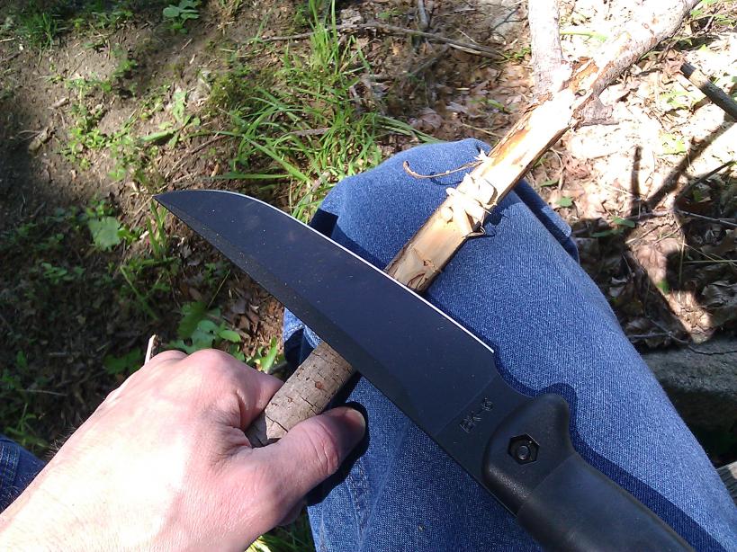

First: The mighty BK-5
It sure swipes well, but I've gotta say that the trailing point makes me nervous when winding up for a swing.
The 5 cleared small twigs well, but is a little unwieldy for fine work until you use the choil. Then it improves. However the edge isn't super fine (cuts paper smoothly), and the swedge at the spine makes it a bit uncomfortable to use the off hand thumb for control. Yep, makes sense to pair this with a smaller knife. BTW, I'm NOT cutting ON my leg. I've only got so many hands and had to work the cameraphone.

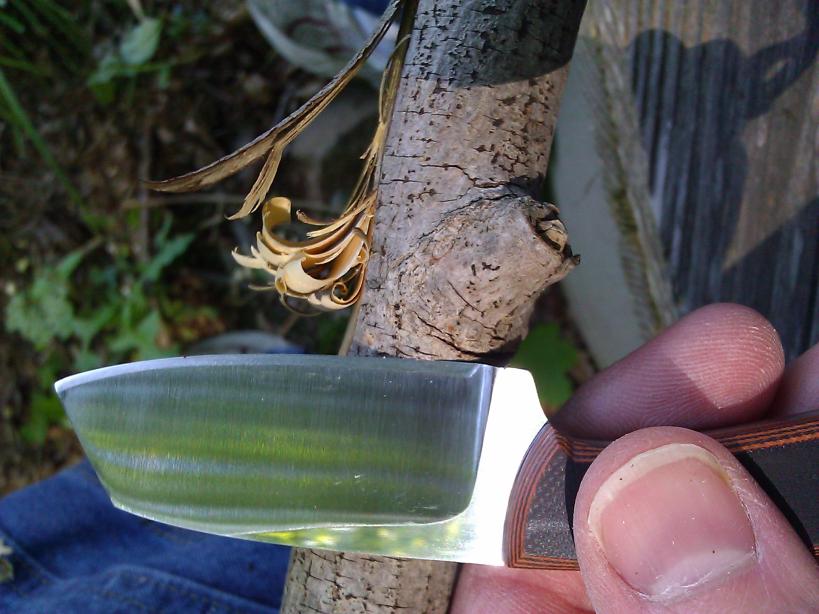

This is my 100% scale 3" hunting knife in 1/8" O1 that rides on my pack currently. Super comfortable, but the grind is a bit low - rookie mistake from a year ago. However control is pretty good, and it's the perfect size. Shoulda taken a pic of the stick rotated 90deg. It was a little awkward under that offshoot branch. Let's not make that mistake again. When I make a new version of this knife (and I have, my friend has it) I'll bring the grind way up and also thinner at the pre-edge. This will soldier on as my mini-survival blade.

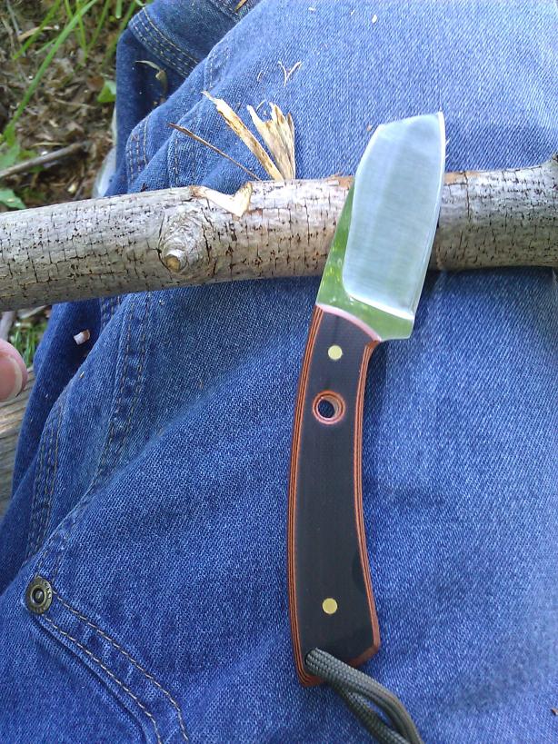

Next up: my 115% 'Through Hiker'. This is a bigger blade in 1/8" A2 with a proper high grind. The slimmer profile really makes a difference for fine work. I really nailed this one, but never carry it as its too long for my state. So many knives are so overly thick for fine work! This one also has good control, and the handle design lets you get right up there. The height of the handle should be a touch greater, tho - this one was slimmed as an experiment, and I prefer the original pattern.

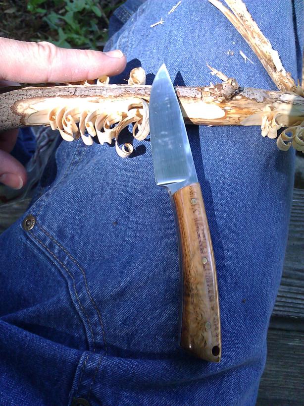

Here's my 85% Hiker EDC in 1084 that's on my belt most days. The handle is a bit small for this work, but it's not a woods blade. It clears bark and curls like nobody's business because despite it's over-1/8" thickness and small blade, the primary bevel was ground very thin at the edge. The secondary bevel is hardly visible. Not a woods profile, but man does it cut long and deep.
