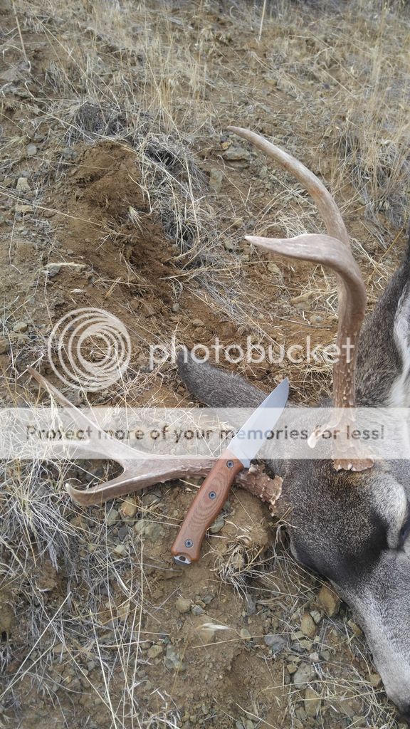

Well, we had a very successful deer hunt, guess I made up for my rough elk hunt. I did not have a chance for pics, sorry. But I wanted to give my opinion of the edge retention. I was able to skin out 3 of the 4 buck we got, these are big New Mexico mule deer. I was very amazed at how well this knife did, I only touched it up at the very end of my last buck, and I'm sure I didn't need to, just needed to get into a tough to reach place and needed it really sharp. Over all the knife felt great, and did very well. I'm very pleased with the edge retention of nates heat treated 3v. Very impressive. After all that I was able to cut up all the rest of the meat today, debone everything, with out re sharpening the knife. We had several other knives on the table, benchmade s30v, esee 1095, zt s35vn, zt vanadis 4e, and busse infi. Overall this field knife held out the longest with having to resharpen.

On the FK: D3V tested 62 HRC, .188” thick at ricasso. 0.015" before sharpening, 15 DPS.

Thanks fellas. I'm guessing we're going to see some pictures of a bigger animal if rodriguez7 figures the picture thing out. This was a very slick and healthy buck though, and it was an incidental chance that happened while taking out a young hunter for his first buck, so I was glad to take him. We found a young forkedhorn bedded down, and my friend's son took it. This buck was with it, but we hadn't found it in the thicker sage. If there's one blade of grass on the hill, I think they could find a way to hide behind it.
