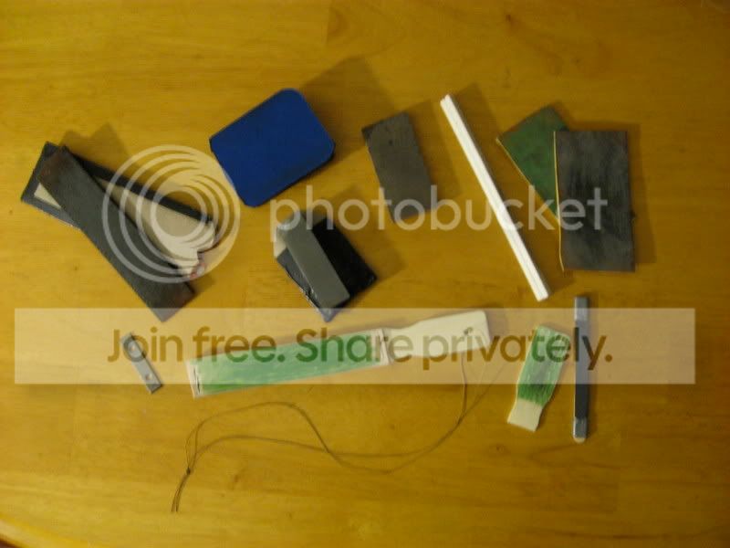

thought i would toss together a post on field sharpening gear, since it is somewhat important for us knife knuts...;)
here is a collection of things that i would call "field sharpeners";
we have all manner of things in different grit leves;
strops in different grits
sandpaper apparatuses
stones
ceramic dealie
carbide blade

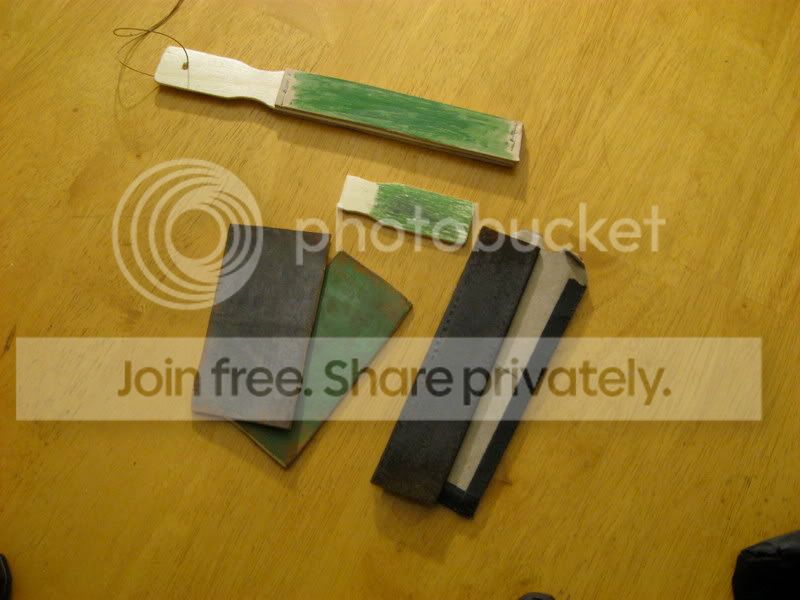

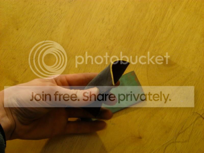

the strops are all pretty self explanatory. you load them with compound and strop your blade on it.

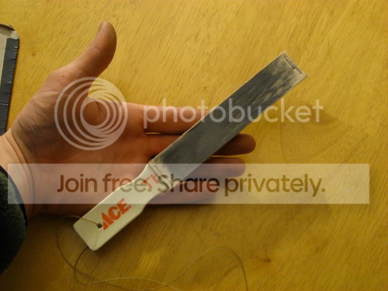

but, i was playing around with minimal size strops, for packing, and came up with the fairly common short double sided strop...
the end of a painstick simply loaded with compound. works best on small blades, but with patience you could use it on bigger things. also takes more precision because it is rather firm...

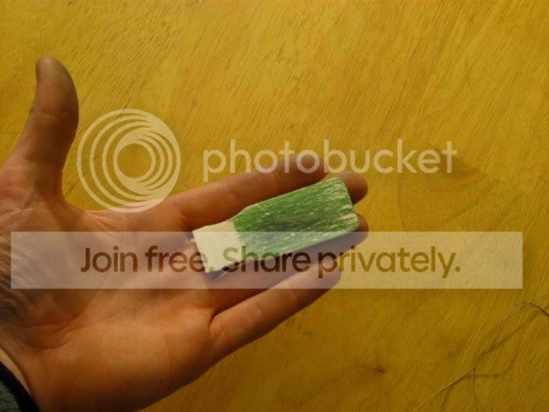

pieces of leather loaded with compound. these are good to carry if you are carrying something like a gouge, heavily recurved blades, or hook knives. you can simply pinch the sides together to form a curve for you to strop on...
i carry this piece of belt (was my second ever leather strop) in a cardboard slip to keep compound out of my pack.

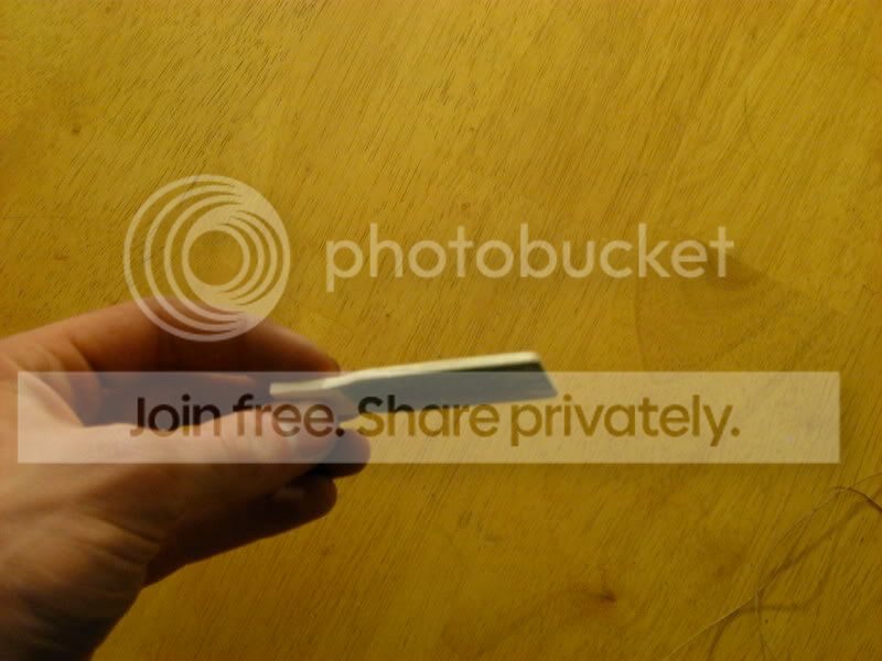

next up we have the sandpaper type of setups. these are what i consider intermediate level sharpeners. this crosses over with the coarse stropping compound. these actually sharpen (vs maintain an edge in good shape) so are better for longer term situations where you are more likely to need to actually sharpen.
as simple as sandpaper duct taped to a popsicle stick;

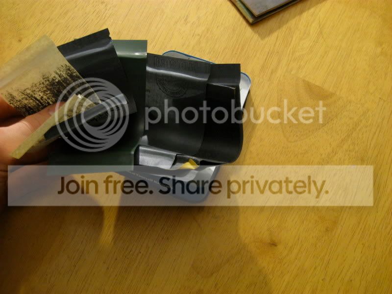

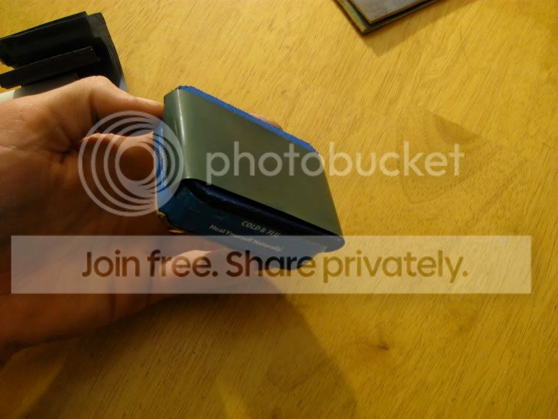

or as complicated as a the altoids tin sharpener which i've shown around before (credit to rescueriley for the awesome idea);
the great thing about the tin sharpener is that you can carry any grit you want, and a whole lot of it. i carry several sheets each of 400, 800, 1200, and a sheet or two of 0.5 micron film (the same grit as my strops) for a full range of sharpening capability. you could even equip this with coarser paper to take care of more heavily damaged edges.

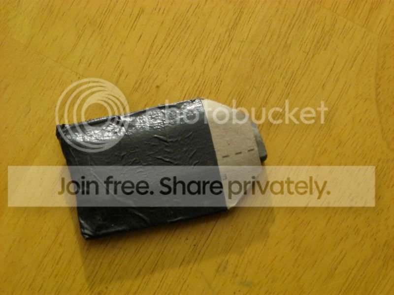

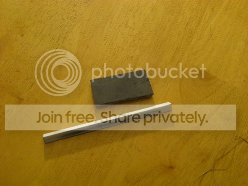

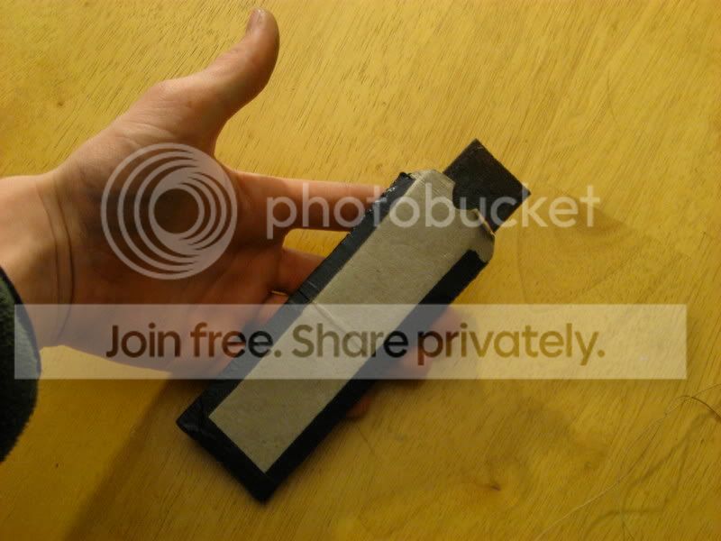

a basic "pocket stone" from the hardware store. a good small stone that can do white alot if you can work it right (carried in a cardboard slip to protect my bag and the stone)...
an ultrafine sharpmaker rod (courtesy of theonew) and a soft arkansas stone. both are fine grit, very roughly equal to my green rouge strop i would guess;

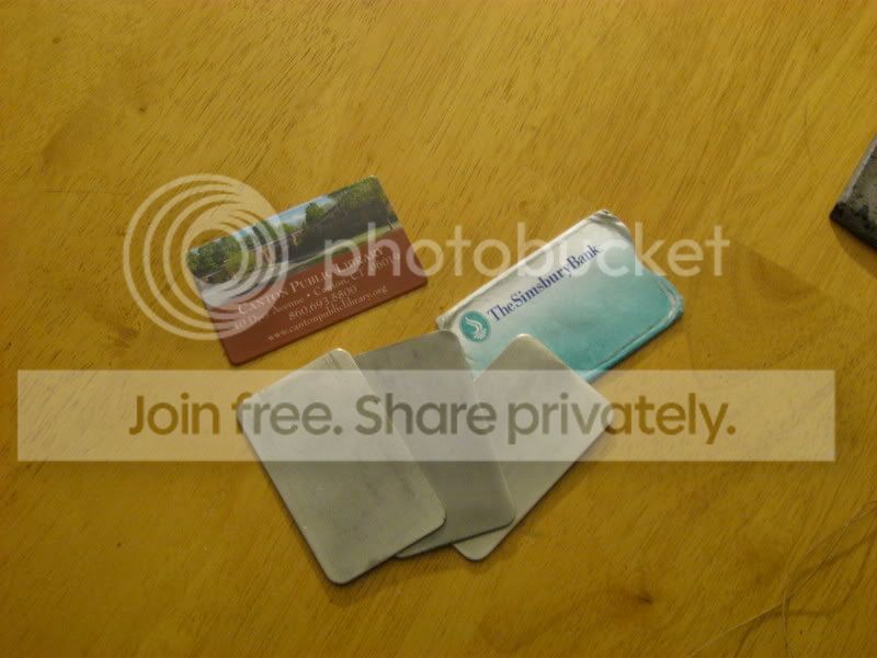

credit card diamond plates. i carry these in a tyvex sleeve that debit cards come in, it protects the stones and keeps them together. i have from 325 grit to 1200 grit, so it covers a pretty wide range. these are a bit heavy though, since they are on steel plates. they are also a bit tricky to use safely, because whever you hold them you will have part of your finger above the surface, and it could potentially get cut.

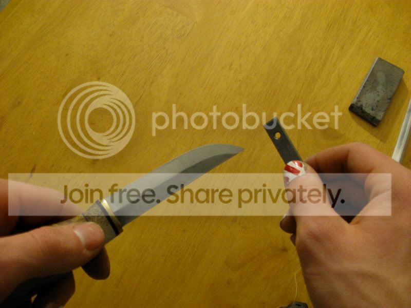

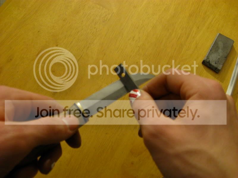

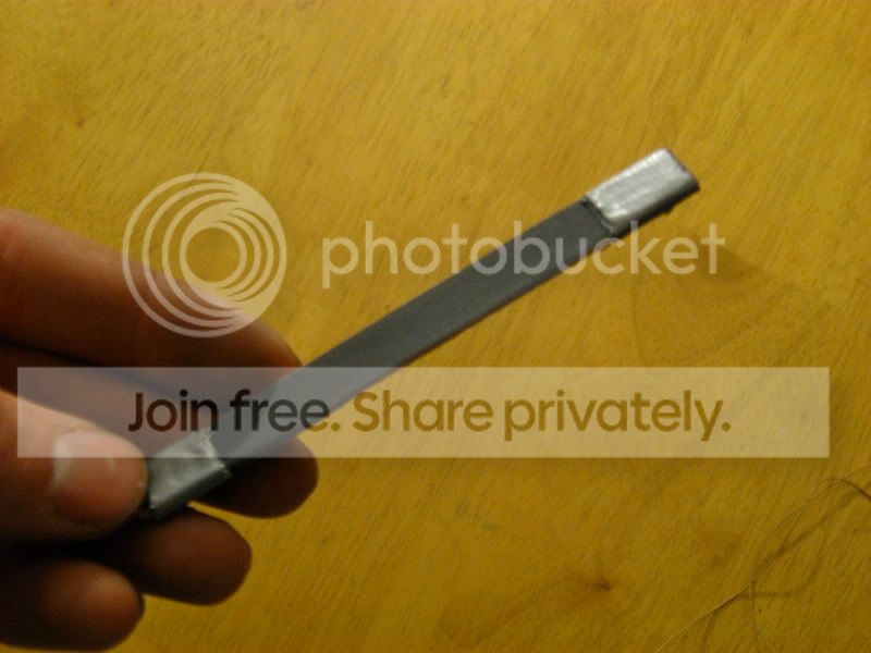

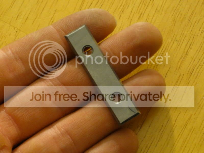

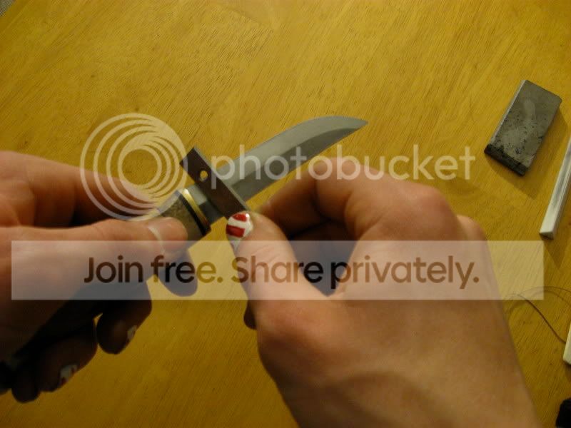

something i have been experimenting with for the last day or two. a carbide scraper blade (this little 2" one was $9 :eek: the 2.5" one was $15 :eek::eek:). you just grab the scraper and drag it along a dull edge to remove metal, maintaining your sharpening angle. this would be for heavily damaged edge, where you slipped and drove your knife into a gravel pit or the like...but it is small and light and i think worth carrying. the one that i have is ground at 45 degrees, and the edge chipped with i hit a nick in my blade. i dressed the edge back and put on a 90 degree bevel at the edge of the initial grind. so far it seems to be holding up better. the corona machete sharpener does the same thing, but gives you a handle to hold onto (and the edges are already much closer to 90 degrees)
you start at the heel of the blade;
and slide the scraper toward the tip;
