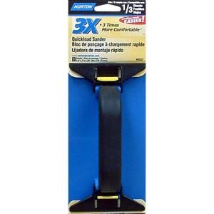

I just picked this up today, I will get back to you an how well it performs. It has a foam cushion that is a little stiffer than a mousepad.

Quick update:
I just used that sander today and I have to say, for being a broke kid, this is one of the best investments I have made for sharpening in a while. I just put a hair-popping edge on my BK14 in just a few minutes. I'm taking this in my pack from now on!!
