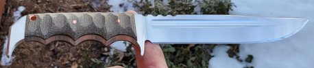

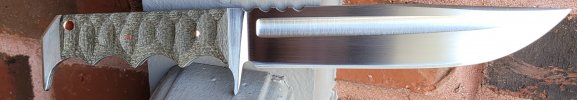

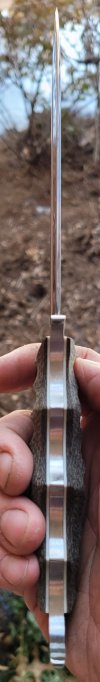

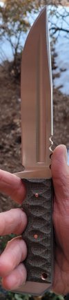

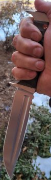

Good Afternoon,
This blade is made from 0.200" Magnacut. Blade flats are hand sanded to a satin 600 and the clip, handle flats and fullers are finished on an ultra fine scoth brite belt for a nice contrasting finish. Kydex sheath with holes spaced for a Tek-Lok is included.
The weight on this one came out at 9.1 ounces and it is well balanced right in front of the guard. As a reference the standard kbar is 11.2 ounces.
Price SOLD , shipping is included to continental United States via USPS. Preferred payment is via paypal.
Blade Steel: 0.200" Magnacut
Grind: Full Flat
Blade: 7"
Cutting Edge without sharpening choil: 6 3/4"
Handle Material: Green Burlap Micarta with a with liner and copper hardware.
Overall Length: 11 7/8"
Sheath: Kydex with holes for a tek-lok
Weight 9.1 ounces

Hi Paul
Just a thought -
Maybe have the sheath come right up to the guard, or partially (or fully) enclose the guard so that it cant get caught on something accidentally?
Keep up the good work.
(cant wait until I can get mine from you)
