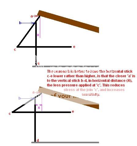

For you experienced trap makers -
Does it matter if the horizontal trigger stick is positioned nearer to the top or closer to the bottom of the vertical stick?
Thanks for the help.
sp
I tend to keep it a lil closer to the bottom. I feel it is a bit more secure like that.

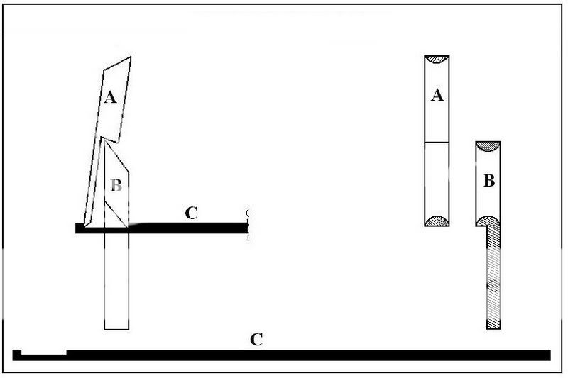

Try this. It's a quickee drawing so I hope it makes sense.
Diagram is incorrect - see below.

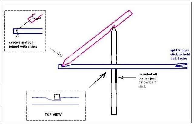

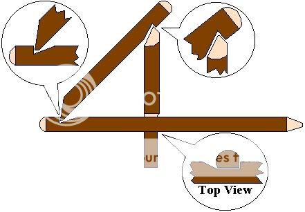

Try this for an explanatory diagram. I don't know where I got it, but it pretty well sums it up.
Or this one, disregard the horizontal stick position as discussed above.
Tony, thanks for the offer. Let's see what happens as the thread goes on. I want to learn how to cut the notches and everything, so I may ask for a model if your offer stands.
ON EDIT: I was typing while you posted the second diagram, Doc. That helps alot!

OK, I think I have it.
Of course, you could always lengthen b-c to offset the increase in pressure and stress, but that would make it harder for the support stick a-c to stay in place in the notch in the horizontal stick.
Whew!! If anybody sees a problem with this explanation, please speak up.
Doc
I like it lower because it allows me to increase the lever arm without having it stick out further from the support arm. The longer the lever arm, the further the end is from the fulcrum, the more weight it can support. You can increase the lever arm by using a longer trigger arm, but then the joint of your 4 sticks out a good ways.
