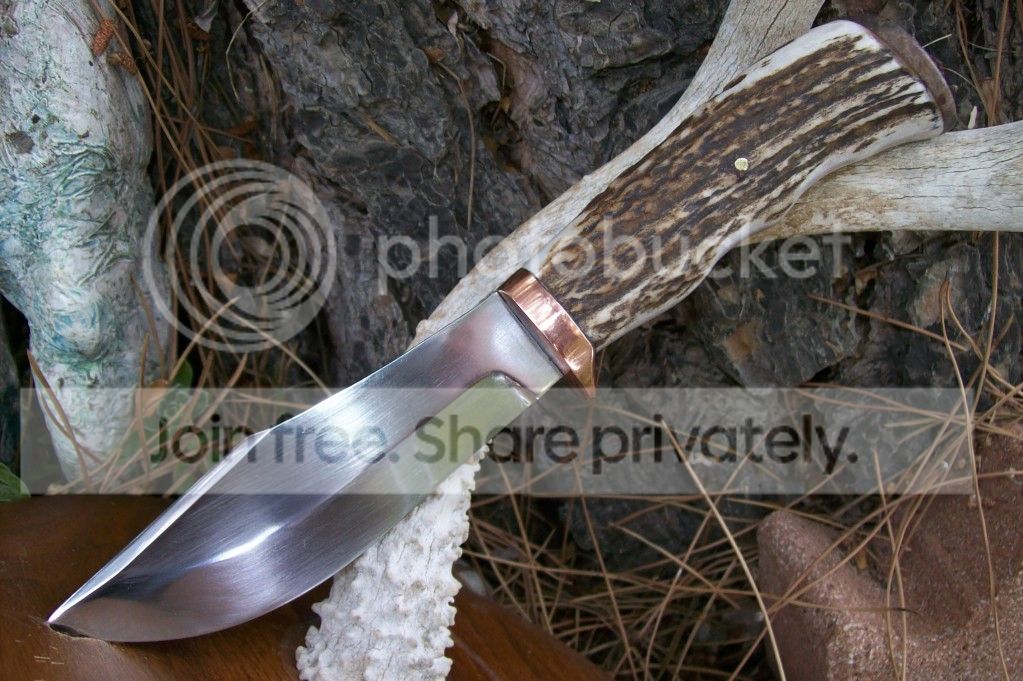

Figured out a couple of things.
Aug 21, 2012
231
One is take your pictures outside.....much easier to get a decent shot.
Two is if you forget to drill a tang hole before HT, its much easier to make a little notch for the pin.
440c, about 10 inches, handle is elk. Any comments always needed.

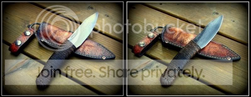

Right on. Overcast days are the best... if not, try sticking to shade. Also try using a black background to reflect off the blade. The first photo is reflecting the overcast sky back at the lens. It white-washes out any attributes (hamon, etching, etc) and changes the whole exposure of the picture. Notice how the brown in the handle is more "brown" in the second pic. All I did was have my wife hold a black sweater such that the lens catches the reflection of it rather than the sky/light.
